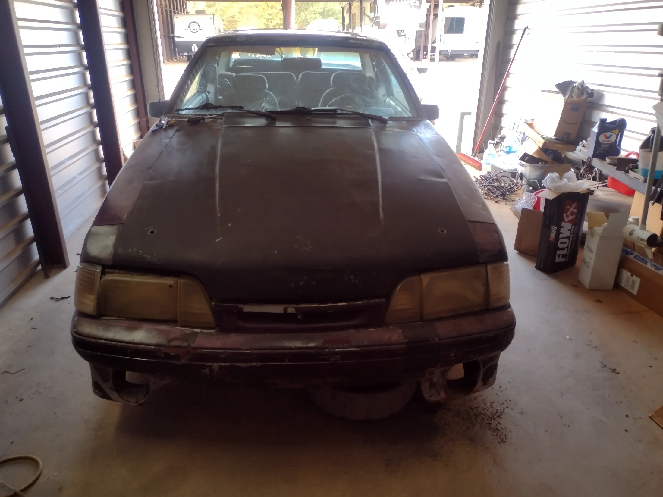

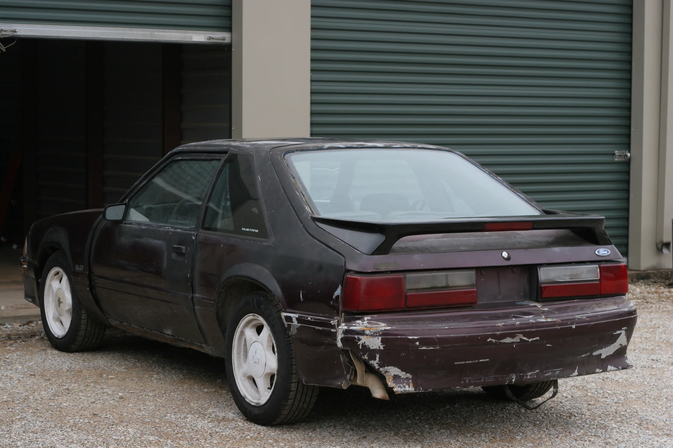

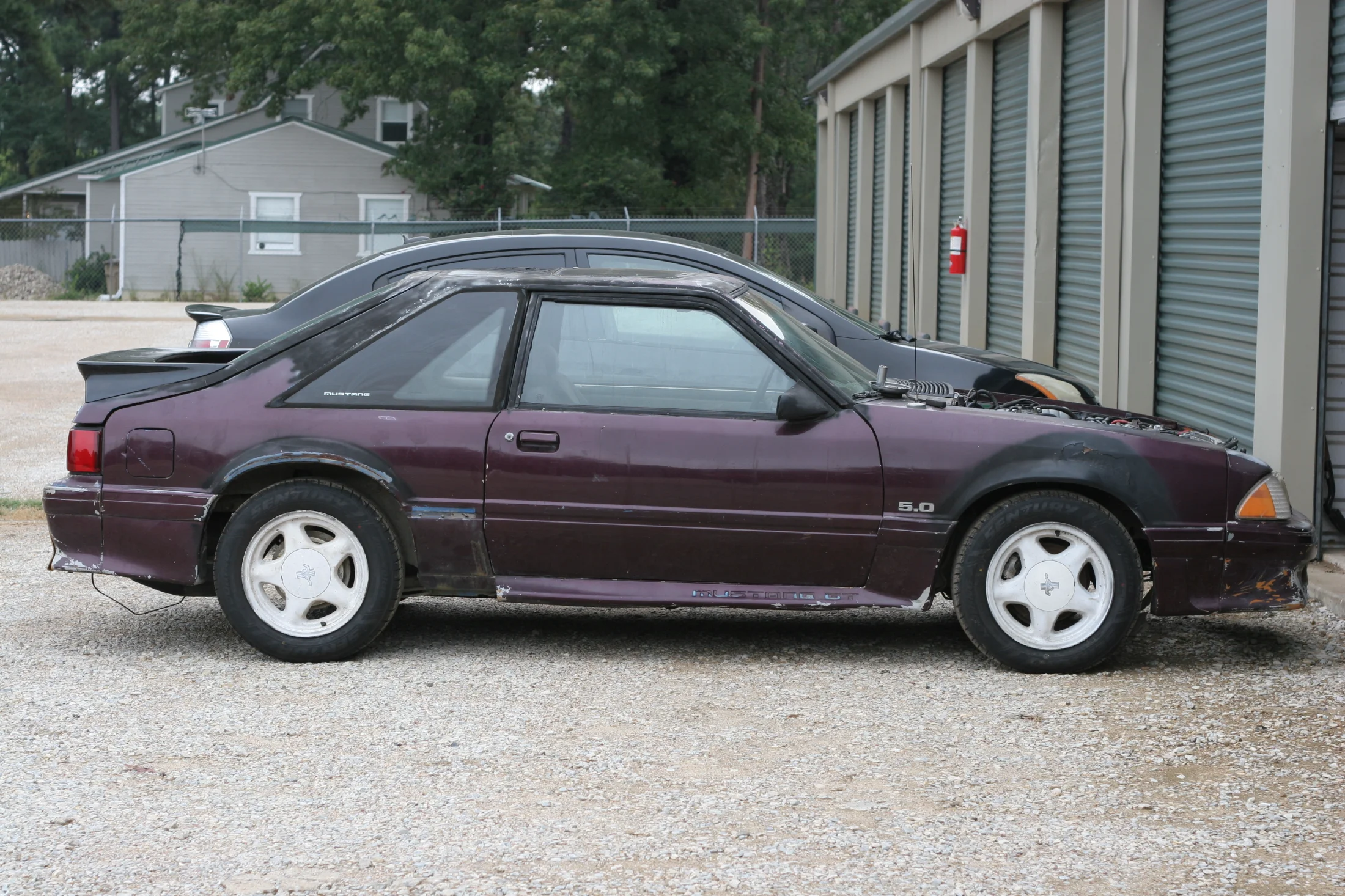

Backed her out today so I could sweep the floor. While she was out I took some pictures. It was overcast this morning and had been raining.
Pictures taken with a Canon EOS 20D, iso 200, shutter ay 250 and pasture f8. 50mm lens.
The hood is off again since my hinges are broken.

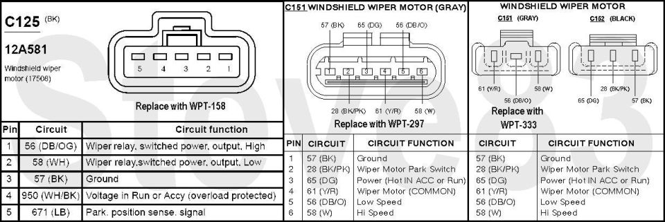

I had forgotten that the i had done the single plug wiper motor conversion on my truck. It's a better motor and less problems the two plug harness connectors which were prone to burning up and causing fires.
Mine are in poor shape .
This TSB applies to mustangs as well as trucks.

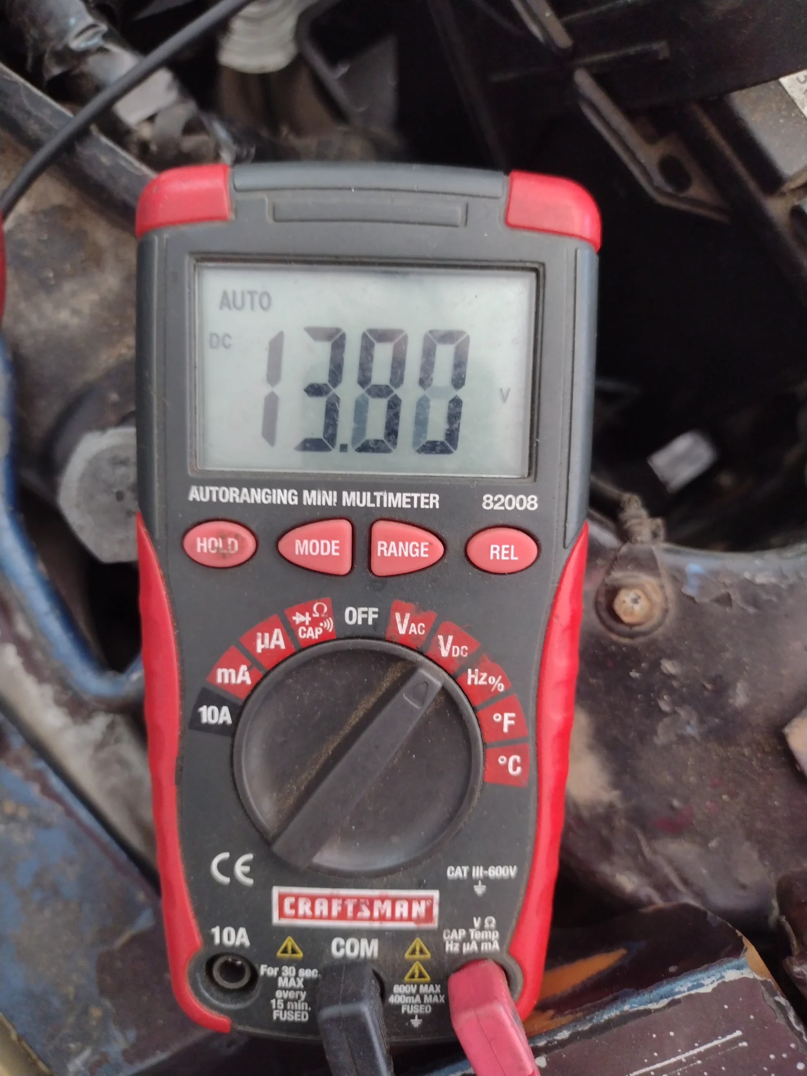

They seemed dim so i found the voltage at the lights was less than 12v with the engine running. There's lots of write ups on FullSizeBronco.com
Installing relays is what will correct this issue and give you full power to your lights.

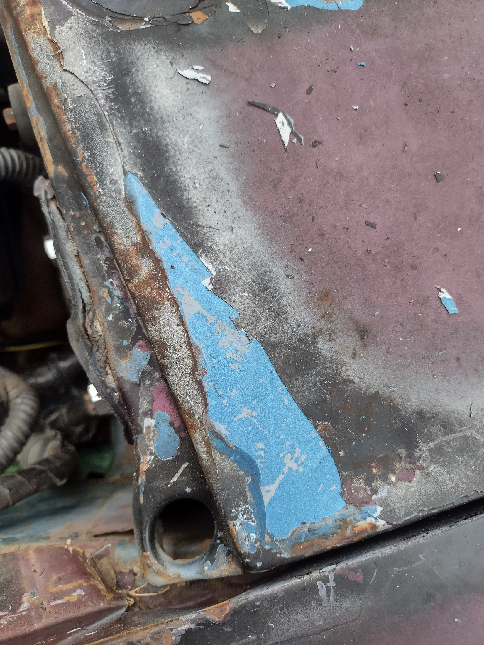

The purple paint is peeling in a lot of areas.
On the cowl i found some loose so i took a razor blade to it revealing to original paint, bright regatta blue.

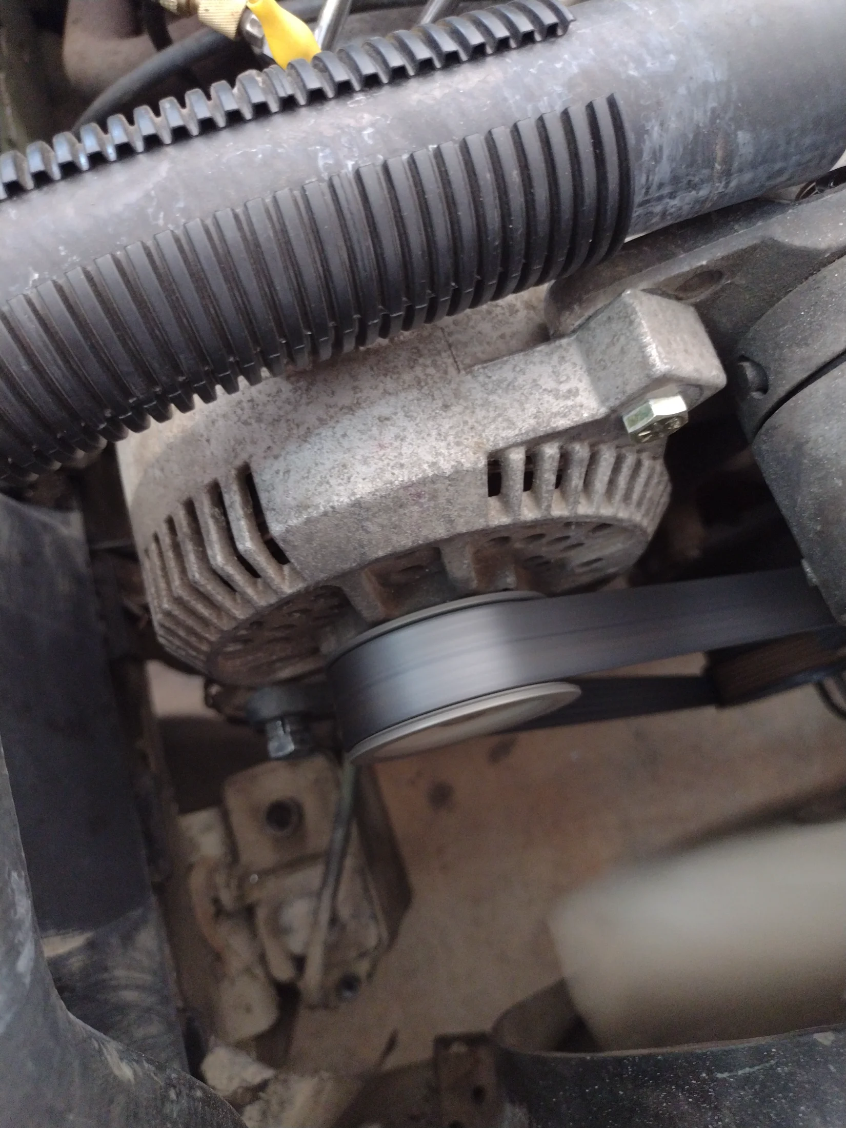

Got to put the 3g on and take apart the wiper motor to see if i can get it working.

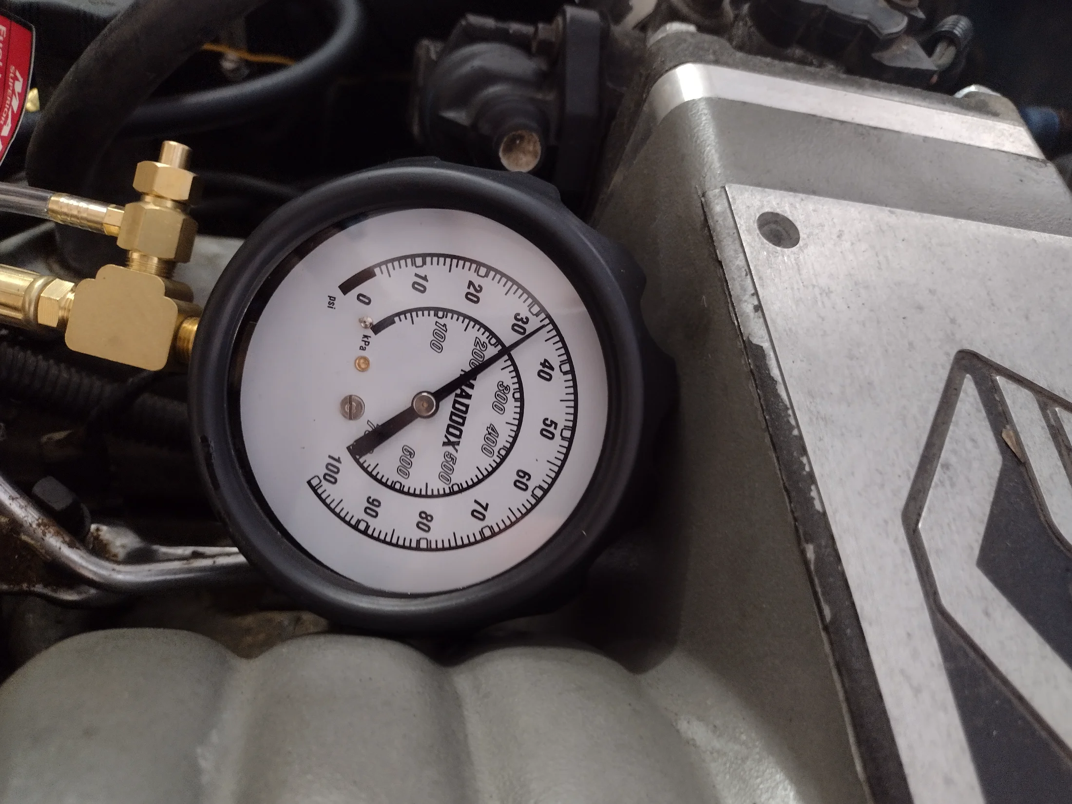

Might be the rubber hose between the pump and the hanger?
I have thought about that. I've seen those crack and you get pressure bleeding off and low volume.
Around 33-34 at idle, off idle 36, goose it and i get 41. It's 37 when cranking. I haven't tested under load. Pressure is only half of it. You also have to have volume.
I'm going to do more tests.

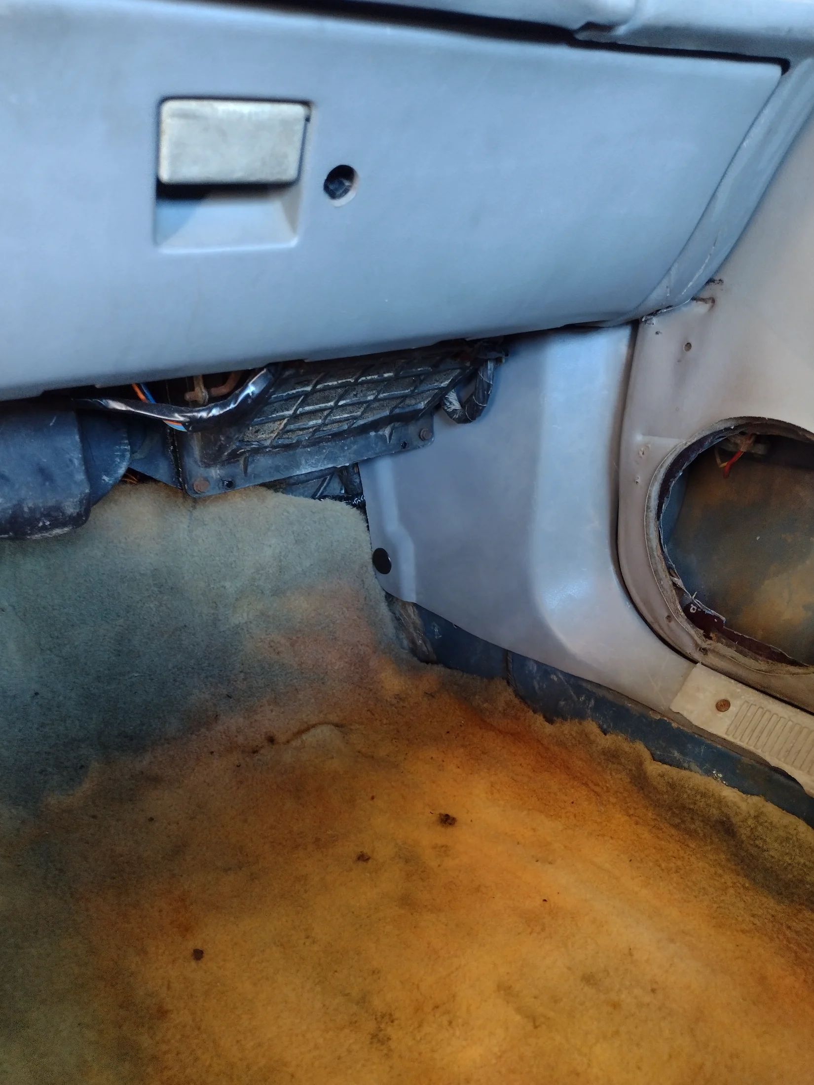

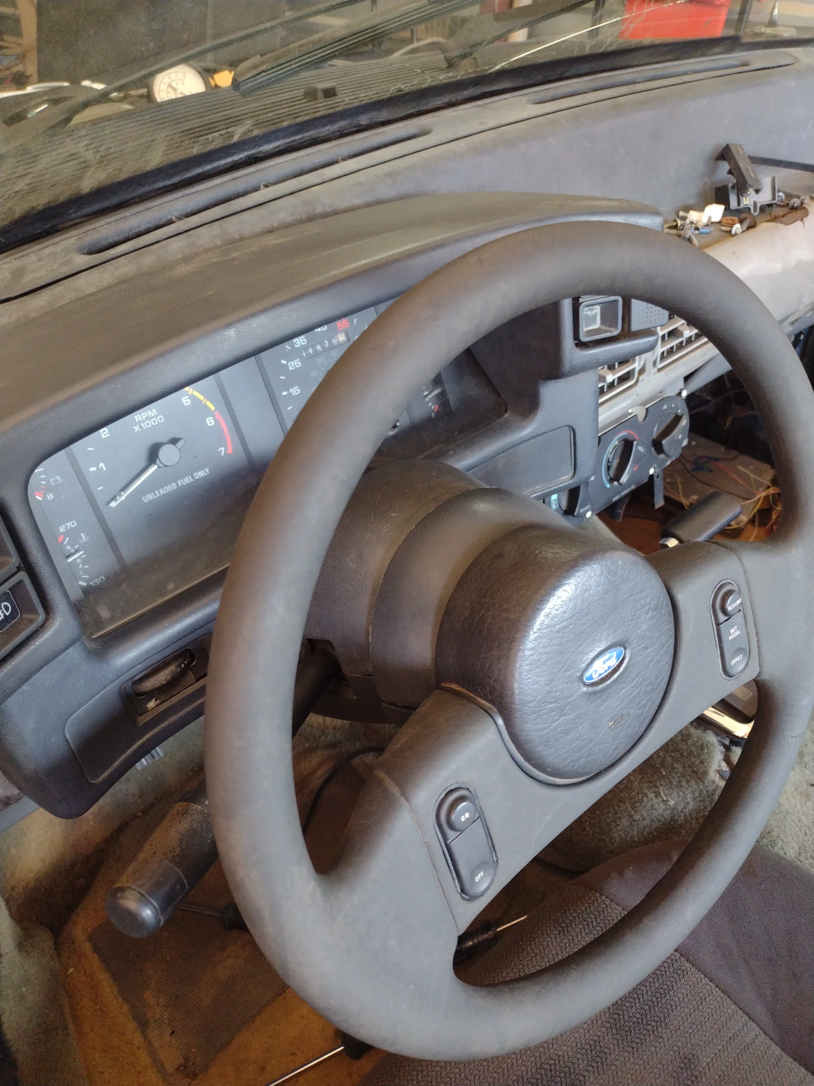

Still getting the interior back together. I'm missing a few things ( console )
But it's enough together it feels good to sit behind the wheel.

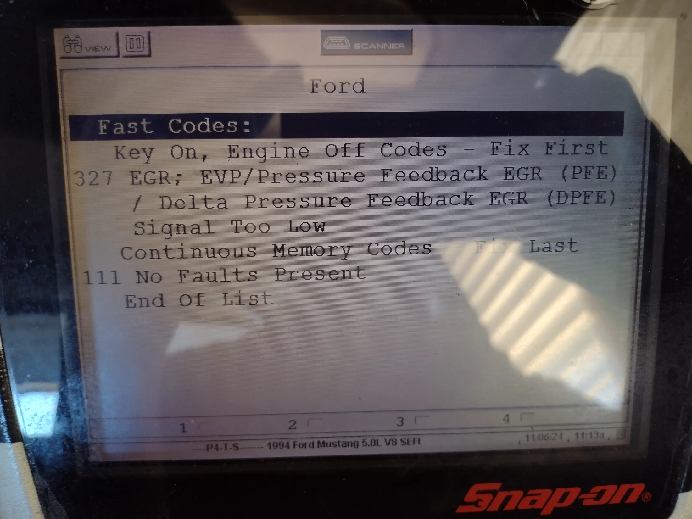

I have put resistors in the tab, tad and evr circuits to simulate the solenoids. That took care of those codes, only one left.
I'm still waiting for the resistors to build the evp simulator. I miss radio shack.
Having to buy components online and pay shipping on them. I mean like, how much do 10 resistors weigh. Like just put them in an envelope and stamp it. Well the ECU has been laying in the floor all this time while i test everything. I'm satisfied with it so i went ahead and buttoned up everything.
