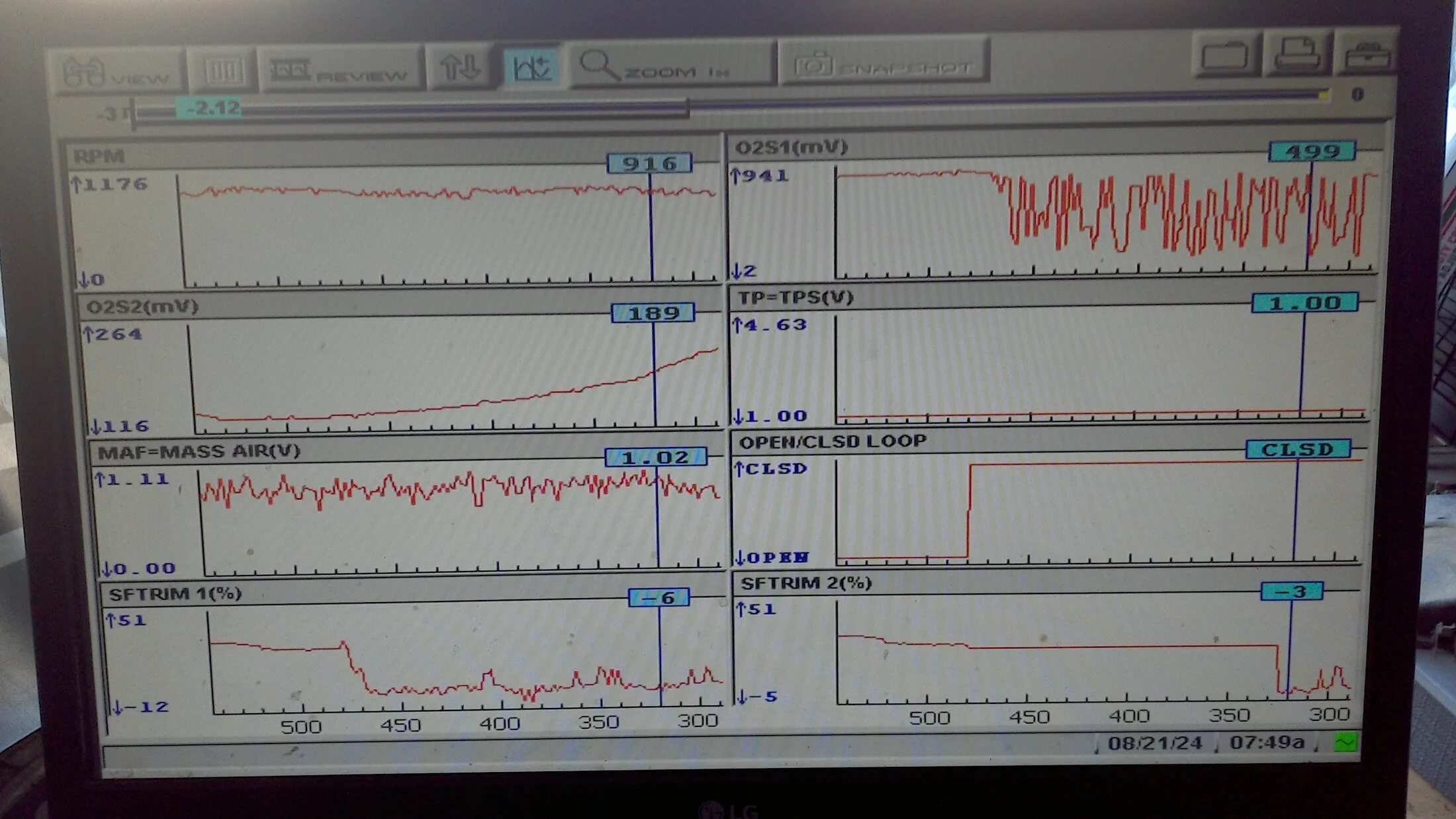

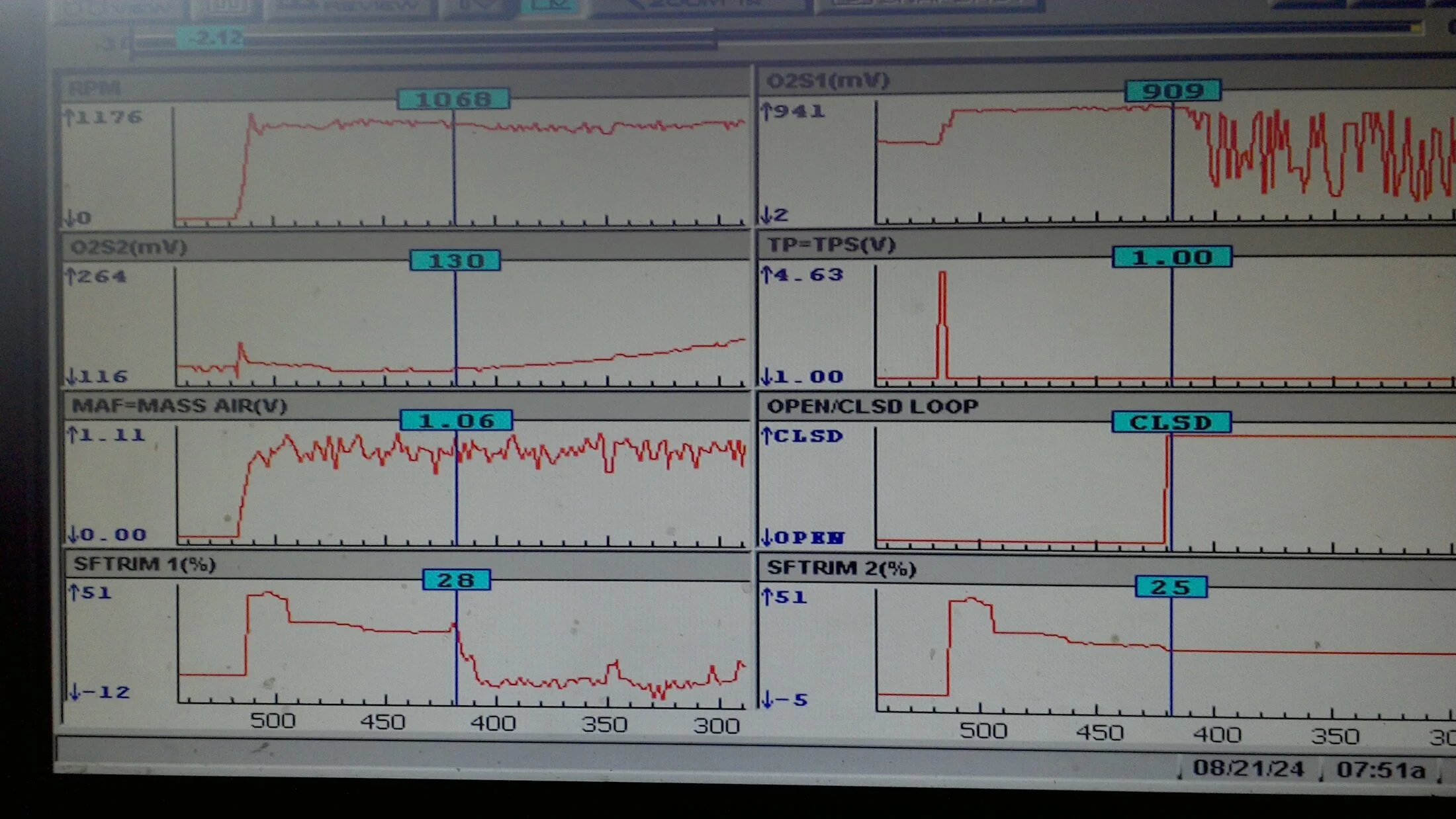

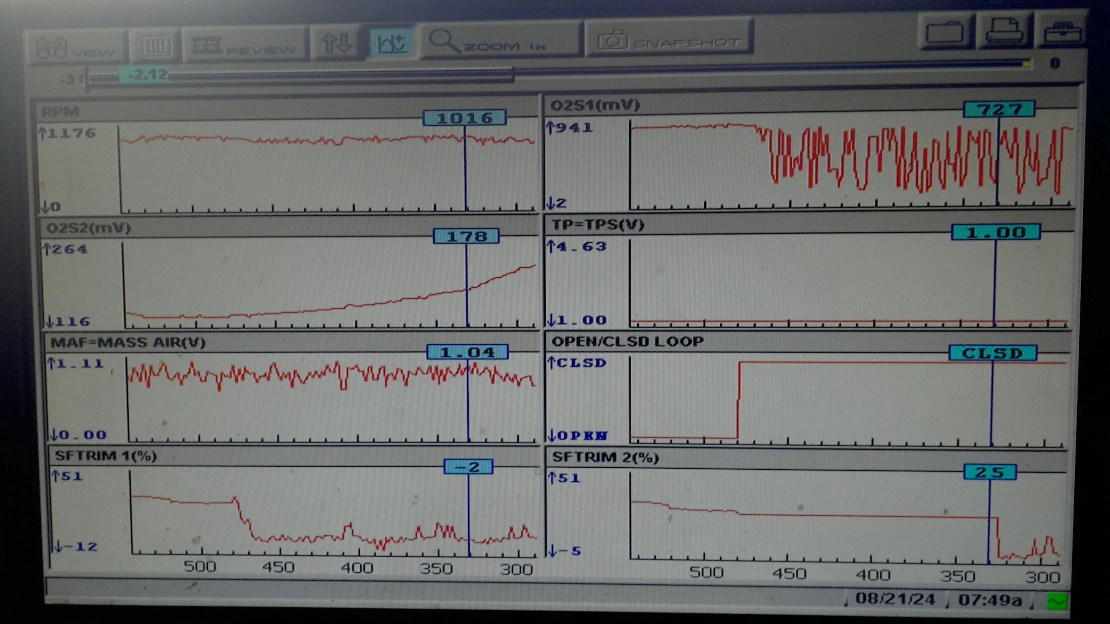

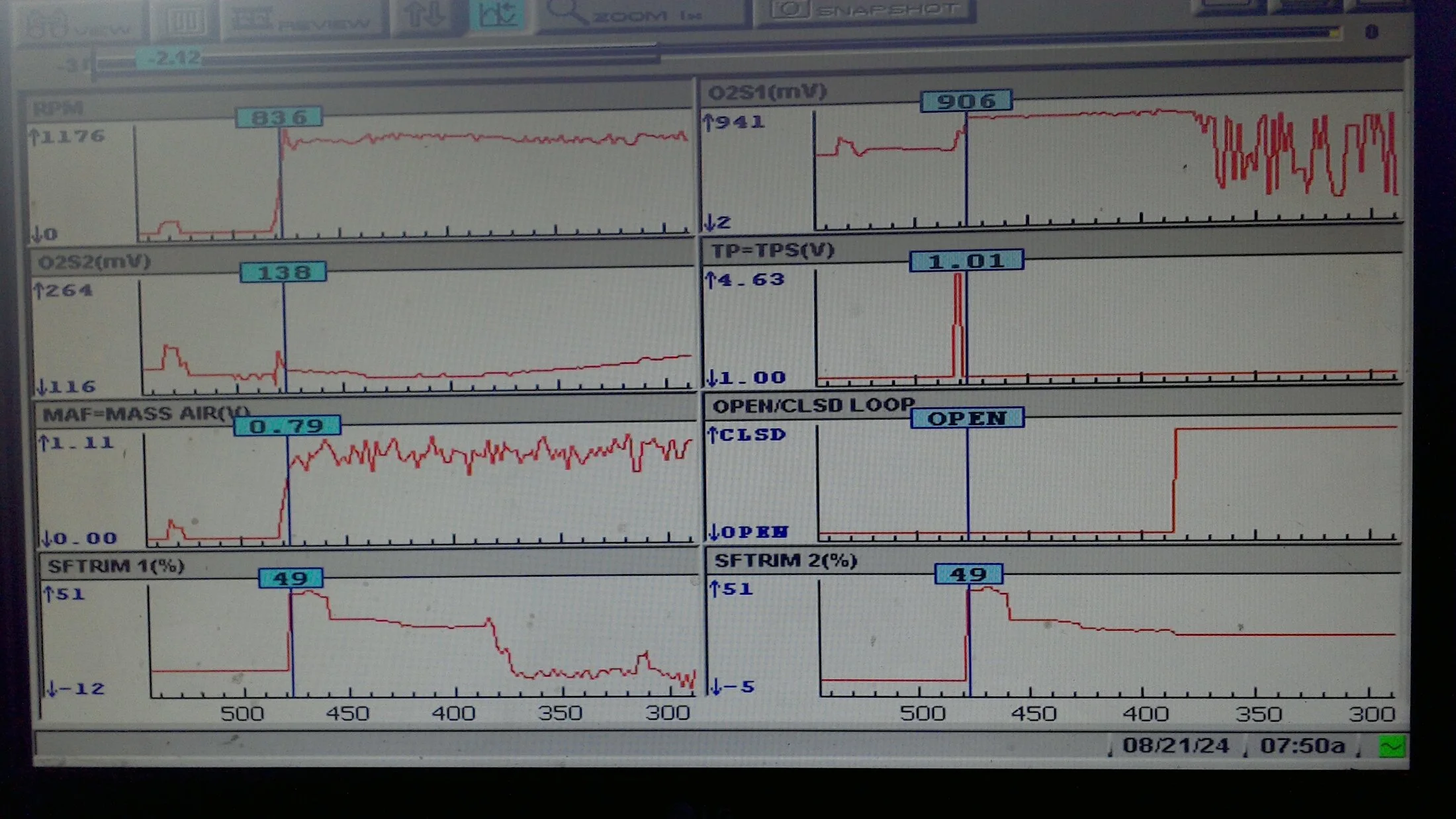

These are some more data scans. I also have a video but I can't load it here. I guess I can put it on YouTube and link it.

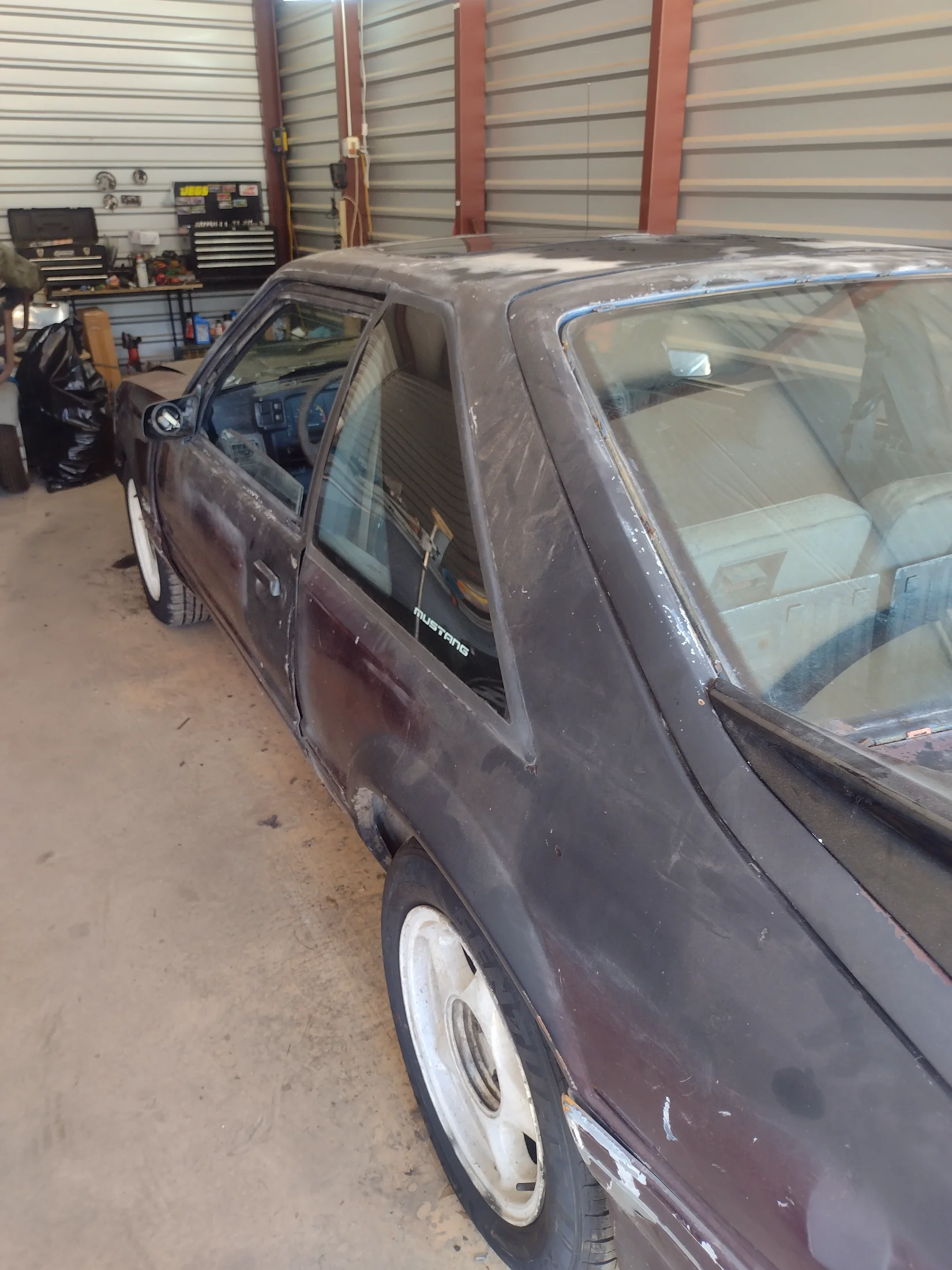

Anyway i cleaned all the glass and wiped all the dust off. As bad as she looks i bet with a bath she'll look better.

Once started it idles around 900 and creeps down to 750 when it goes closed loop. That's like perfect. This is at an ambient temperature of above 80 f.
These 94 computers go closed loop way faster than the older ones did.
She goes in and out of gear without a stutter, dip or hunt. Revs up nice and crisp.
Goose the throttle under load with no hesitation. She feels like she's got power. Really more driving is what it needs.
