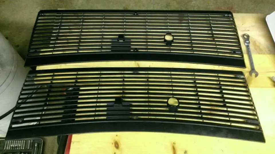

New Cowl
Old Cowl

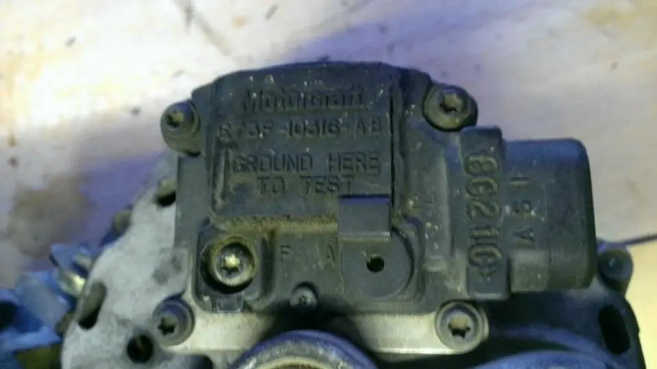

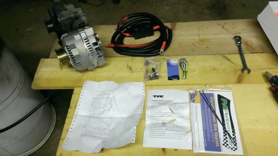

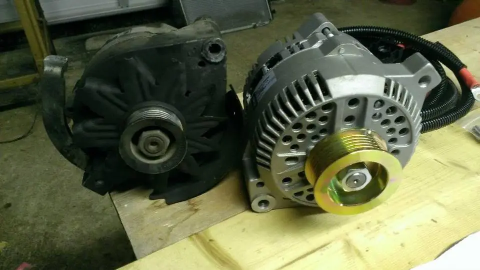

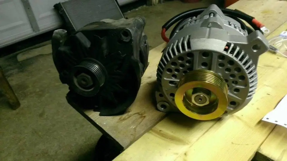

New alternator came in with power wire upgrade

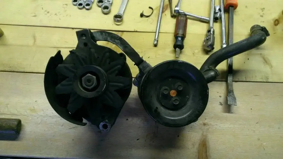

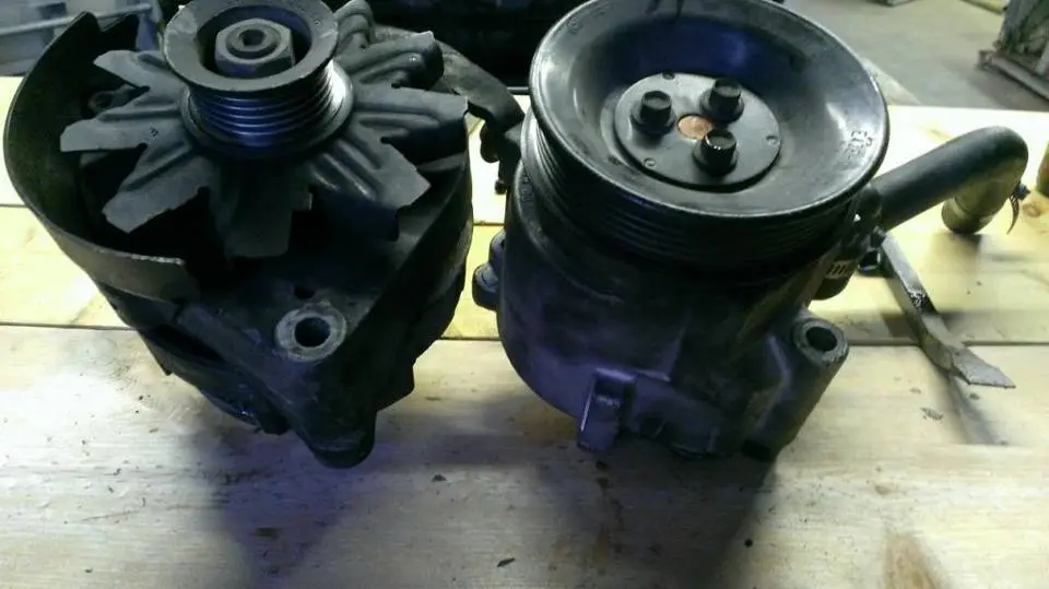

Notice the new alternator pully is larger diameter. Is this going to be ok?

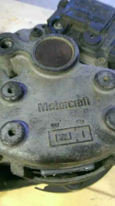

Still sporting the original 89 factory alternator!

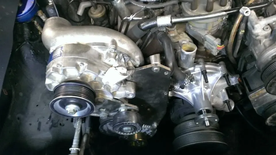

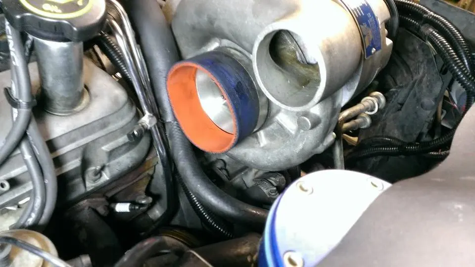

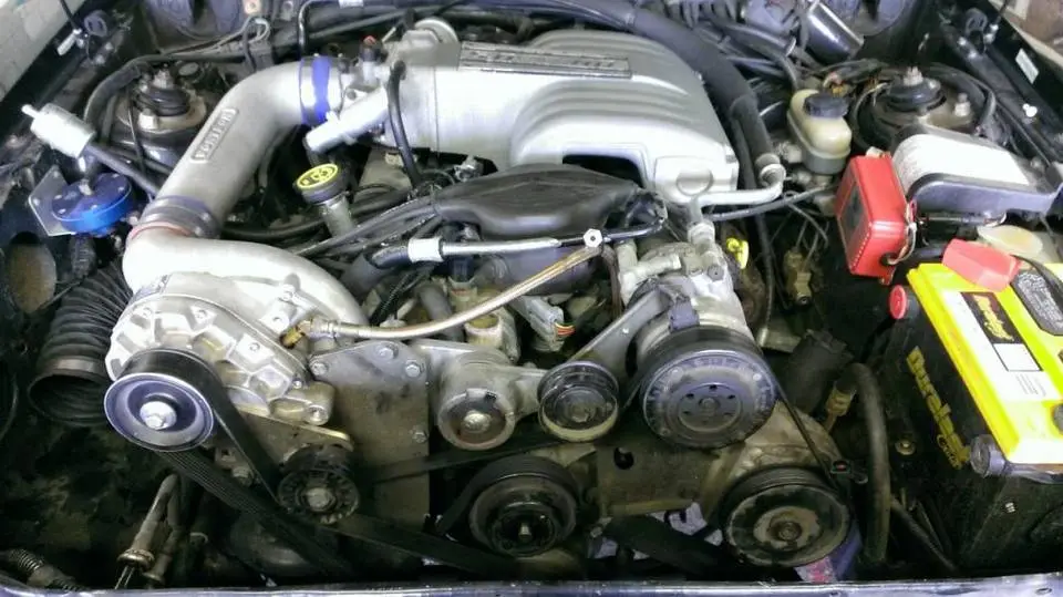

Alt + Smog, relocation bracket for Vortech SC

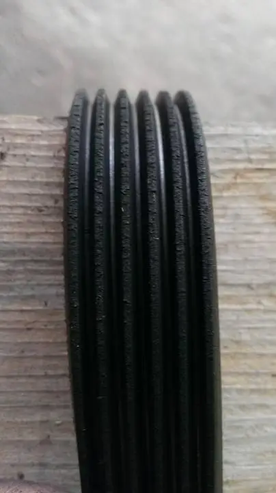

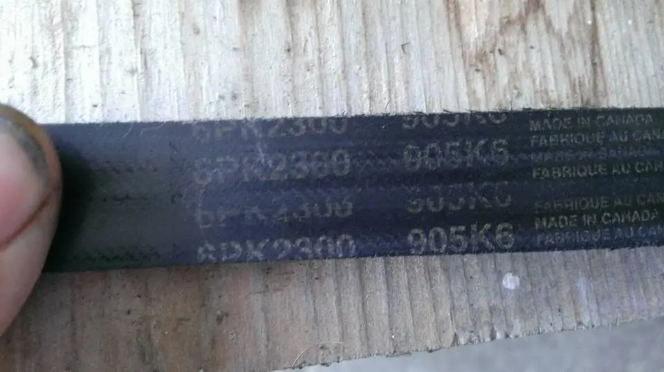

Is this the original factory serpentine belt?
Pretty decent shape
Bought new one anyhow, got new water pump too

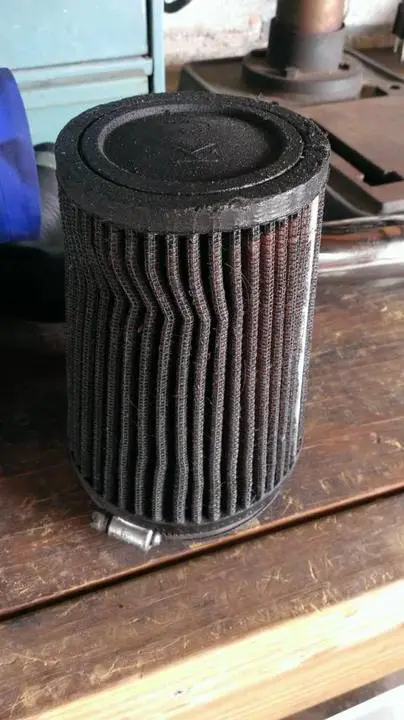

K&N Air filter, need to clean that up and re-oil

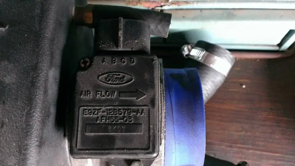

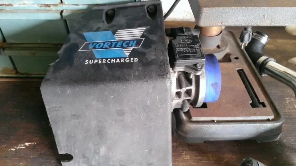

MAF sensor, still factory
Radiator, shrowd, fan, and MAF removed

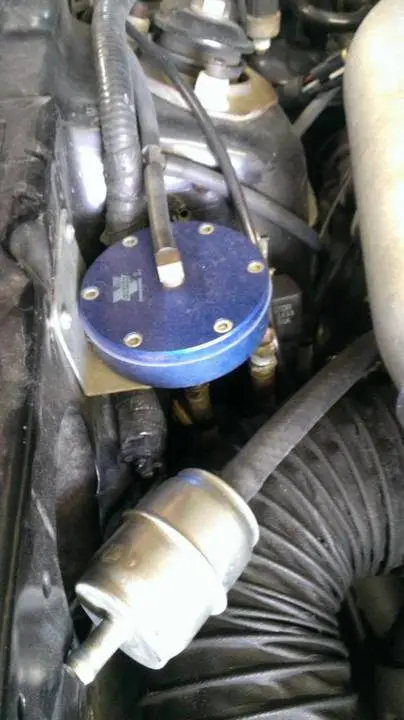

FMU I'm hoping to dump soon with upgraded injectors and MAF sensor

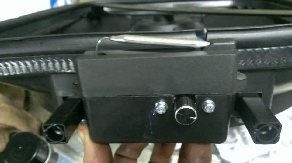

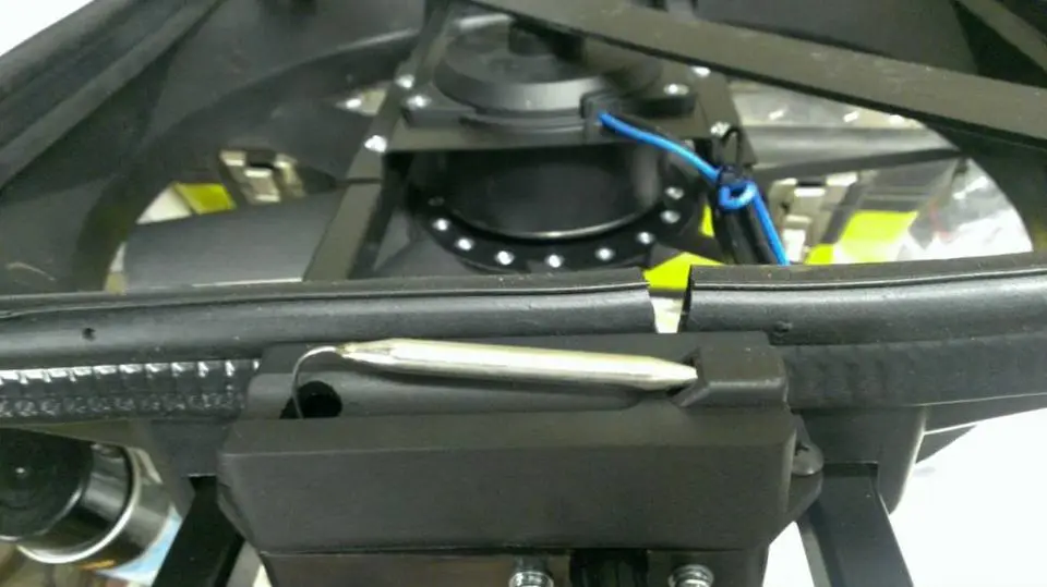

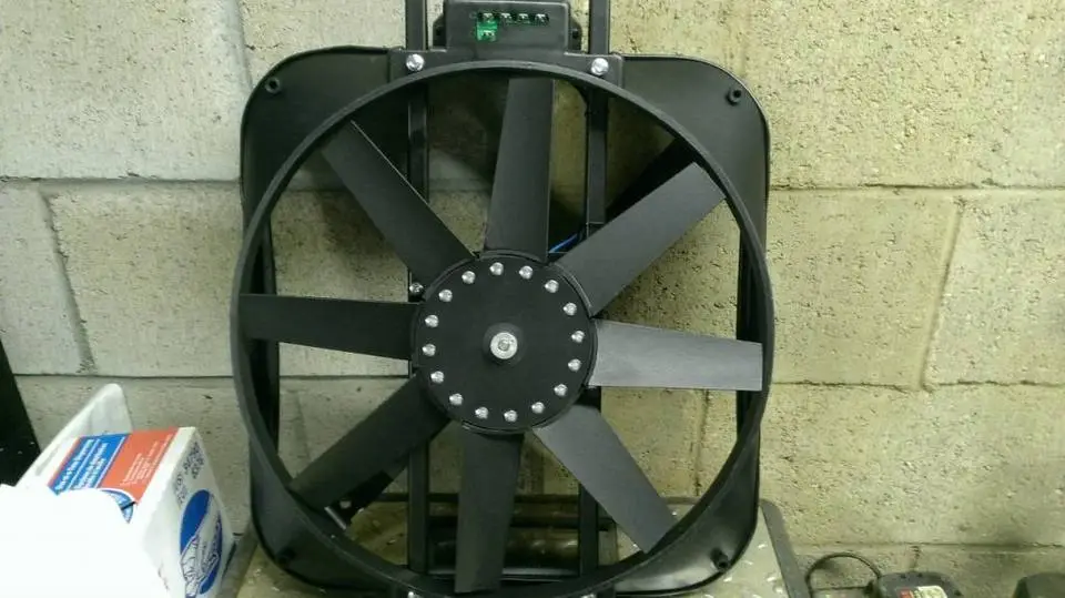

New electric fan - Proform
Adjustable thermostadt on fan

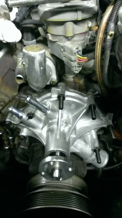

Got some parts in. Finally able to re-assemble.

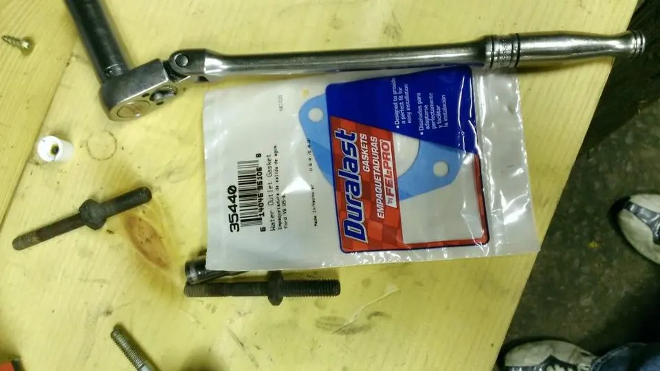

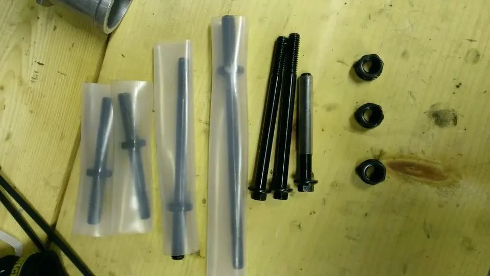

Water pump bolt kit from LMR:

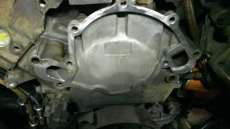

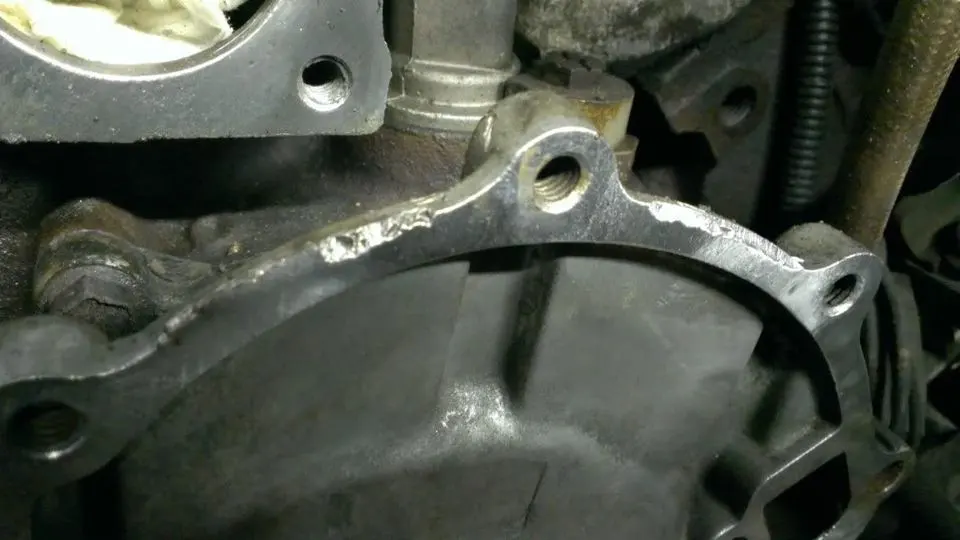

Noticed after I cleaned up my timing cover plate the top has either been chipped or it was just formed like that. Wasn't too bad though so I continued.

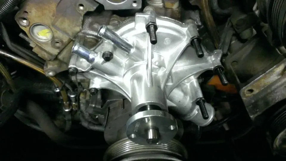

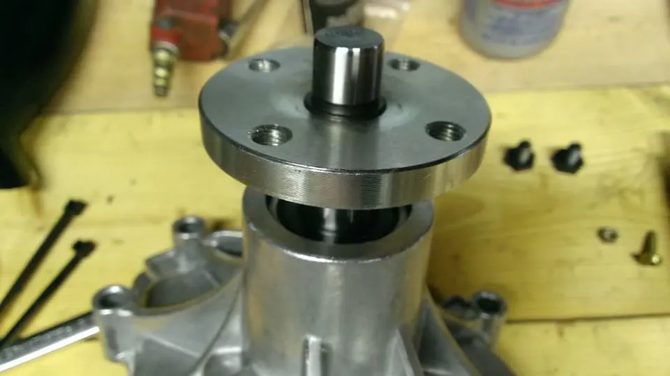

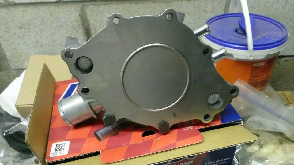

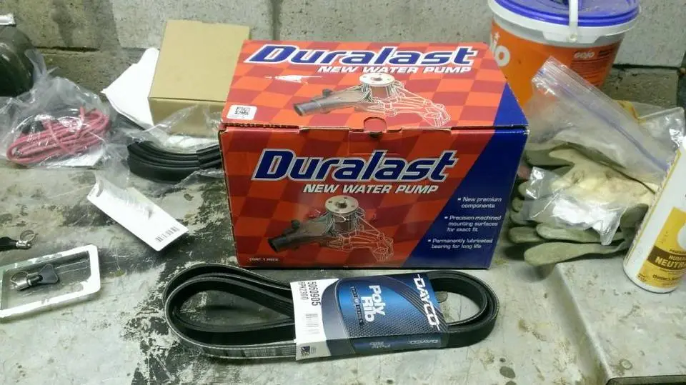

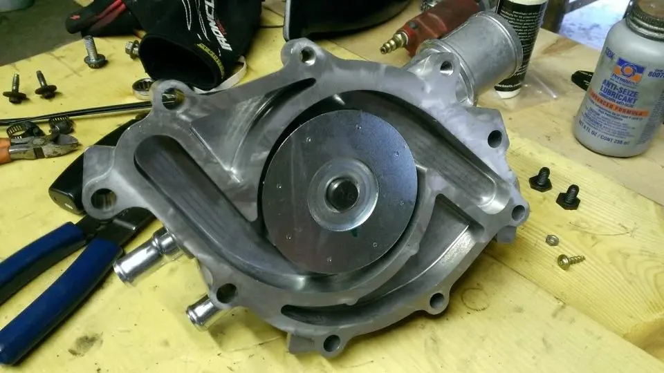

New water pump. Duralast heavy duty.

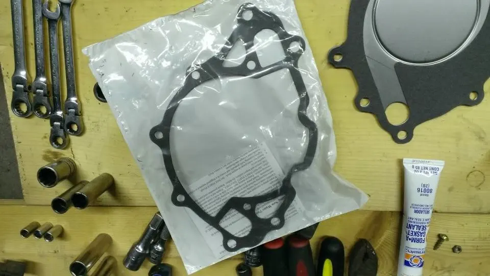

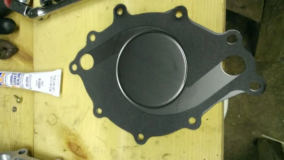

I used the permatex2 and coated all my seals. The inside and outside seal for water pump and the seal for the thermostat.

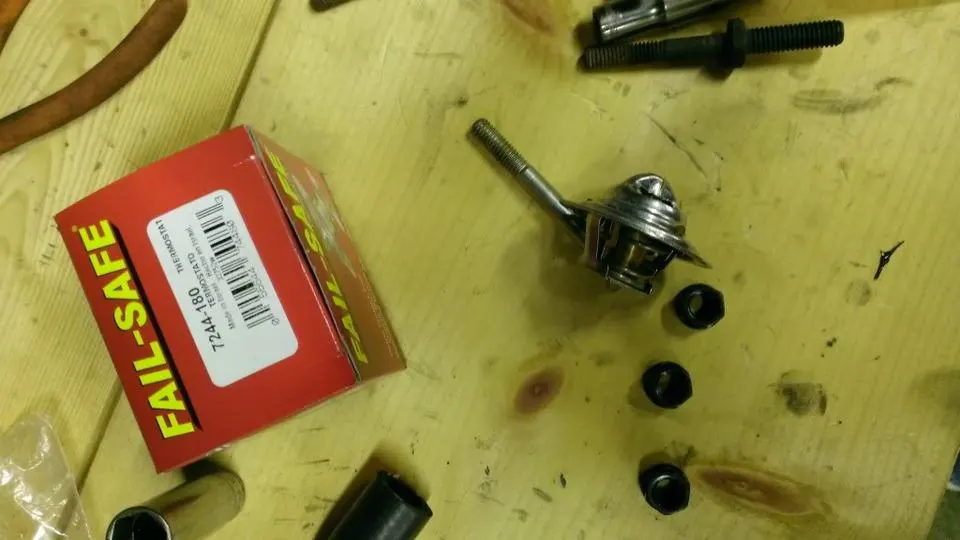

I bought the fail-safe again. This time I got the 180degree instead of the OEM 192.

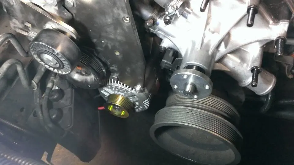

Water pump and thermostat installed.
I used Perm Anti-Seize on all the bolts for water pump and thermostat.

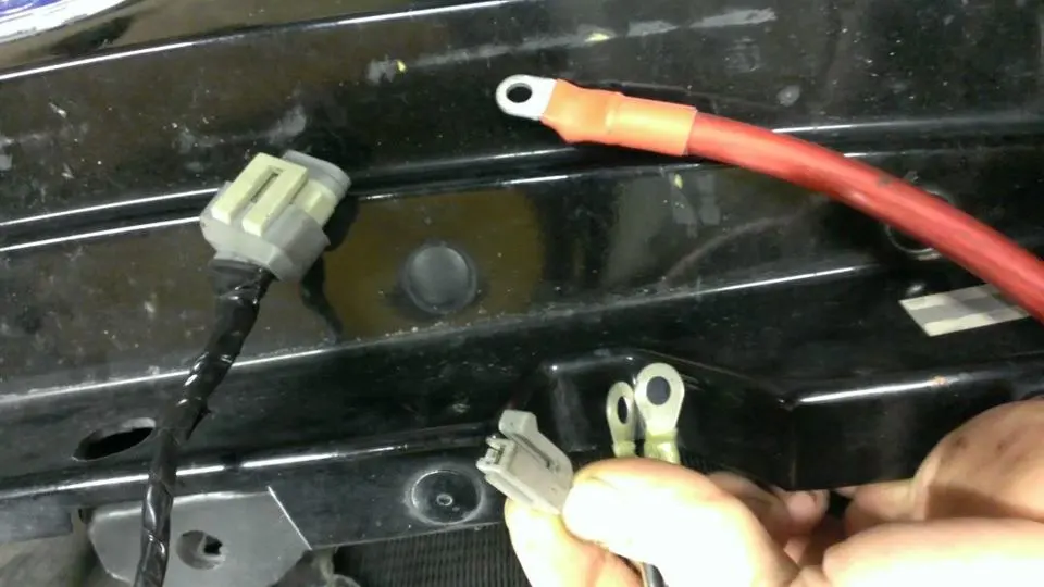

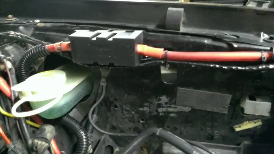

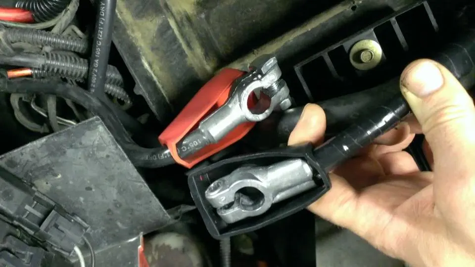

I installed the new 130 amp alternator and power wire upgrade. I have a larger battery than the mustang calls for so the relay just barley fit.
The other end with new plugs and terminals:
Installed new 2AWG Positive and Negative feeds to battery:

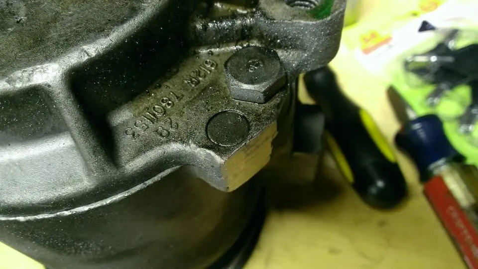

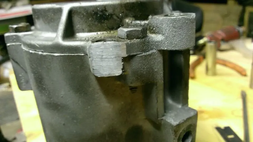

This is for all you Vortech SC folks out there. The Vortech plates re-locate the alternator to under the smog pump and the top bolt is actually attached to the smog pump lower bolt with a nice bracket supplied in the vortech kit. However with the new alternator being larger in diameter I had to shave off some of the smog pump that was protruding so that it would fit. Very simple modification.

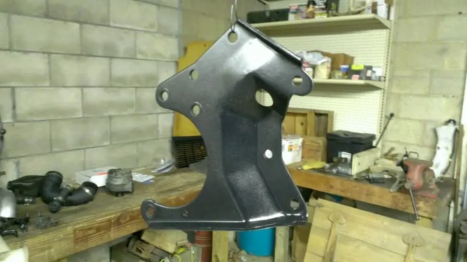

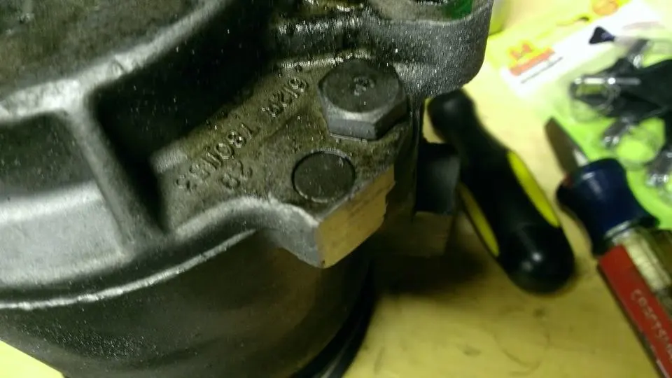

I put the last coat of paint on my cleaned up A/C compressor bracket before I quit last night. Tonight I will install the rest of the brackets for the vortech and A/C. Then I can start the install of my radiator and new electric fan.
