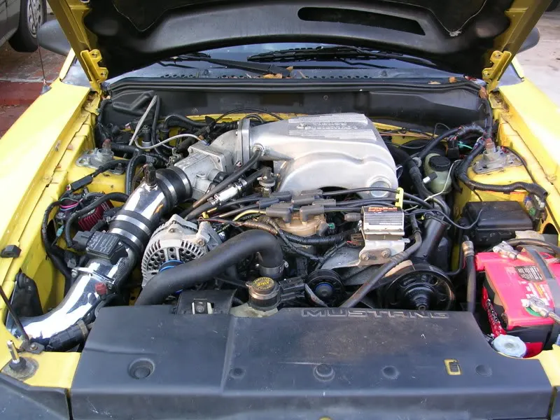

revhead347
Apparently my ex-husband made that mistake.
Jun 14, 2004
8,666
1,382
214
41
Acworth, GA
I've thought about going that route, but didn't really want to deal with it. When I say cleaning up the engine bay, I really mean the wires and such. Most of y'all have really clean engine bays and I am jealous!
Here's a picture of mine which should help with the jealousy. I'm thinking of adding a heater core pump in there too. I'm tired of freezing my ass red in the winter.
