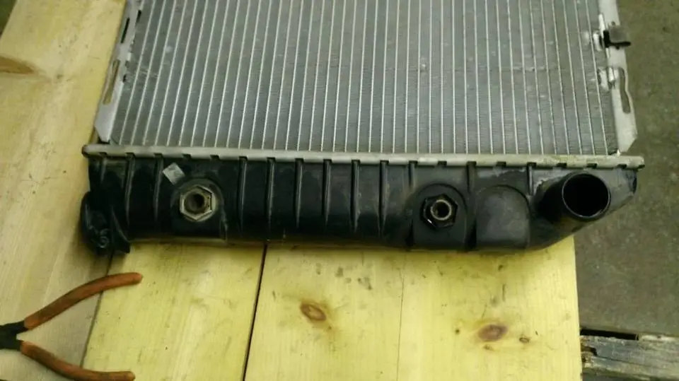

As I was cleaning up my radiator and getting it ready to install I noticed these two threaded holes. What are they and do they need to be capped? They look like maybe cooling connections for oil pump or something??

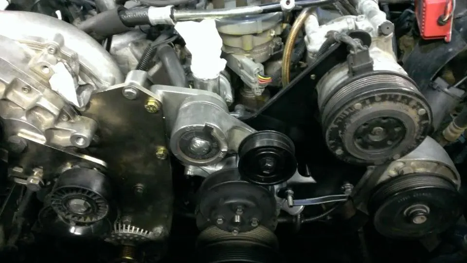

So then as I have all the pully's and contraptions bolted back on and go to install my nice brand new serpentine belt I do as I normally do and just start the process of elimination. Does it go this way? No. This way? No. Ok. Oh yeah, let's look at the documentation... Word to the wise, I always take pictures during dis-assembly so I can put stuff back together. But of course, something else goes wrong. The belt is too short??!! What? The numbers match up exactly from the old worn out belt to the new nice and shiny grip ready Dayco. WTF?
Turns out the alternator IS a larger diameter, which makes it push out from the smog pump further. Maybe .25 inch. Then the pully is also a larger diameter. Another .25 inch. Add that up and I am a 1/2 inch long for the new factory standard belt.

Thanks A91what. I found the belt. Thank the old brains I developed as getting the next 2 size belts worked. I almost just went with the next size up. It turns out the new alternator cost me an extra inch in total. Each size serpentine belt is measured by .5 inches. So my new size serpentine is 5060915. Factory is 5060905.

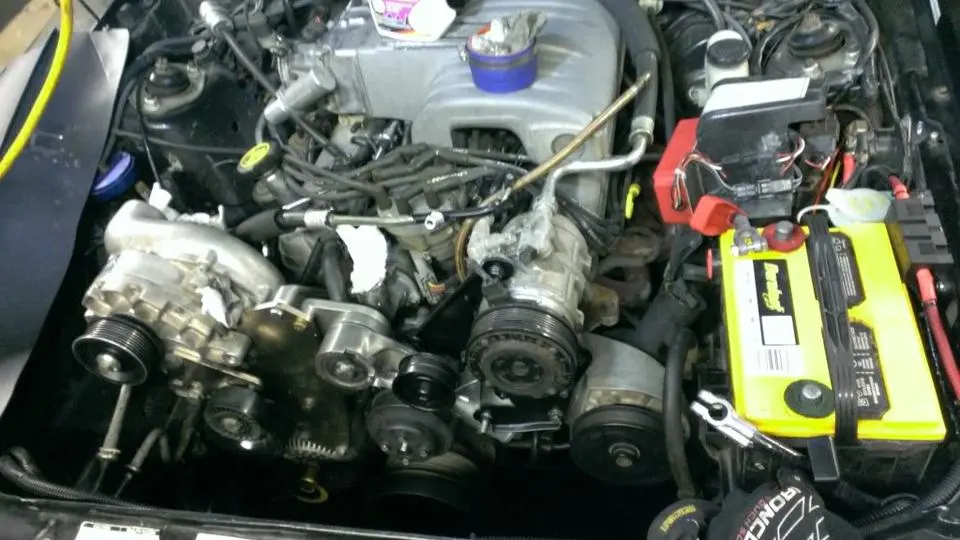

I got my supercharger all back together and cleaned up. Got some hoses installed. Got my door bracket cleaned, painted, and reinstalled with new door pin kit.
