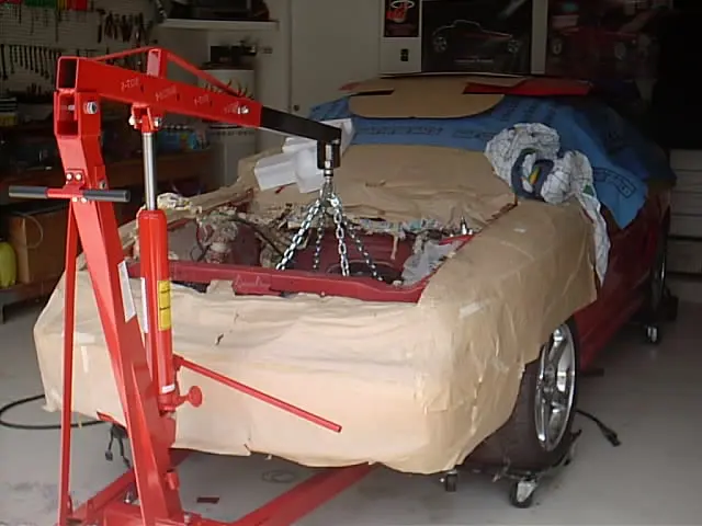

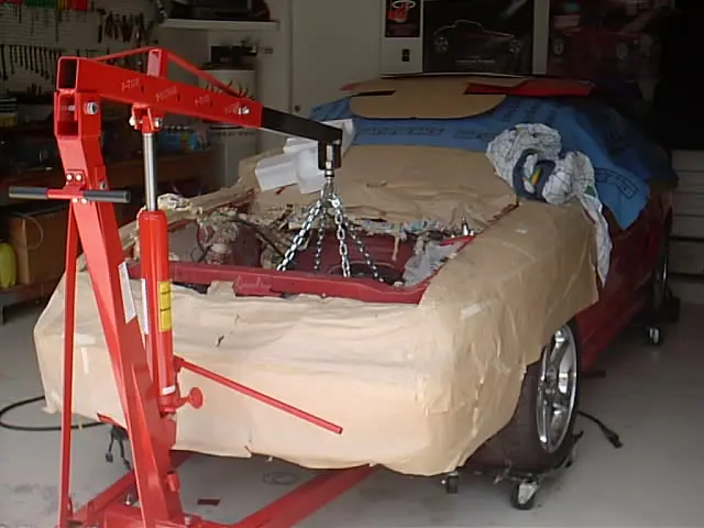

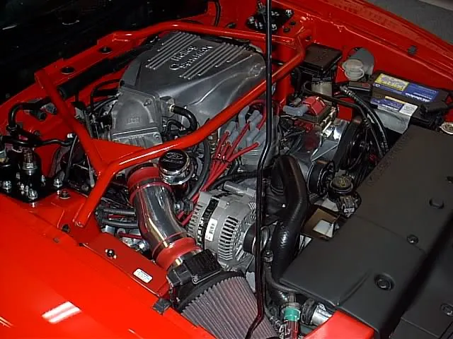

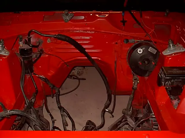

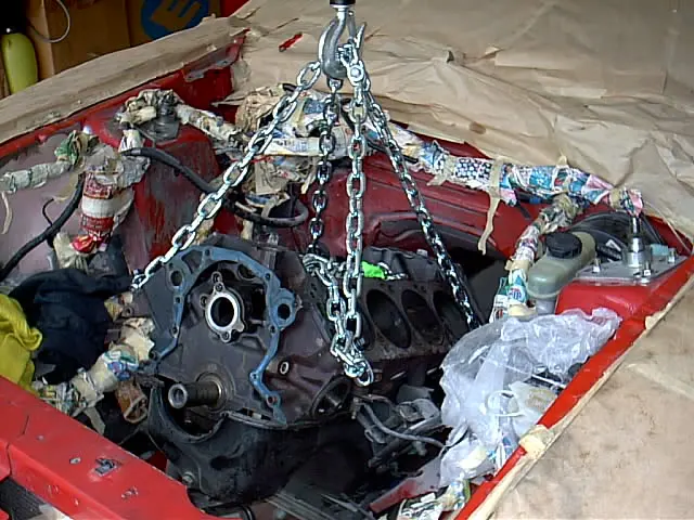

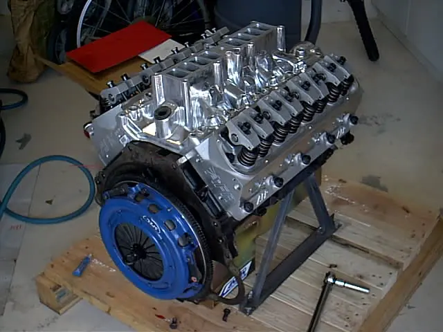

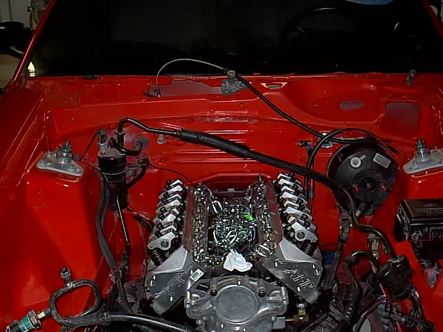

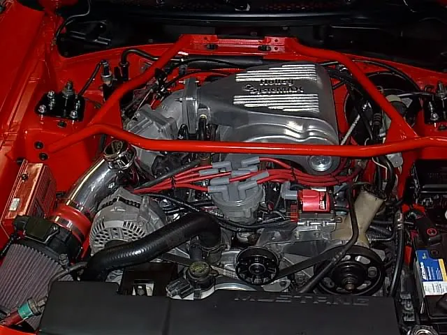

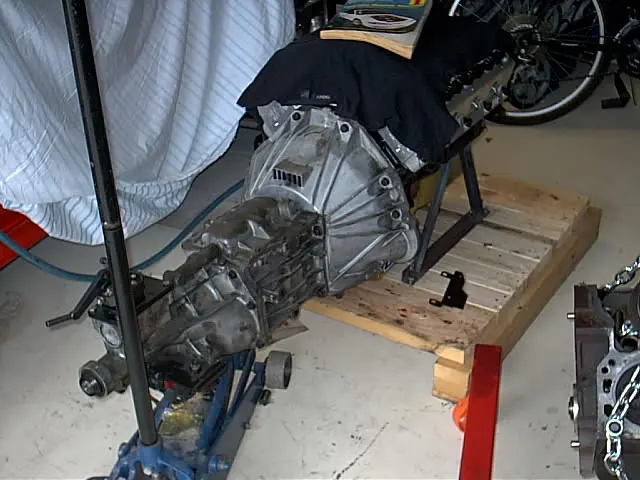

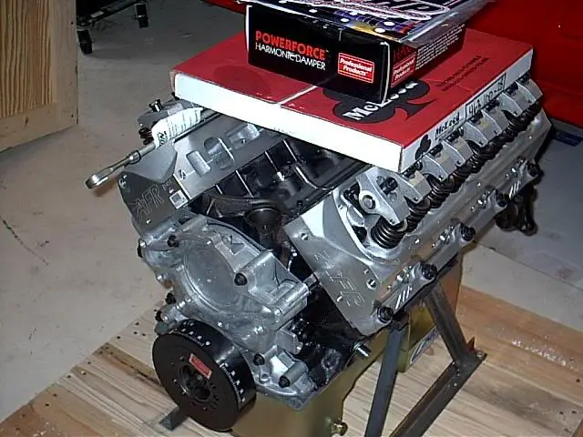

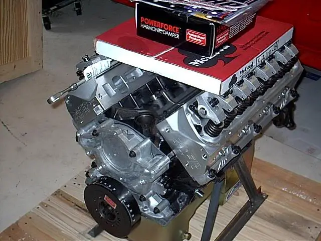

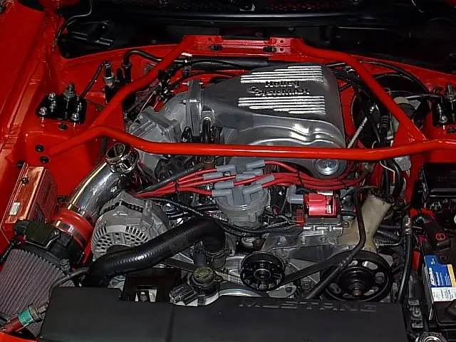

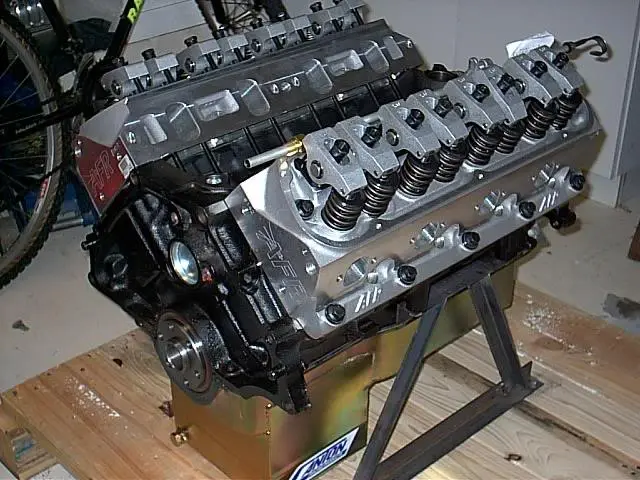

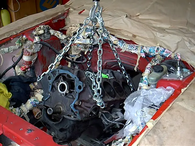

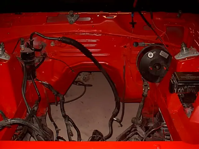

Removing the stock 302.

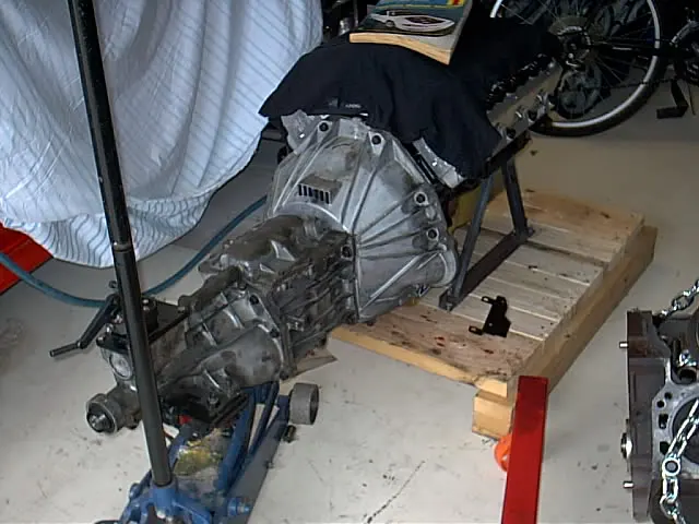

Pulled with the tranny still attached.

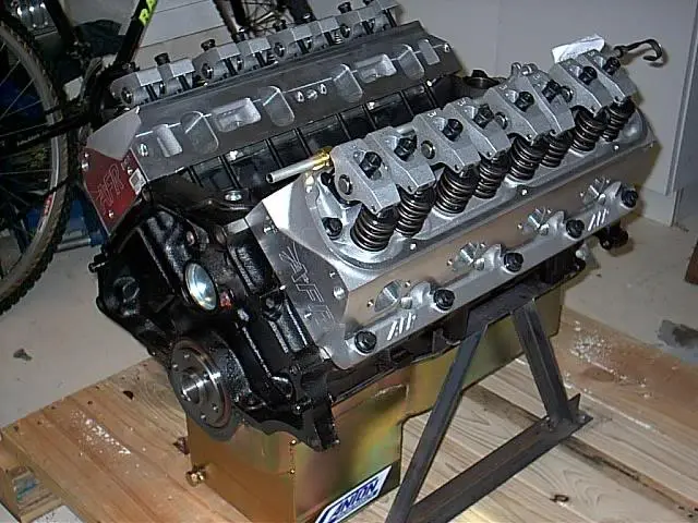

Removed the crate cover to expose the new 347.

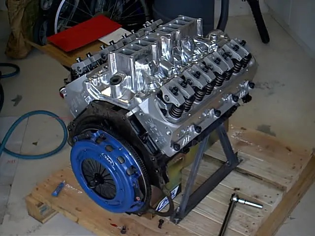

It's easier to install the flywheel, clutch, bellhousing, clutch, intake, water pump, etc. while the motor is out.
Bolted up the Tranny.

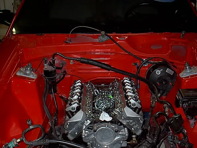

Bare engine compartment waiting for the new motor.
New motor in it's home.
Finished product.

It's better than ****! Vibrant, your car makes me drool.
I cannot wait to have the time and cash to tear this car apart. I've got just about everything planned out, short of the motor specifics and a Photoshop rendering haha
