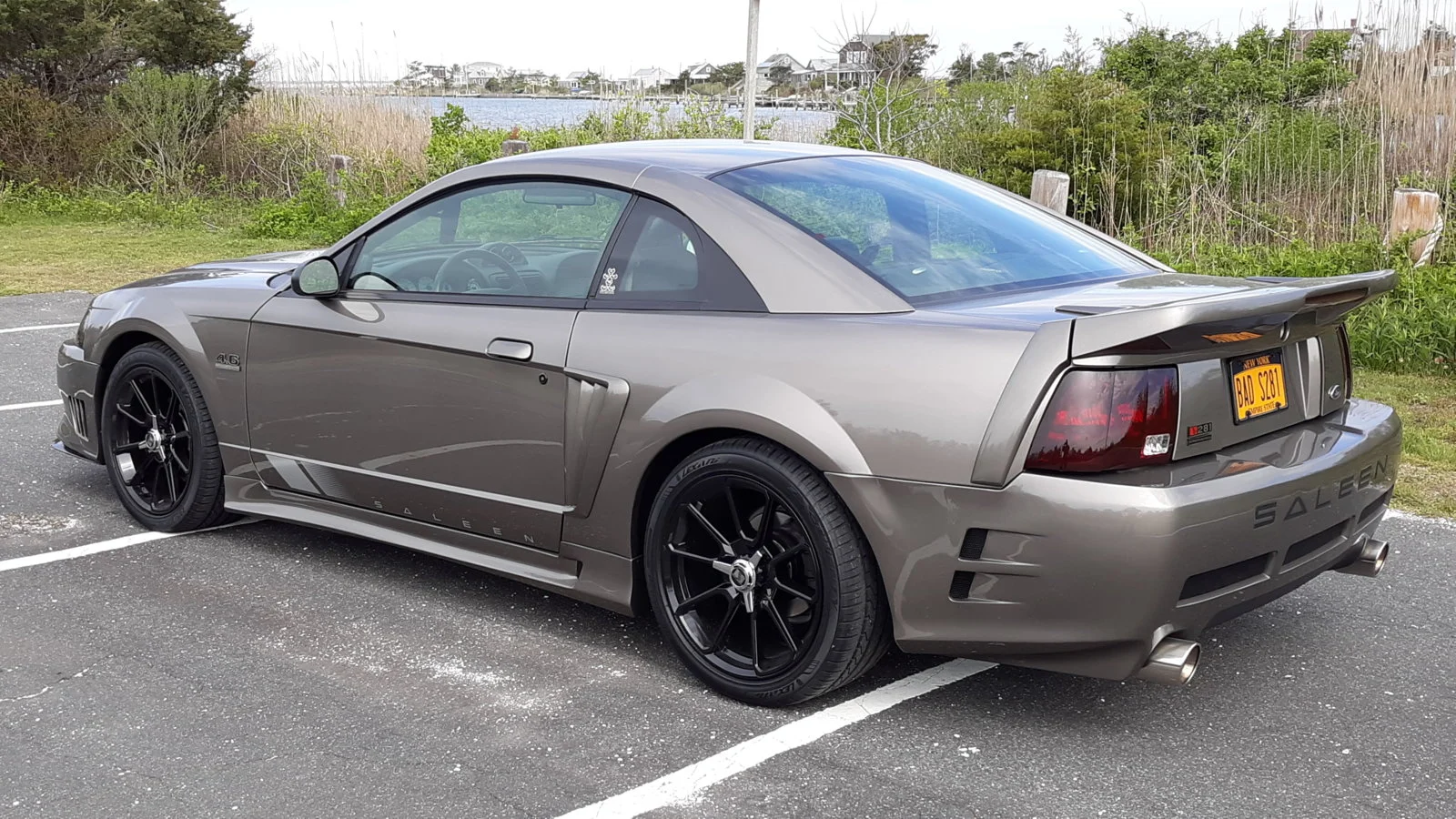

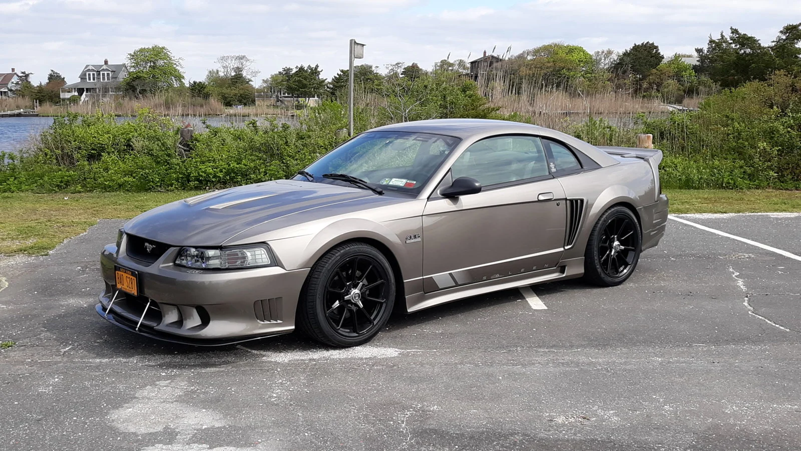

been running 18x9.5 with 285 /35/18's +20 offset fronts +40 rears lowered suspension. no rubbing no issues.
To be completely honest I wouldn't be able to tell you as I bought the car with the rims... How would I find the offset as I don't believe it's engraved on the wheel
Take a ruler or a level or just something straight and with the wheel off lay it down across the backside of the rim and measure to the hub. Your wheels are 9.5in so if you measured 4.25in to the hub then that would be 0mm offset dead center, 3.75in to the hub would be -12mm or so, and 4.75 to the hub would be +12mm or so bada bing bada boom
