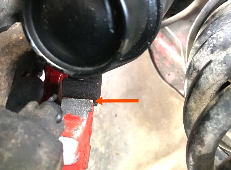

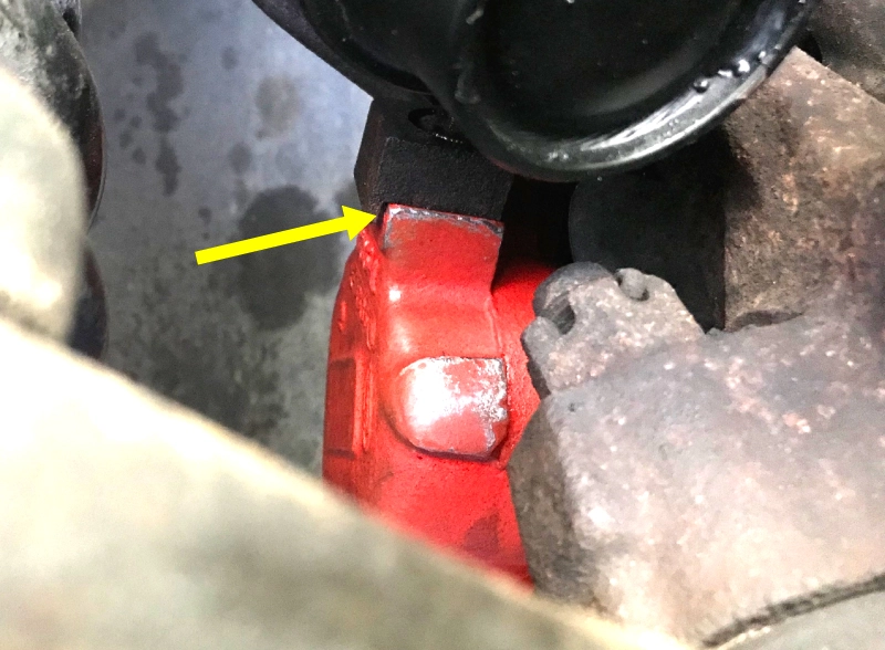

Obviously, I have bled the brakes, and can certainly bleed them more but I am wondering if the junctions at the calipers could be bad. I DID replace the banjo bolts and the crush washers and I am sure I have the correct calipers on the correct sides. I am NOT seeing any brake fluid leaking, but I can't help shake the feeling that the metal looks damp, almost like the fluid is seeping through. It IS dry to the touch and it's possible I am just being paranoid. (See the attached photos of the calipers) Please ignore the missing paint, brake fluid took the VHT paint right off.
Is this a common issue when replacing calipers? Just more bleeding? Replace the rubber hoses too?

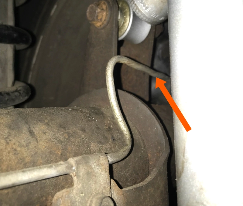

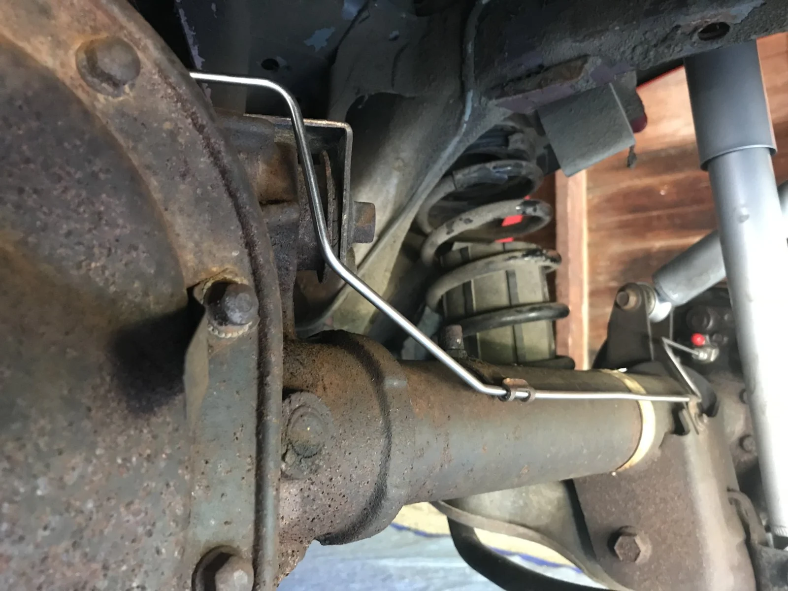

The rear axle brake lines were pretty well seized to the brake fittings when I loosened them from the wheel cylinders. As a result, when I loosened in the beginning, they kind of twisted like a Twizzlers candy. I'm thinking they might be contributing to a bad seal at the real wheel cylinders. (see the attached photo of the rear brake line)
I'm considering ordering a set of pre-bent lines from LMR, anyone have any success with these? I'm concerned how they will survive the shipping to my house.

I also used the pre-bent rear hard lines from LMR. They were almost perfectly bent and I would definitely recommend them.

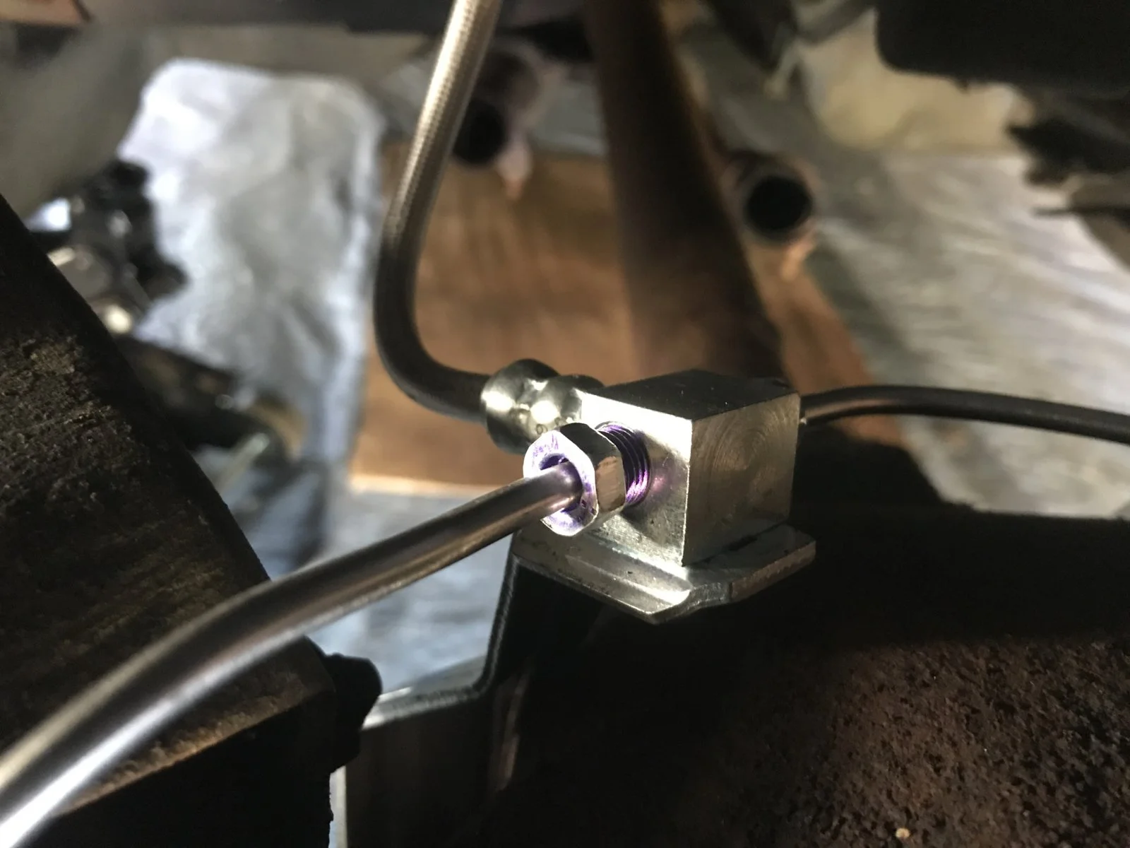

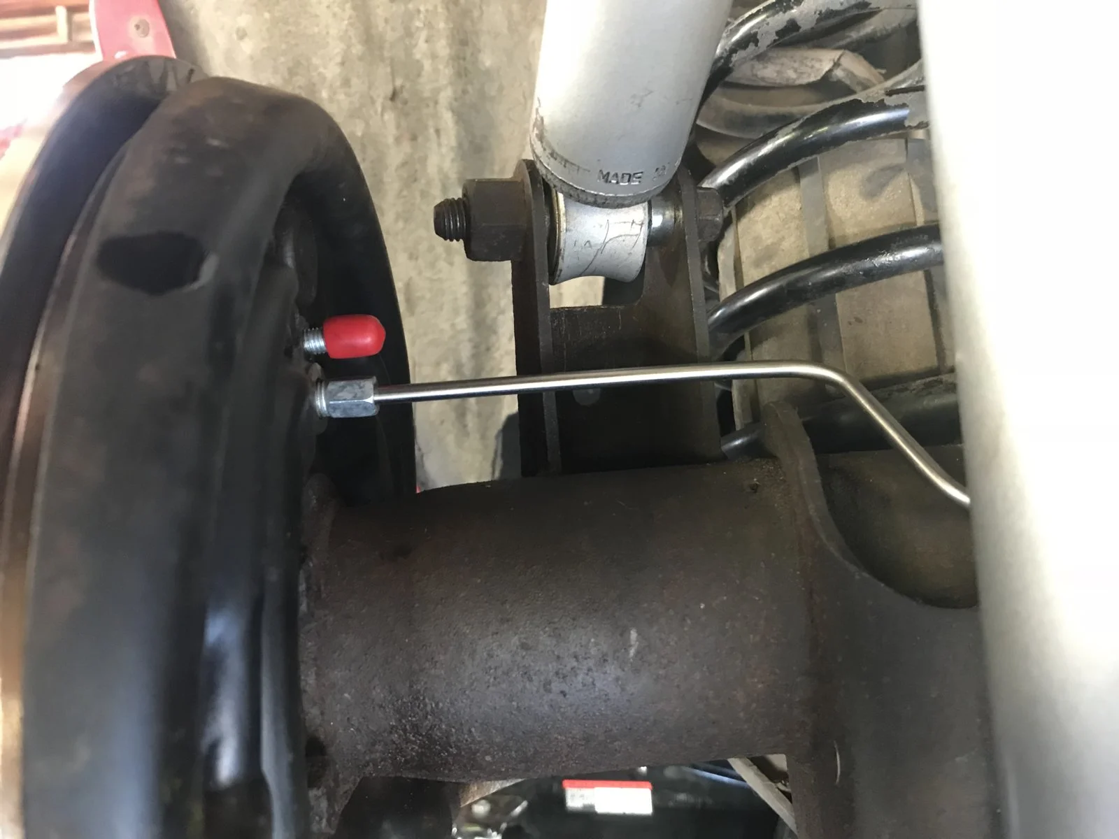

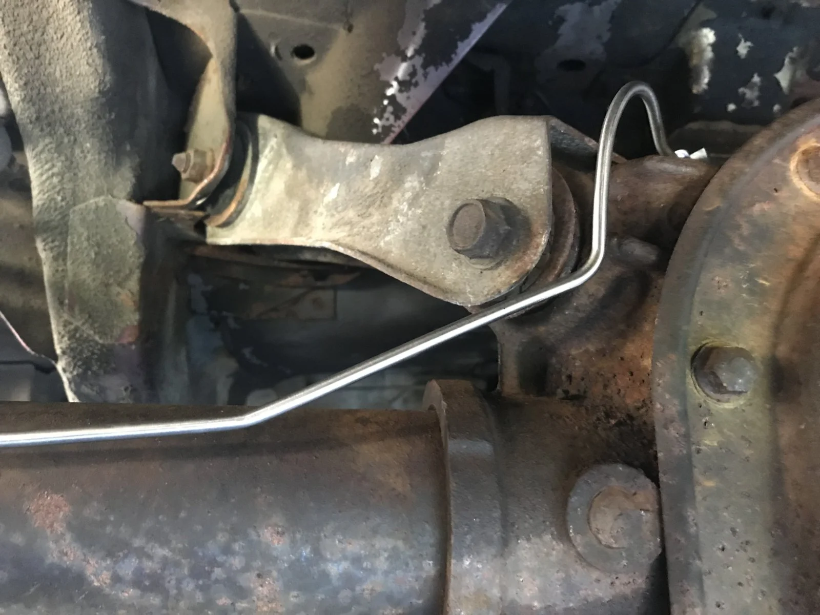

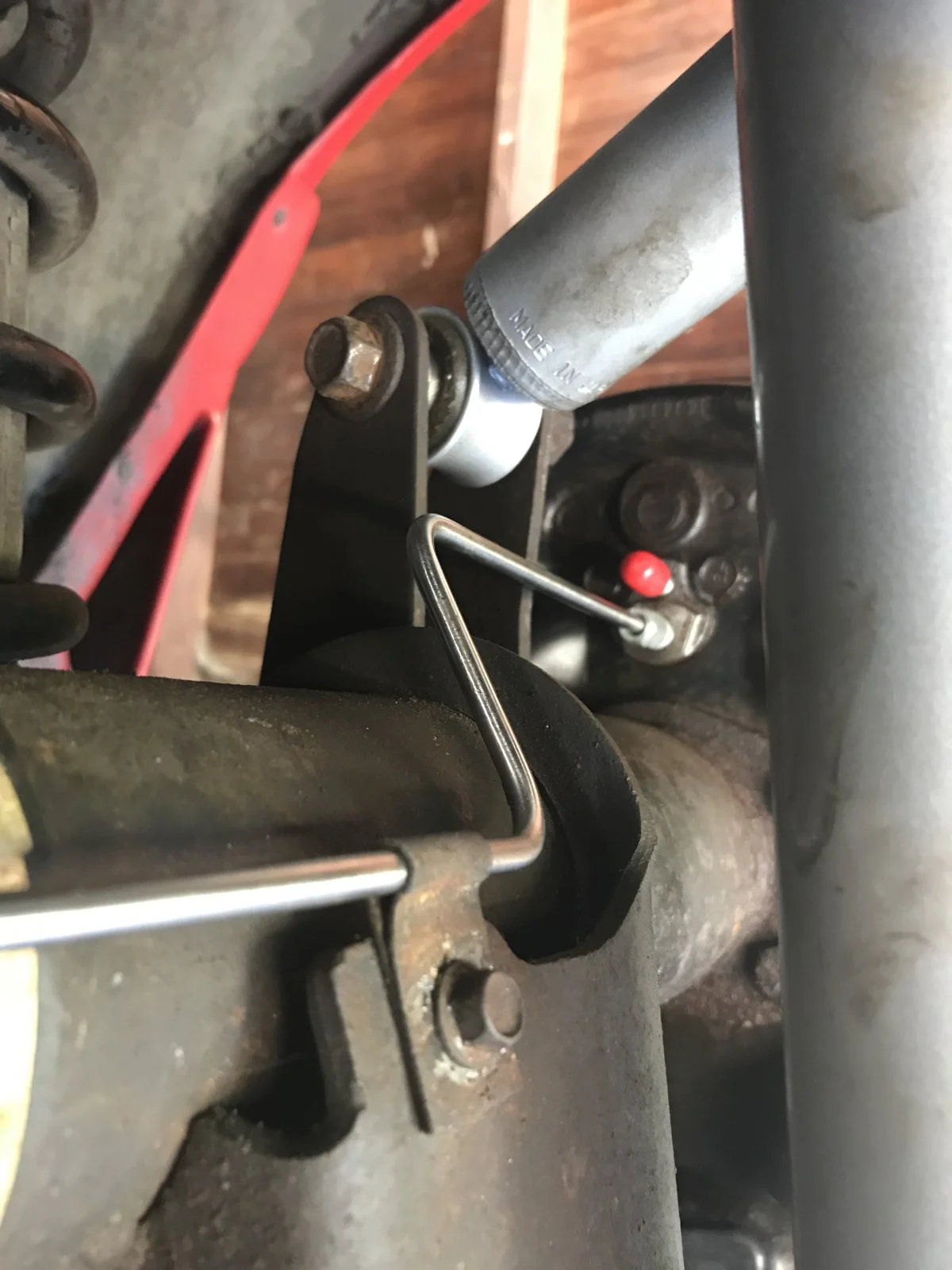

Just wanted to give an update, I bought a set of stainless steel brake hoses, and a set of pre-bent lines for American Muscle. I was REALLY impressed with how easily the lines went together. The bends were one point, the fittings were great.
So far I have only installed the rear stainless brake hose and between that and the new hard lines, its already a HUGE difference. Pedal is significantly more firm, feels like a whole new car already.
Thanks for the input guys!

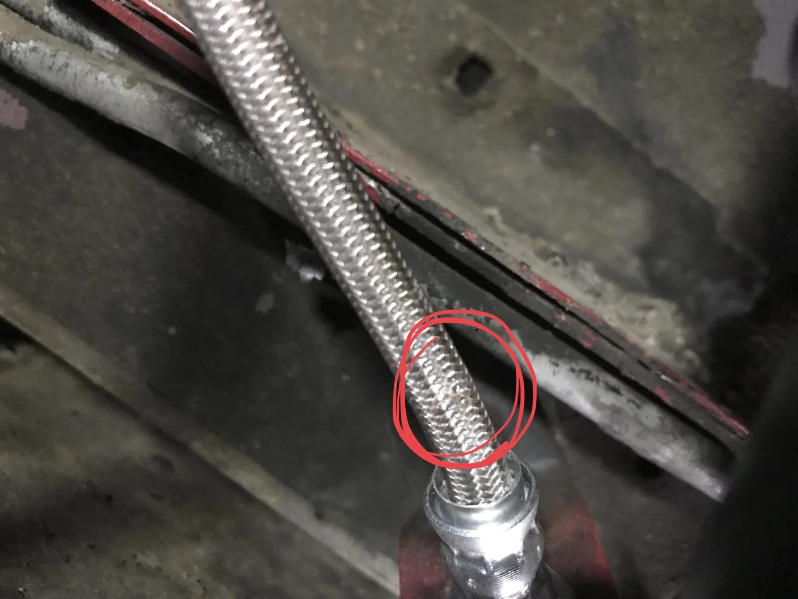

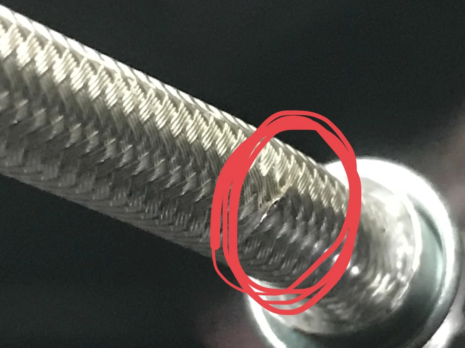

I do have a new concern. There appears to be a small imperfection in the hose (or at least in the rubber clear covering on one of the hoses). The hoses went on without a hitch and I was careful with bending them but it almost looks like it was kinked at one point anyways. :mad:
I’m not super familiar with stainless hoses, so I’m not sure what to look for in terms of problems, but I think there’s something wrong here. Thoughts?
Attached 2 pictures. I’m super super zoomed in on one of them, otherwise it’s very difficult to notice from the naked eye. I’m being paranoid, but it’s also a pretty important system to have 100% confidence in (obviously)

I'd contact LMR and see what they have to say.
More than likely you are fine. The braided lines are really standard rubber lines with the braided reinforcement on the outside to prevent expansion, which should be very little. That blemish probably doesn't affect anything in reality. I bet LMR says something similar.
Great ideas guys.
I actually skipped LMR and when straight to J&M Performance parts.
I emailed these pictures (and a few others) to them and a guy named Brian got back to me like RIGHT away. Basically the little blemish/notch or whatever it is a by-product of the manufacturing process, he said it happens time to time from the "skimming" machine before it goes to another press (or something like that). It's also in the clear coating and not in the steel braiding itself. He was extremely confident that it was nothing to worry about.
