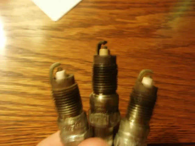

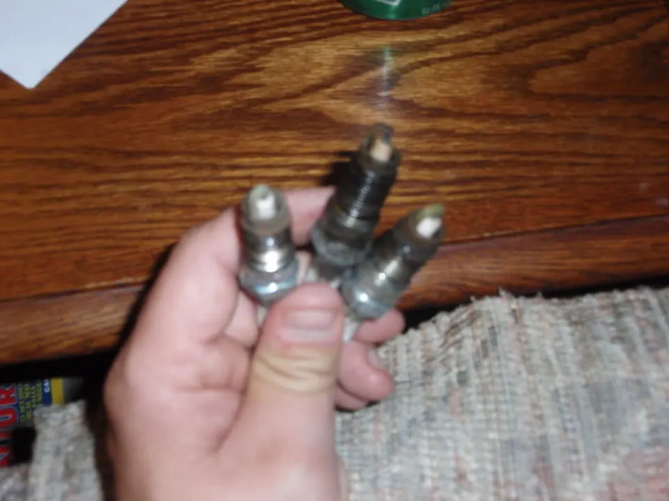

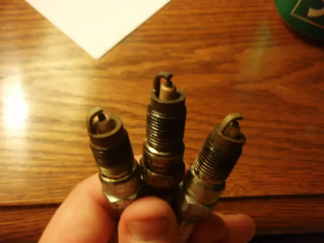

Here is what the plugs looked like that came out of the car tonight also.

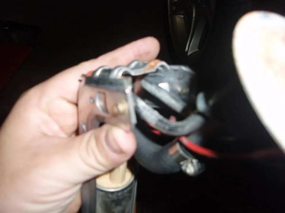

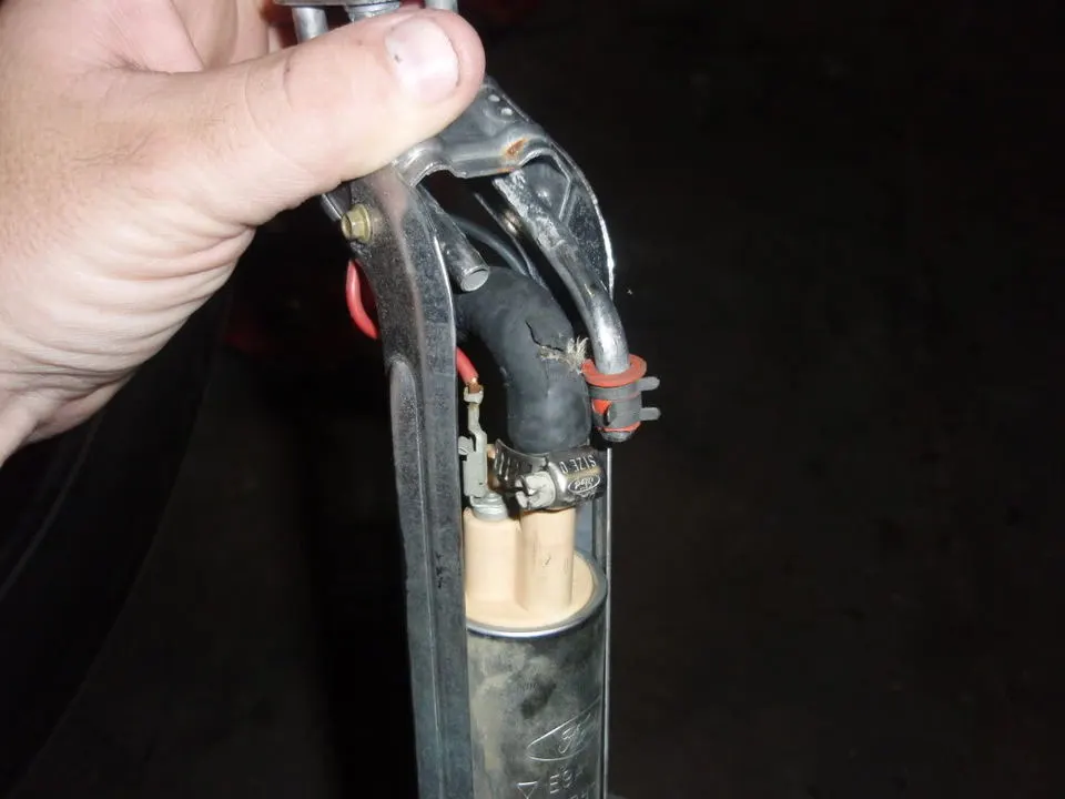

Got it figured out. Got a fuel pressure gauge hooked up and it only had 20 lbs. On the advice of a friend I dropped the fuel tank and pulled the pump. Here's what I found.
As you can see the damn hanger for the pump broke at some point and allowed the pump to "swing" on the lower mount by the rubber line from the pump to the metal lines. The return hard line must have rubbed the rubber feed line through and it allowed the pump to just pump the fuel right back into the tank rather than building pressure.
I had a spare mount and it had a Wal. pump in it already. I installed it in the tank and put it all back together only to find that the pump doesn't appear to be any good cause it wont run (yes it's plugged in). So tomorrow night I'll pull it back apart again and install the Ford pump that came out of the tank in the 1st place in the spare mount and call it done for NOW. I will still have to change to a better pump very soon and I'll be getting one from a friend very soon.

Code 87 – fuel pump primary circuit failure. The fuel pump lost power while the engine was running. Check fuel pump relay, check inertia switch, wiring to/from inertia switch, red wire going to inertia switch for +12volts. Check the other side of inertia switch for +12 volts.
Diagram of the fuel pump wiring for 86-90 cars
Diagram of the fuel pump wiring for 91-93 cars.
WOW thank you for all the info. I'm printing and saving it all so I can really learn it. So much to learn on the EFI systems. A far cry from my '65 stang
