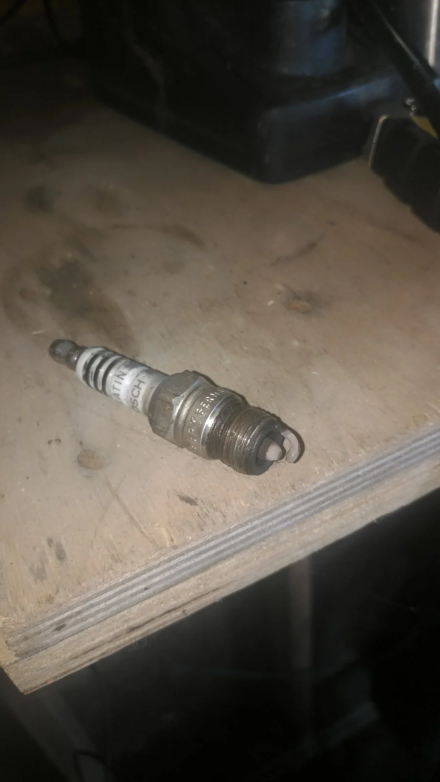

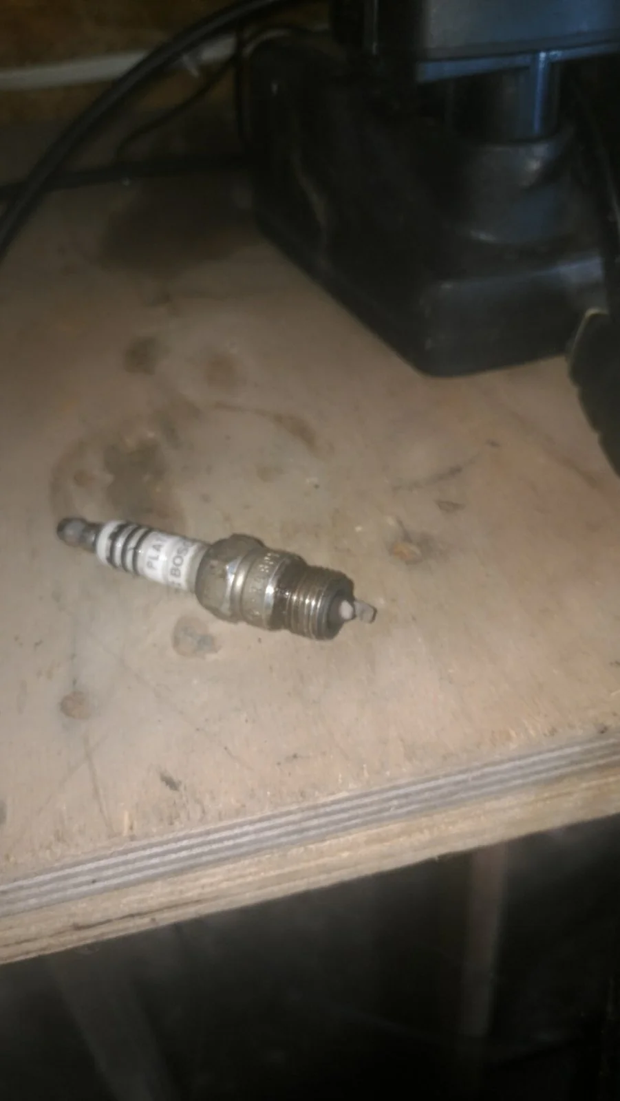

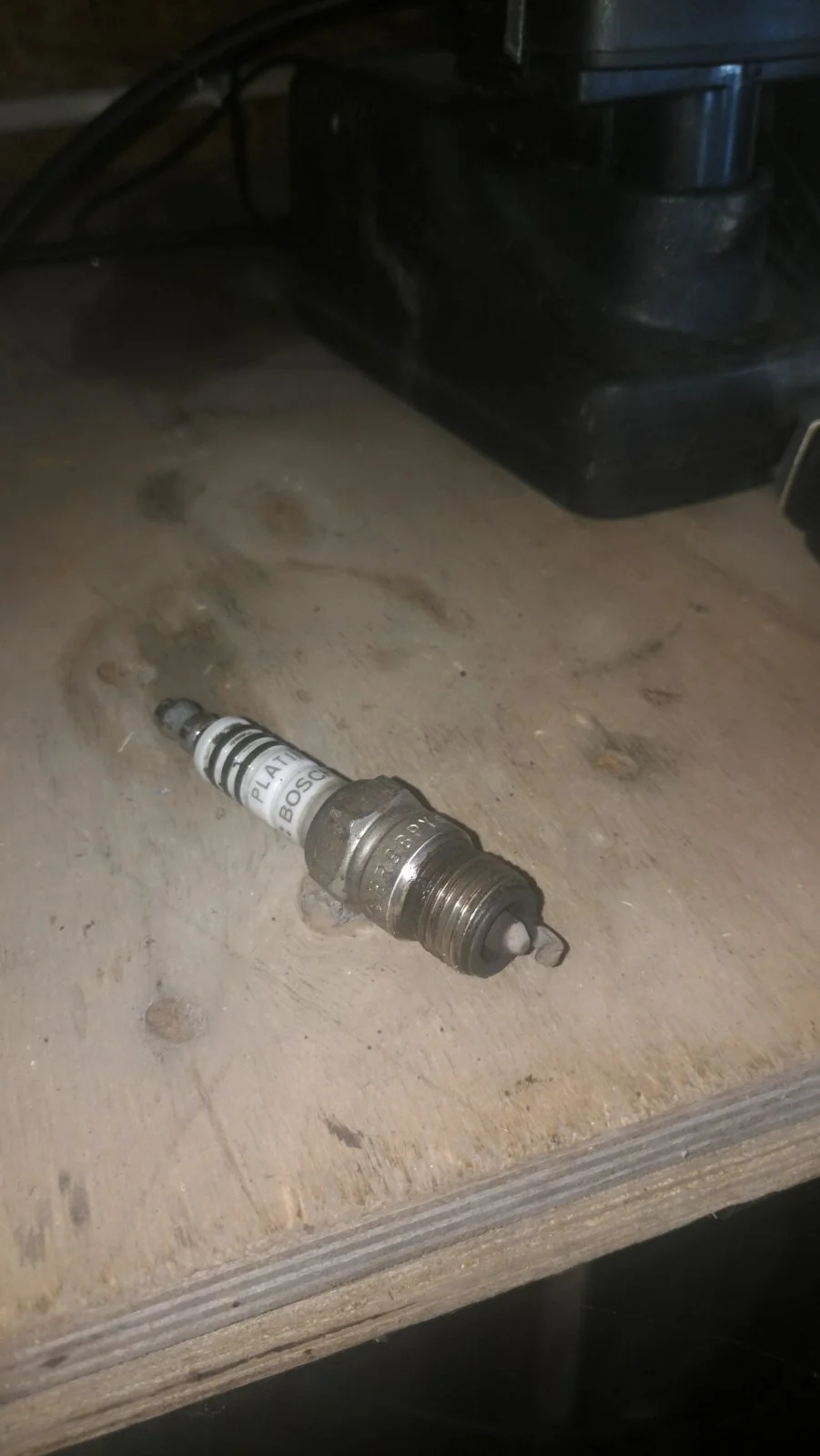

This pic is plug from back left of motor, #8 plug I belive
This is the first step in resolving your issue ( stock copper core plugs) make sure your timing is 10-12° and check for codes, there is a thread on checking codes in the 5.0 tech/how to forums, likely not any one thing is going to work.
