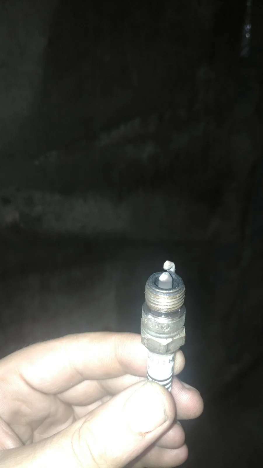

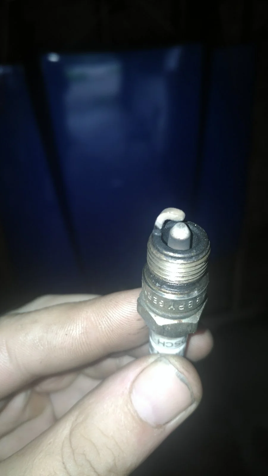

Hopefully this pic better

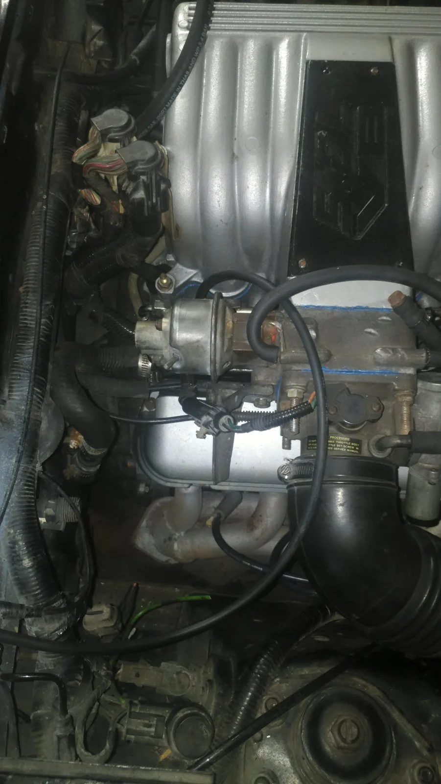

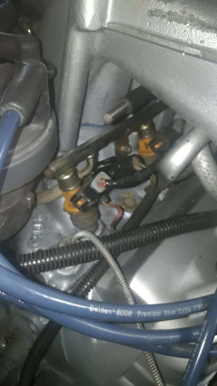

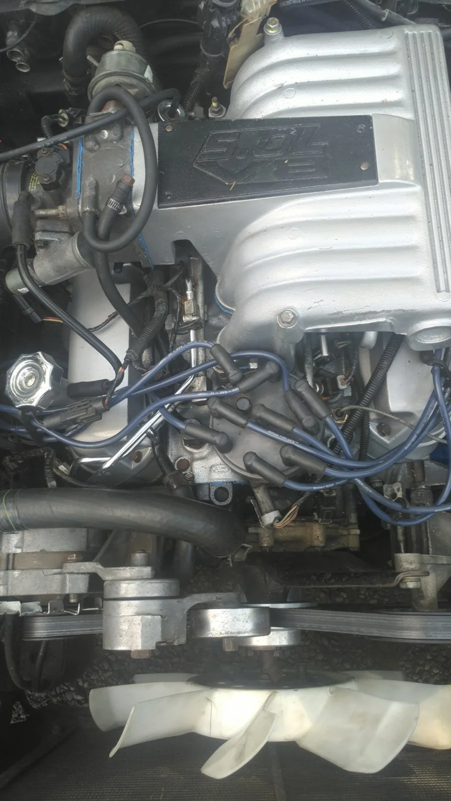

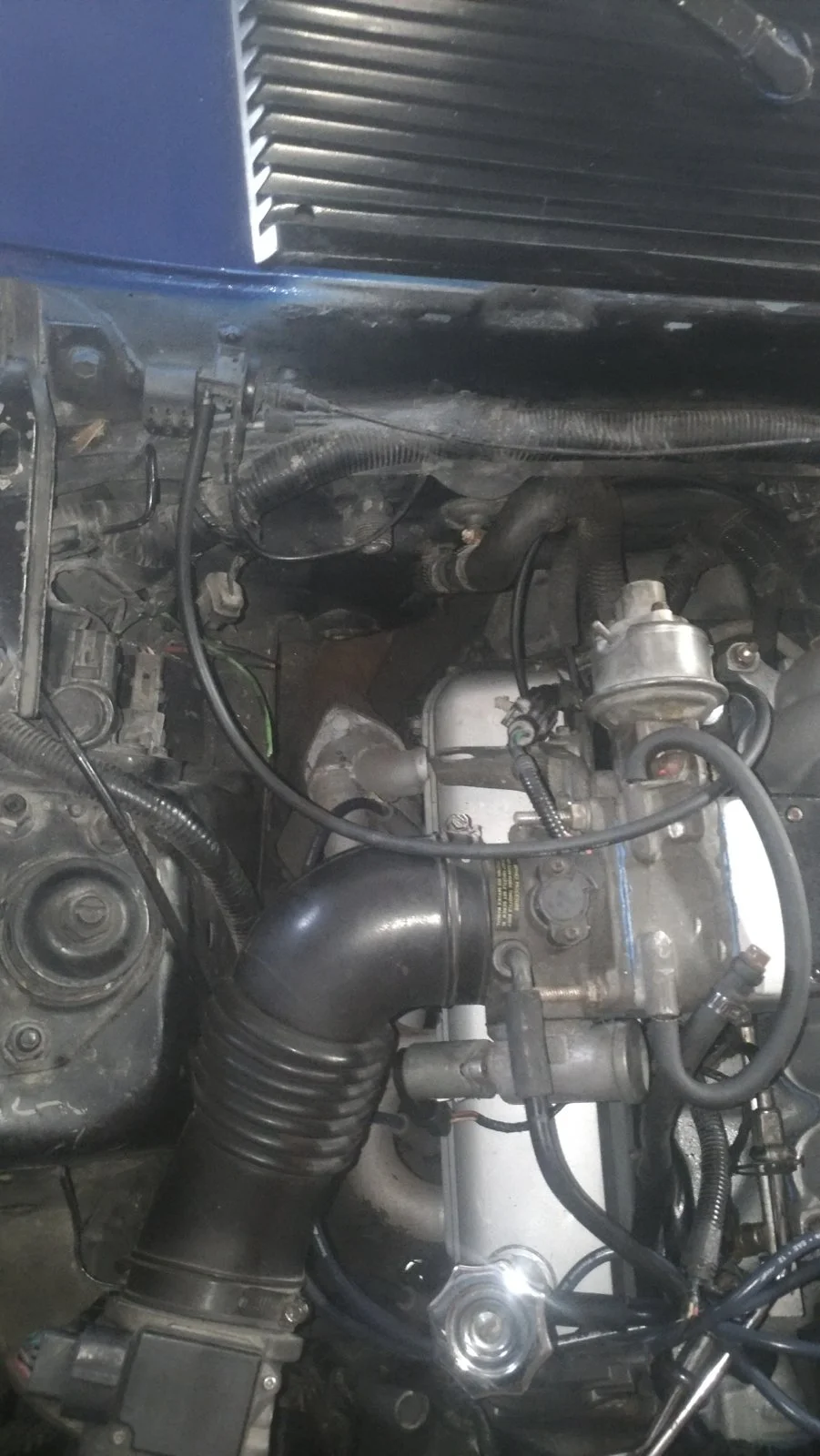

That's definitely running lean. So you confirm you are running 12 degrees initial base timing? What's your fuel pressure set at? You are running 19# injectors and a matched MAF?
Do you have pictures of the engine? Just want to see if something jumps out as being incorrect

Hopefully the pics look better then on my phone.

How do i yell if injectors are19# and if they match MAF.?

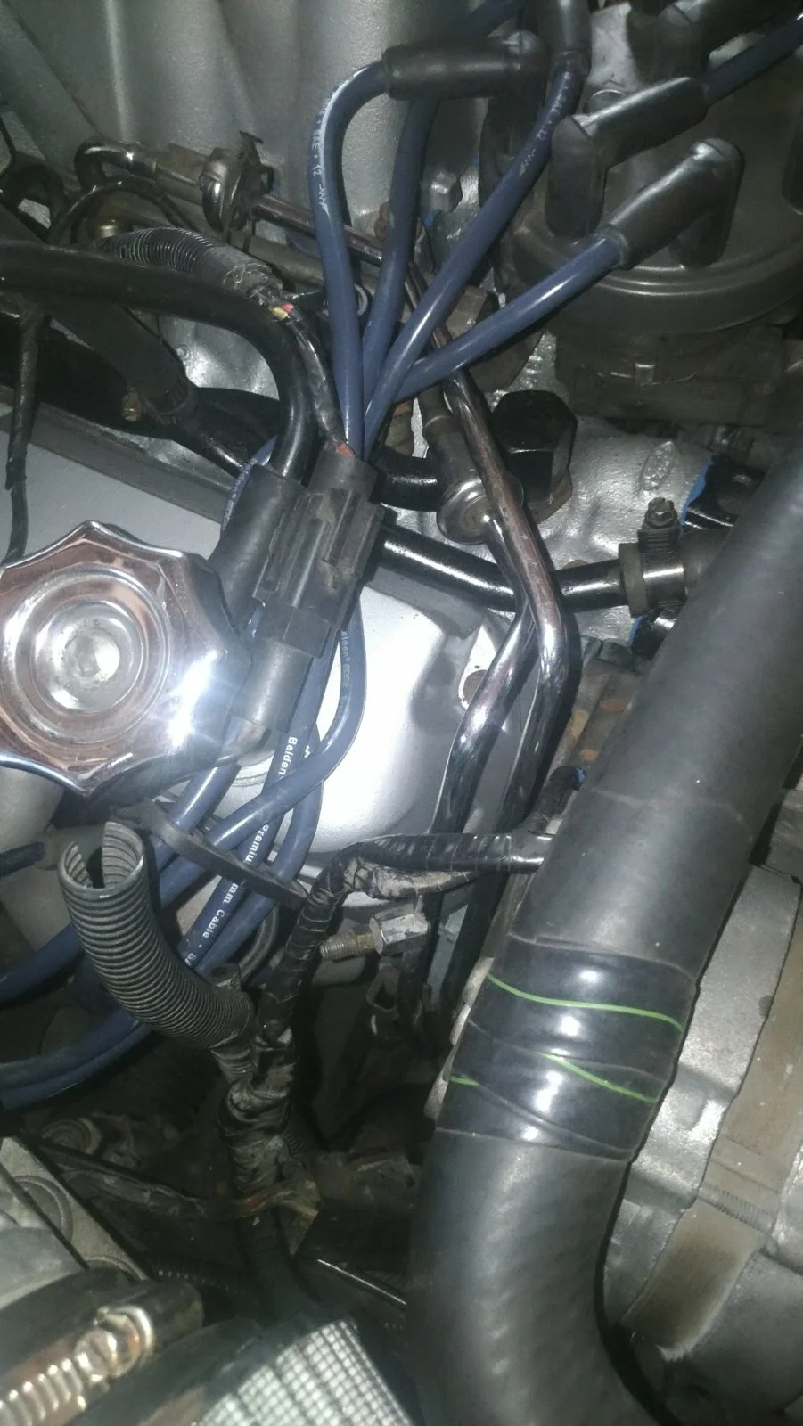

Yes those are the 19lb stock injectors https://www.stangnet.com/mustang-forums/threads/fuel-injector-colors.650606/#post-6298225
Can't see your distributor fully in the pics. Have you double checked the firing order?

If the foreign order was wrong wouldn't it idle rough?
