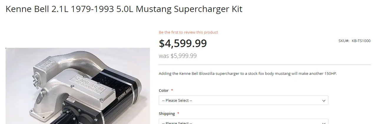

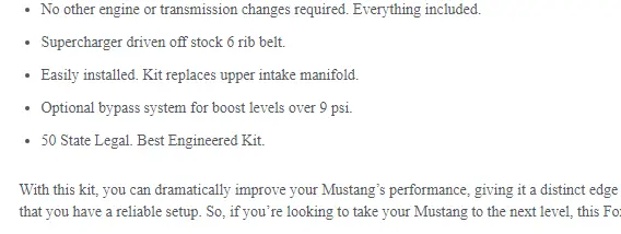

Ummm... You're kinda hosed. There's no CARB exemption for the 2.1L kit. It's considered a "tuner kit". The only one that had the exemption was the 1.5L kit.
With that, I'd run 60lb injectors and whatever chip tune was necessary to support it. There's got to be somebody in your area that can chip-tune an A9L.
The unit is TS1000 and is covered by EO- D-271-13
