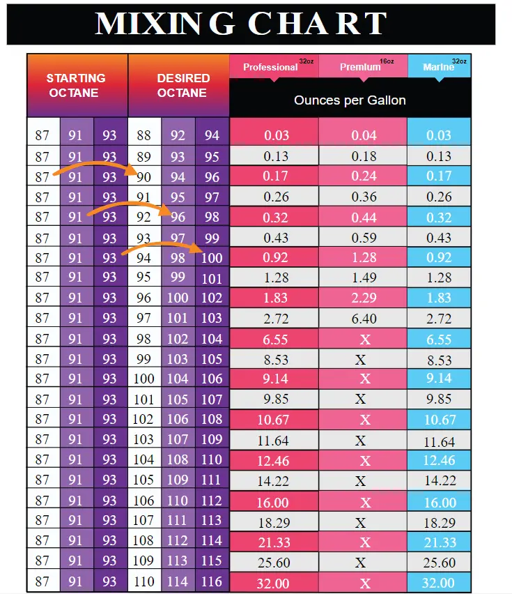

I remember having this conversation [years] ago and I thought this might help as General Heads Up. Note that other octane boosters will have different mix rates:
So for 91 to 93 Octane you would need 2.7 oz for 15 gallons.
For 87 to 93 octane you would need 8.85 oz for 15 gallons.
I've never used this product. It's what showed up in my search results.
