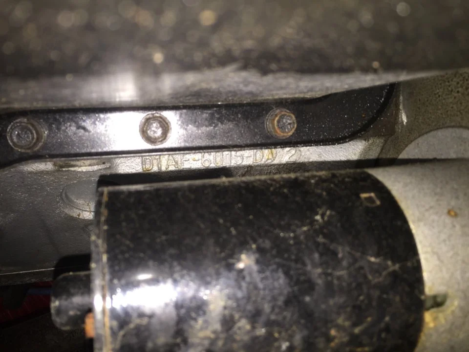

the motor is a 1974 block- anybody know where the numbers are so I can verify this. I know the f4te block number is in the lifter valley for roller blocks. but I don't really know where else the numbers are for other ones.

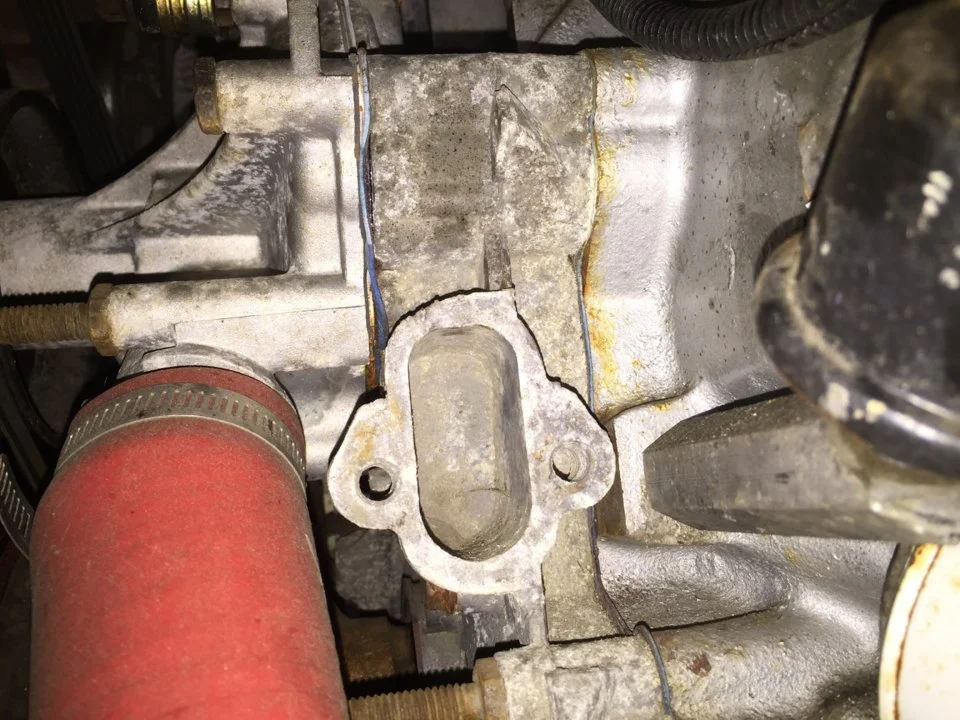

I plan on running a mechanical fuel pump. my timing cover looks like an older version because it already has the threaded holes for the pump. if you look in the hole where the pump lever would go it is blocked off. can I just take the timing cover off and dremel out the opening? it isn't a block off plate but it is blocked off when it was casted it looked like.

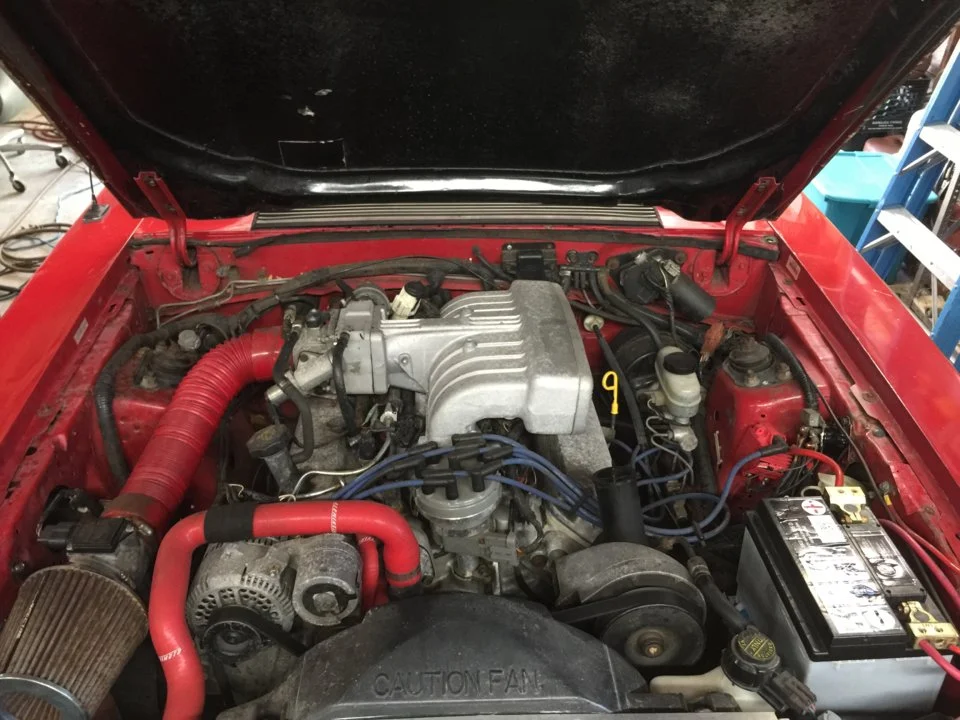

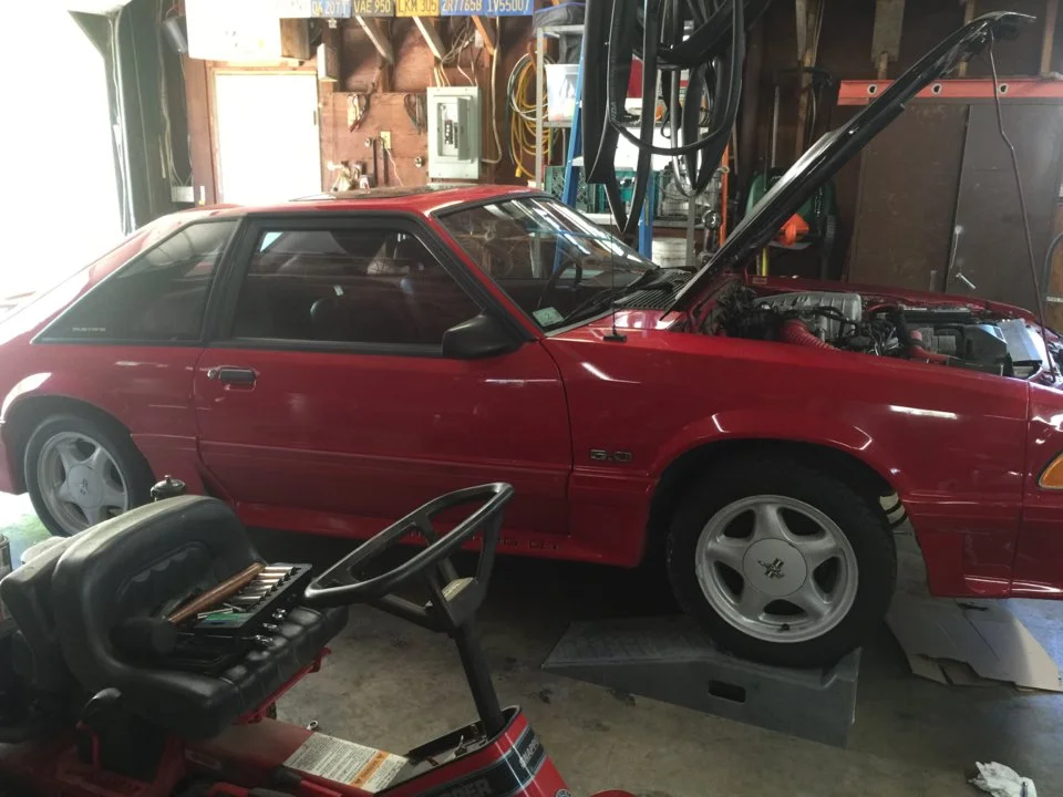

everyone loves pics. here's the poor car

You will not want a mechanical fuel pump... dremeling the hole open is not the answer either as it is not likely that there is a fuel pump eccentric on the cam gear.
i can easily by a fuel pump ecenntric for 41 dollars.
i can also get the right timing cover for 80 but figured if i had to take this one off anyways why not machine out that opening and reuse it.
this is what is looks like
turns out the motor is a 71. now i can ordee timing cober gaskets and stuff to get the front of the motor ready for the carb swap.

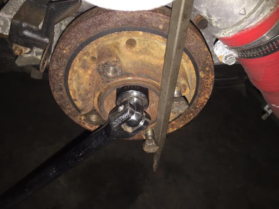

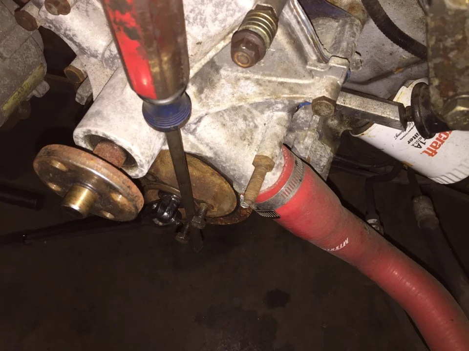

i got most of the front stuff off the car today like the fan, shroud, pulleys, and balancer. not really sure how most people usually get the crank bolt out but i wish i did it when the belt was still on. this was my solution which worked well.
just need to drain the coolant take the pointer and smog bracket that attaches to the timing cover off and then all the timing cover bolts. hopefully it pops right off. i dont plan on taking the water pump off the timing cover so i wont have to replace that gasket. once i see if there is a cam ecentric on it or not i will order all my parts.
i am going to stick with the mechanical pump for now. if i dont like it i can always just use the block off plate and go the electric route

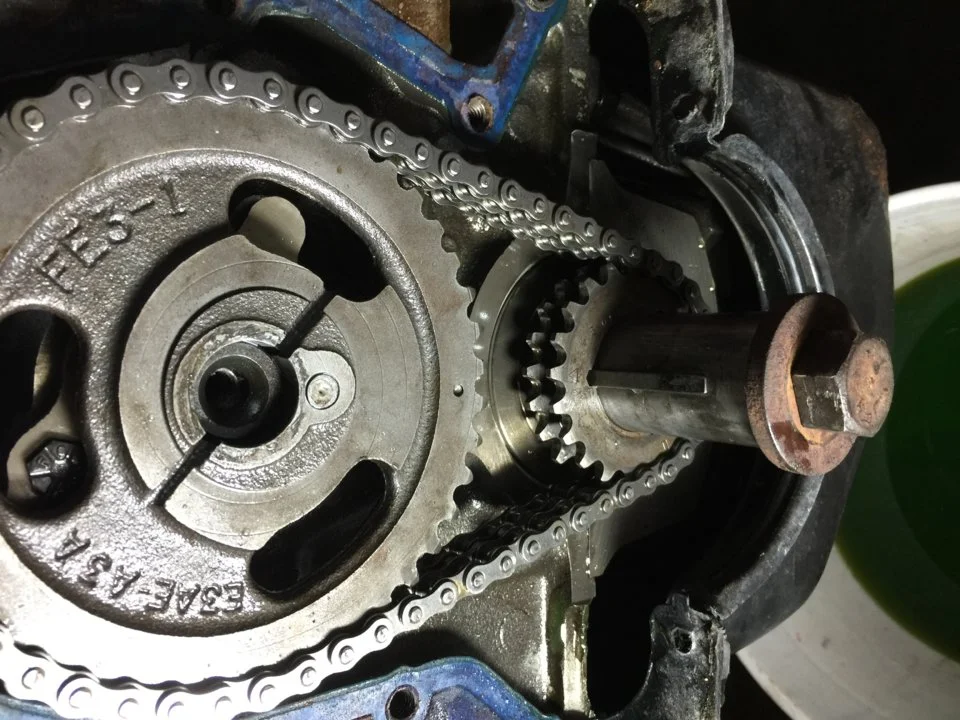

have my first assmebly question about the cam eccentric. i thought the tab would go in where there is a pin. am i wrong or does that pin need to come out. doesnt make much sense since that locates the timing gear
At the risk of sounding rude, this whole gyration of making the fuel pump eccentric work would have been eliminated if you used an electric pump? :shrug:
