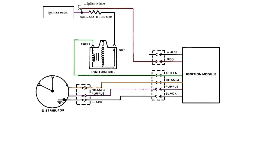

been researching my dizzy options and just keep getting more confused. advanced auto parts and autozone both have dizzys but they don't really say if they are a duraspark II version or not. same deal with the ignition module. if by chance i happen to figure it out i would still need to find the duraspark II wiring harness.

Duraspark boxes are easy to wire even without the harness,
Get a blue tab box from an 85 Mustang GT 5 speed
-Red goes to keyed power (ie coil +)
-Green goes to coil -
-Orange, purple, and black go to the orange, purple and black on the distributor.
-Don't worry about the white wire, its for ignition retard during cranking which you probably won't need. I tried to use it a couple of times but it doesn't seem to work right, at least not with aftermarket duraspark modules.
You can also use an MSD or other Ignition box with the Duraspark distributor. Even a GM module if you so choose.
Wiring the Duraspark:
good info v8stang, that seems super simply to wire up.

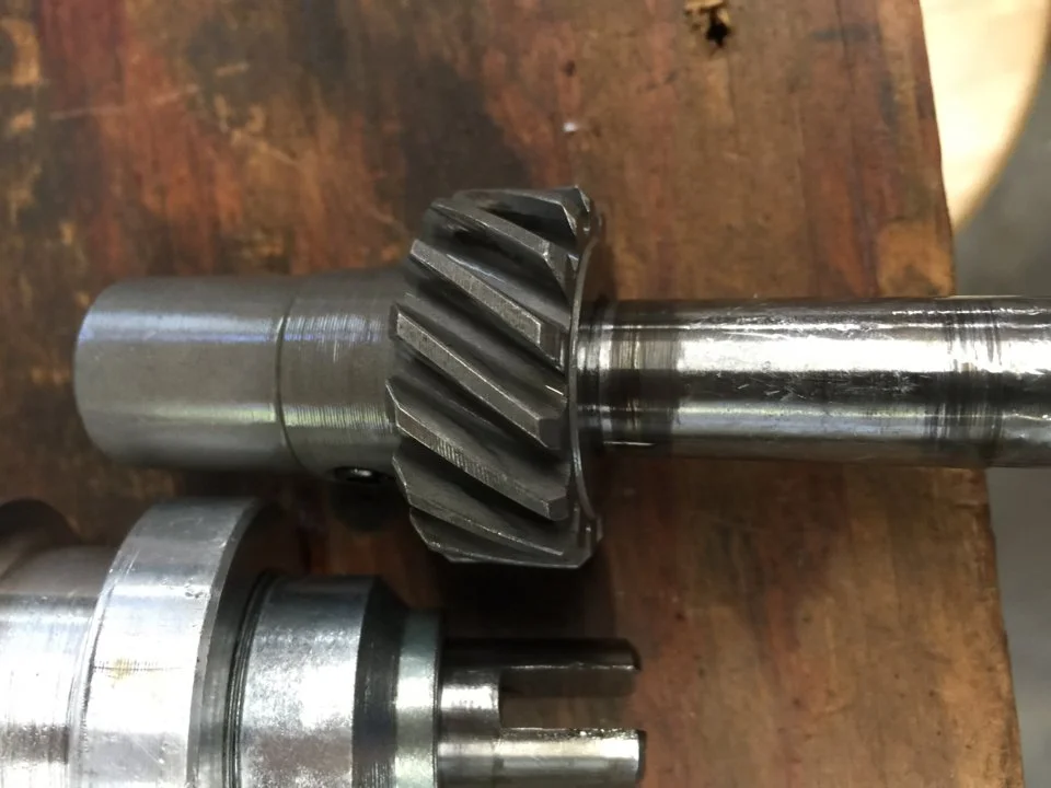

I ordered all of the ignition type stuff. dist, module, cap, rotor, and two pieces of the wiring harness that they had on advance autoparts. if I don't need them i will just return them to the store. I am still unsure of what type of material my dist gear is. can i just put this same dist gear on the new one when i get it?
Hard to tell for sure, but that looks like a steel gear. Check the teeth on the camshaft gear to make sure it isn't worn. A steel dist gear with a flat tappet cam will wear the cam, where a cast dist gear with a roller cam will wear the gear.
You should be good to use the gear that comes with the new distributor. It should come with a cast gear for use with a flat tappet cam.
I went on the compcams website and obviously nowadays you can never find a number to call anybody. but I was able to ask my question in there forum and get a reply back from a tech. he told me the material on the cam gear is cast iron. so hopefully my new dizzy comes with that and I will be one step closer
why are there so many different materials anyways. if everyone just makes dizzy gears and cam gears out of cast then there would never be any confusion. seems silly that there are so many options. plus the fact that if I needed a new gear it would cost probably as much as my distributor did.
