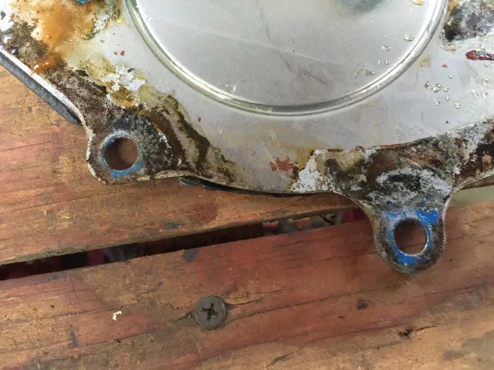

reason for the no coolant is i tried to fill it back up and it started leaking between the plate and pump again. the plate and pump surfaces are clean but still are old and dont seem very even. i am going to get a new pump and put some coolant in before i do anymore starting of the car.

took the water pump off again and i can see why it keeps leaking. the plate has some corrosion on it but has a nice open channel which is exactly where is drips from. went to the parts store and bought a new one.

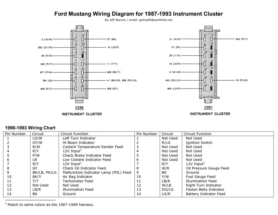

Factory gauges are grounded through the interior harness not the injector harness that you removed . It is still good to add that ground strap back in though . Here's the wiring diagram for the dash plugs .this will make it easy to tap into the wires you need to make the stock oil pressure and temp work if that's what you want . The tach you made need an adapter to make that work with the dist you run now I believe .
Awesome chart. I am pretty sure for my tach I just need to run the tach feed wire to the negative side of my coil. Are those the two connectors that plug into the back of the gauge cluster. I have had it out before but I never really paid attention to what the connections looks like.
Correct that they are figure it would aid in running stock temp and oil pressure if that was what you wanted to do

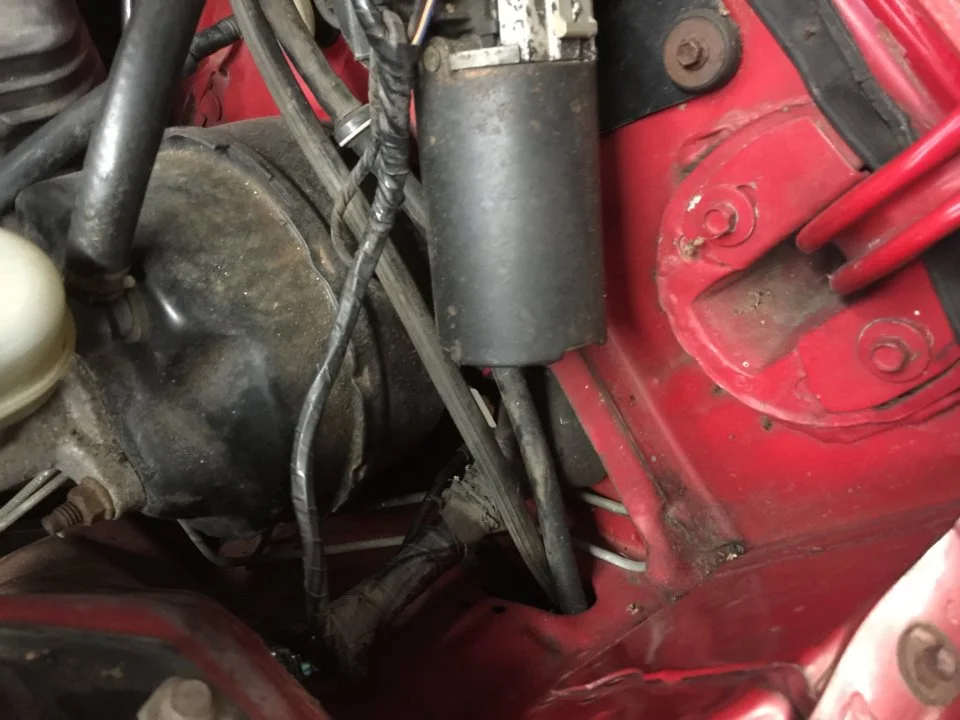

do you guys know which way or where the two bundles of wires that plug into the gauge cluster run from and too. really only need to splice into them somewhere and there is no point in pulling the gauge cluster i think because that wont help me. do they run under the dash somewhere at a point that i can see them? what a out the bundle of wires that come out near the brake booster firewall? is that the same set of wires?
They come out of those plugs on the driver side fire wall under the hood that the original harness plugs into .

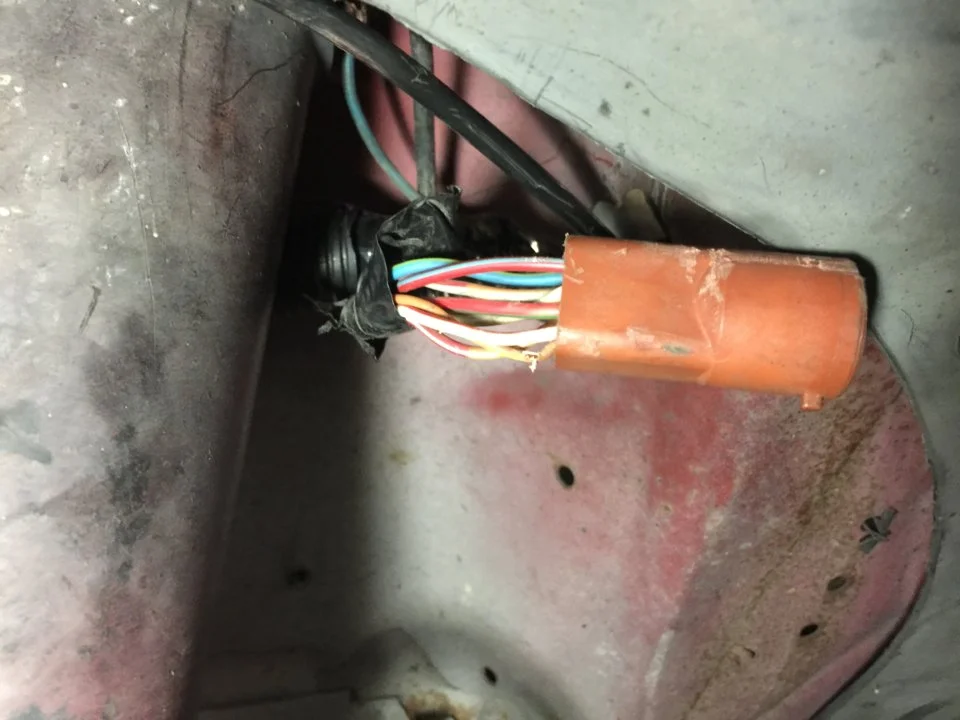

i think i figured out why i can't find those two plugs. I have another 89 mustang that is pretty much stock that i took a look at. clear as day the black and grey plugs are there.

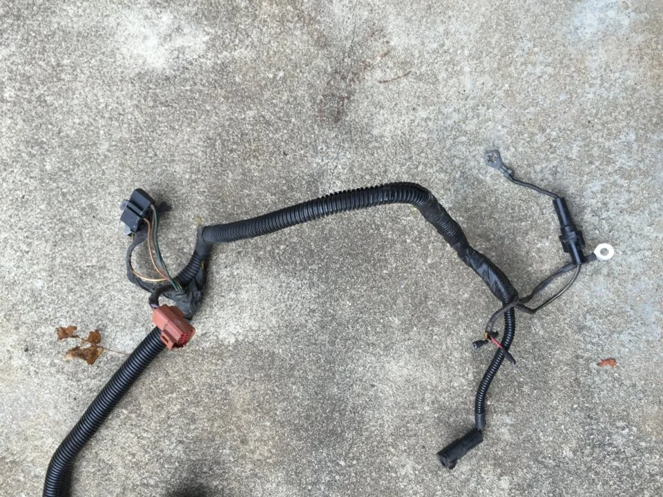

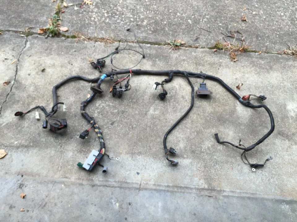

I then went back to my 92gt and all i can see is this one red plug. i also included some pics of the harness that i sold of the car and you can see the single red plug on that one as well. So it looks like i need to find a specific wiring diagram for an engine harness that only has the single red plug.

here is my stupid idea after a little research. If you ground the wire that the temp sensor goes to the gauge should be pegged. it is a way of testing to see if the gauge works. You only need to do it for a quick second because you don't want to burnout the gauge. if there are only 8 possible wires it could be on that red connector then I am just going to put a jumper wire on it and ground each one and hopefully one of those wires pegs the temp gauge and another will peg the oil pressure gauge.
I still don't know how I am going to figure out which wire is the tach. the only silly idea I can think of is after I know that 2 of the 8 are taken with the other gauges I could run a long wire from the negative side of the coil and just touch each wire until the tach jumps.
all of the wiring diagrams I have seen are all the two connector wiring harness not the single red connector one.

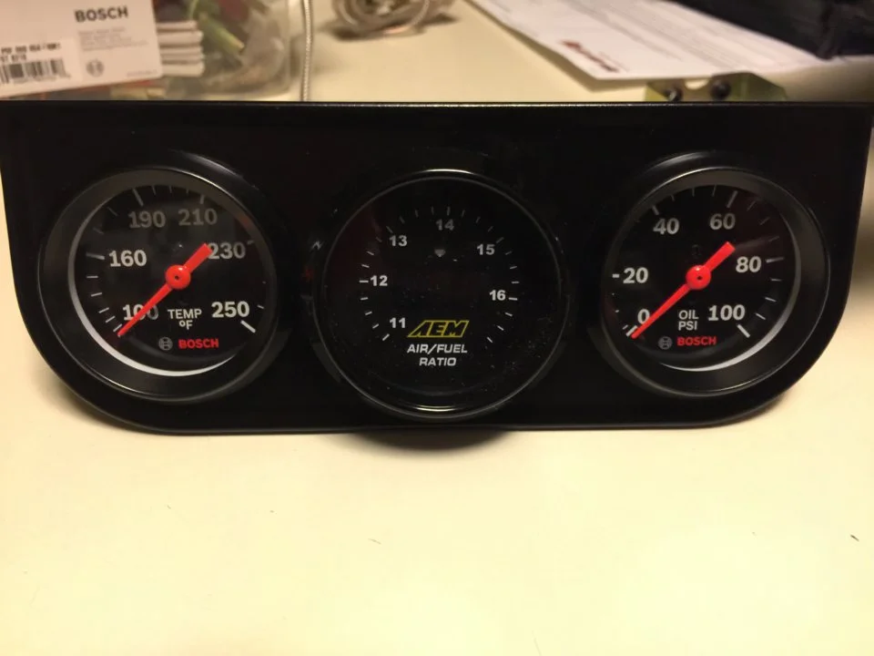

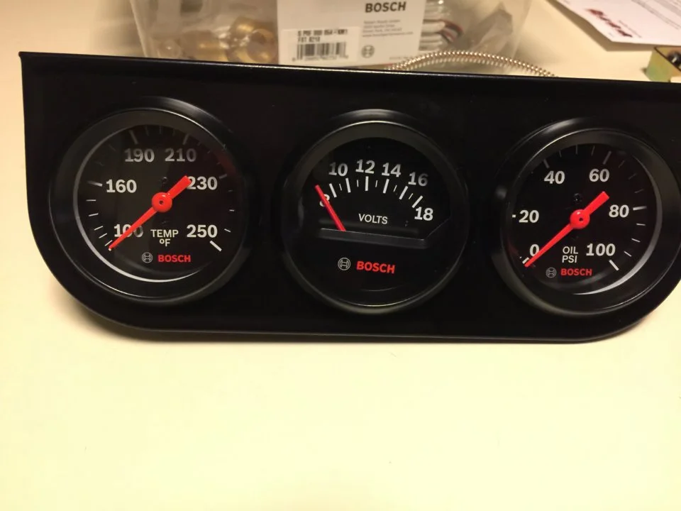

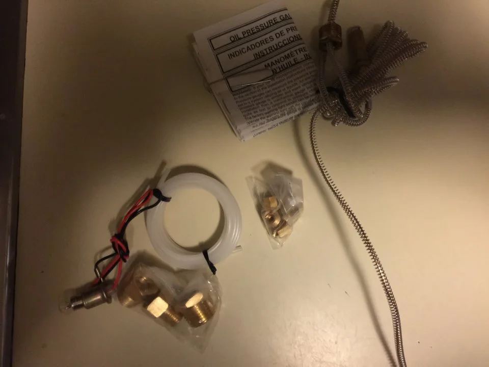

i ended up going to advance autoparts amd getting a neat lottle triple gauge pod thing they had. it was only 39 bucks plus i had a 20 dollar coupon off a 40 dollar purchase.
i ended up getting rid of the volt meter and putting my air fuel gauge in the middle. for a little over twenty bucks including the ground strap i bought it is a pretty good deal.
the triple setup sits nicely under the radio. with a little work it should look alright
the setup even comes with all the different settings to connect the oil pressure and water temp.
