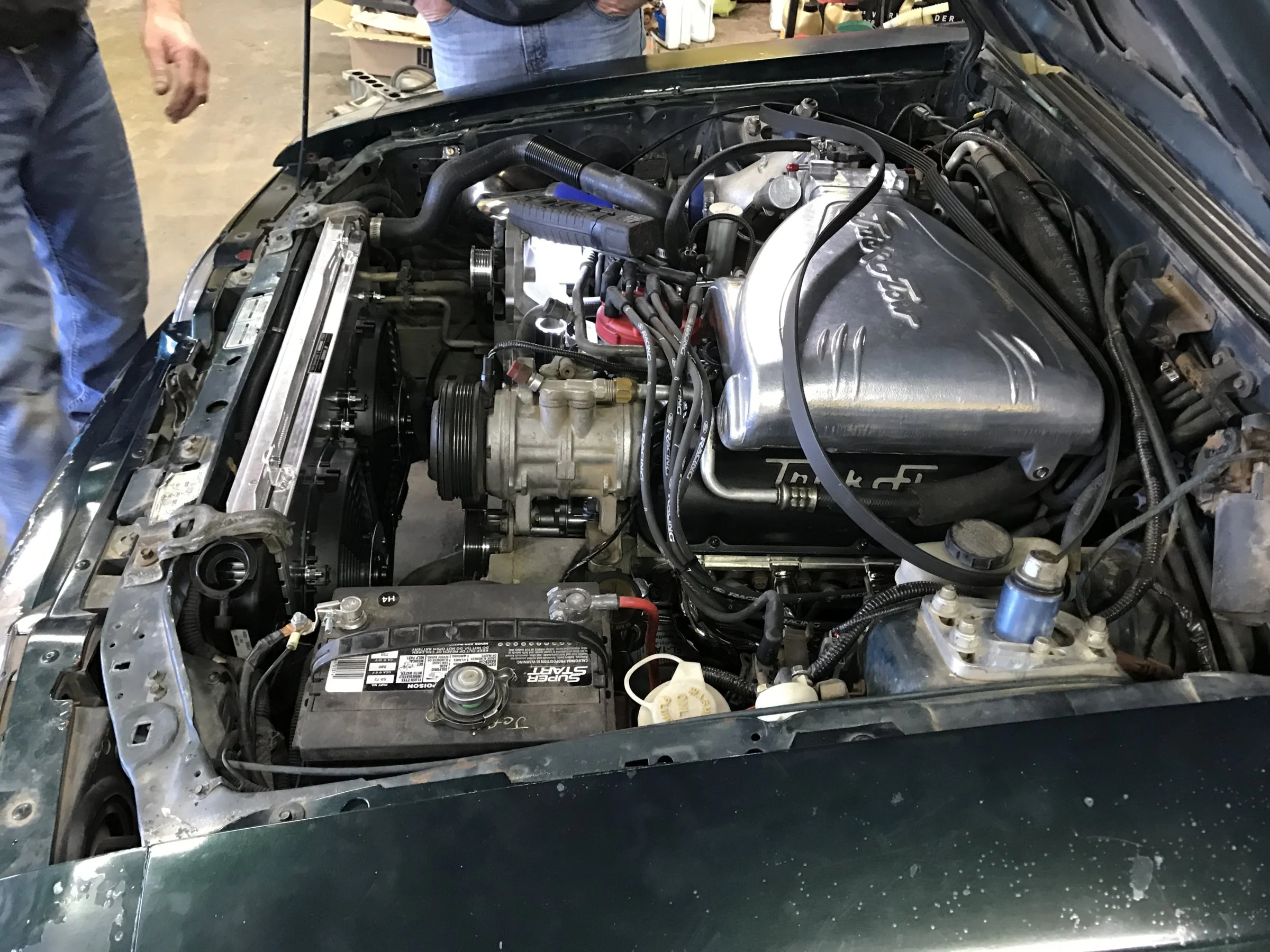

Need help guys I've had this car for 2 years dump crazy $$$ still popping out intake hesitation cold and warm things I've changed
New motor bought a turn key throttle body to oil pan
Map sensor
Ford racing multi port racing harness
New o2s
New coil
Mass came with motor
Acts just like it did with old motor just worst
And it sometimes drivers great than starts popping. Drove it today on the interstate and running good than started popping and loosing power slowing down I have to floor it to get to go, but sometimes it runs great
And it sometimes drivers great than starts popping. Drove it today on the interstate and running good than started popping and loosing power slowing down I have to floor it to get to go, but sometimes it runs great. The fuel pressure is at 34 disconnected and plugged 29 connected I've never had the tank dropped that's about the only thing not new
It's a mustang sorry forgot to mention that

Well we can rule out the engine, I looks to good to be pop'n.
Have you run the codes?
Fuel pressure looks a little low, I think it should be 40+ unpluged and around 30 to 35 plugged in.
Check fuel pressure, give it a good quick rev with vac line attached and see if it goes up.

Ok did that it accurately goes down a little bit I'm thinking it's gotta be somewhere in the fuel I got a new tank I ordered awhile back. Think I'm going to order a pump and sending unit since my gauge is off a bit. Thank y'all for any help this car has been such a pain in the butt

Why don't you give us an accurate run down of what you started with and what you've done to it, sounds like your just not diagnosing the problem and/or throwing parts at it hoping to fix it.

Few things:
1.Pull the codes
2. You mentioned new harnesses, did you by chance change your O2 sensor harness? Like for going long tubes to shorties or vice versa? A mismatch auto/manual O2 harness caused a similar problem on mine.
3. Is the Maf matched to injectors?
4. Oh pull the codes
5. Inspect for a loose rocker... if it is loose it can not close the valves properly allowing popping thru the intake.
6. Inspect the mass air sensor and clean it with mass air cleaner.
7. When all else fails pull the codes and we can help.
