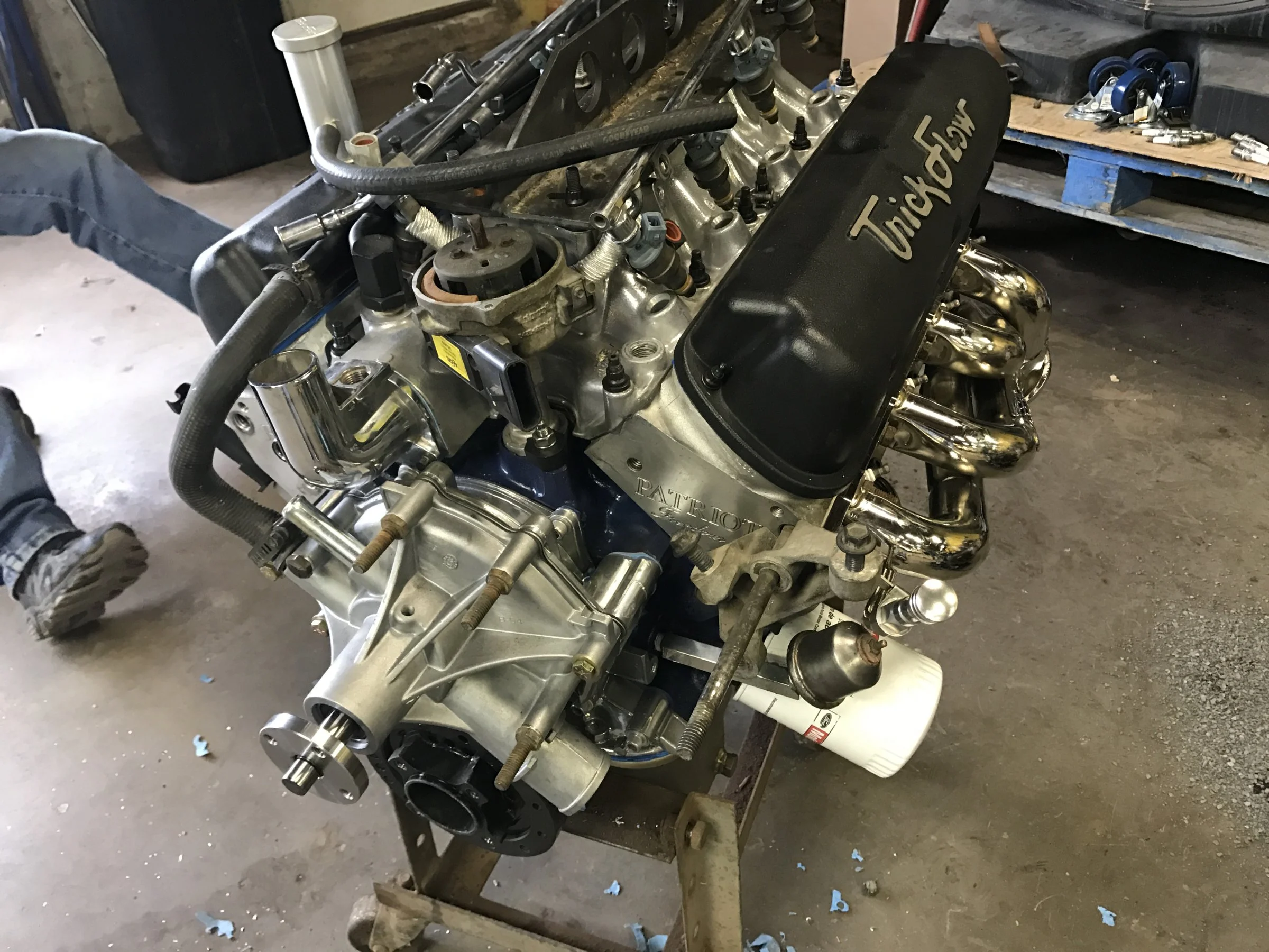

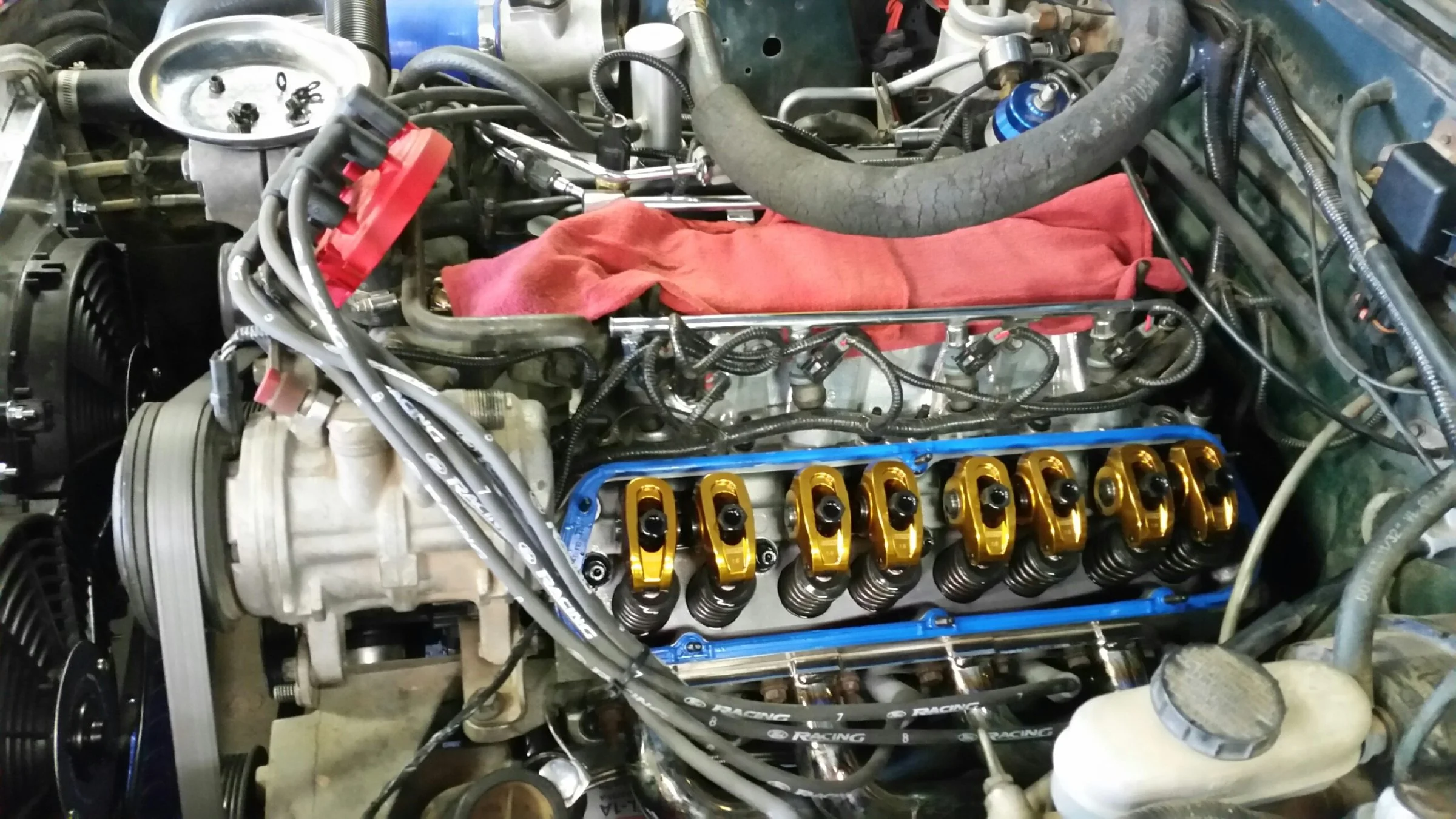

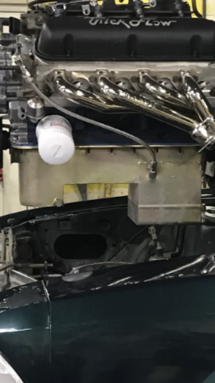

Pictures of the engine and parts I need detail in order to help you.

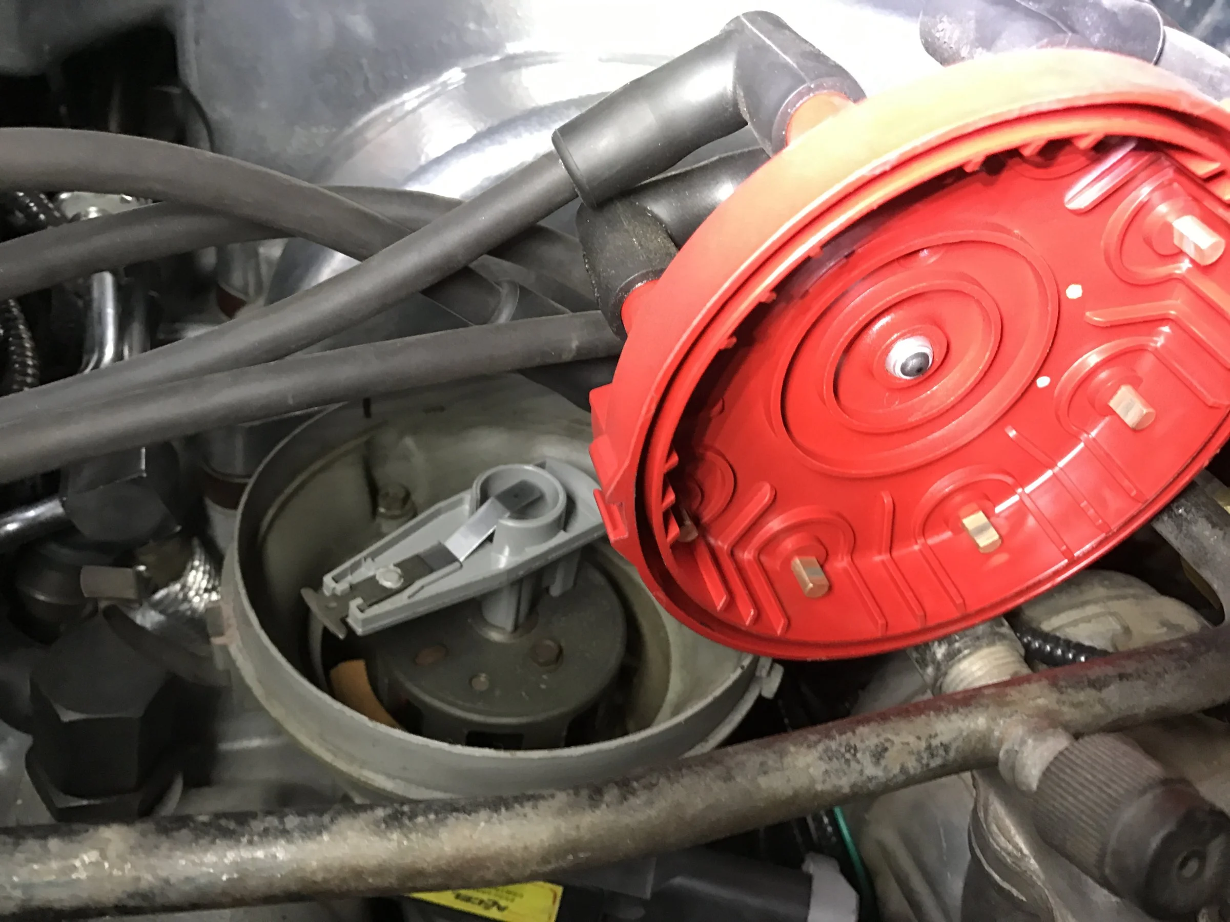

Take the cap off the distributor, look at the terminals that the rotor sends spark too...
Are they made of brass or aluminum? Is there any carbon tracking on the underside of the cap?

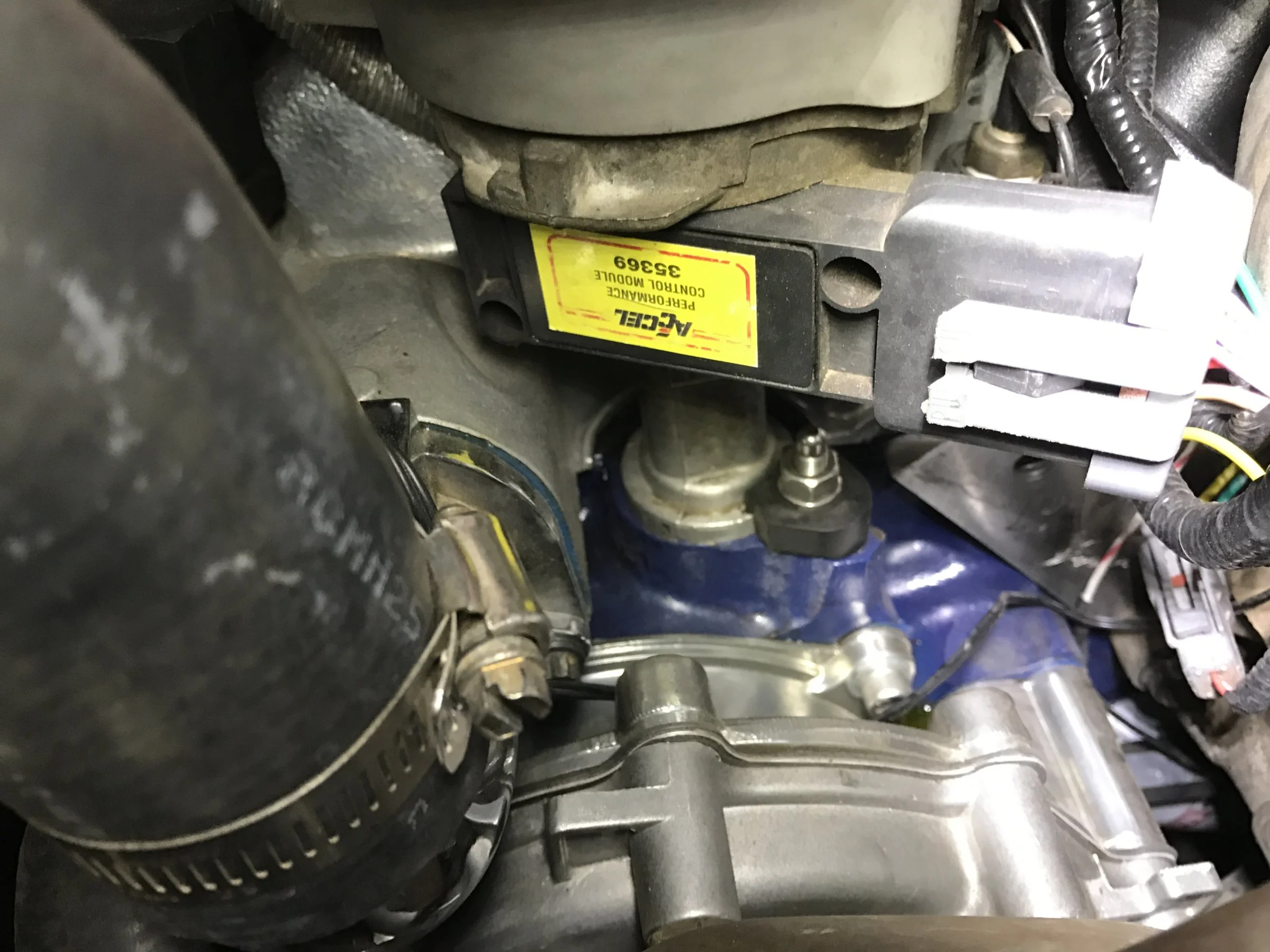

Oh my..... is that a black tfi module? That's no good..... the fox EEC uses a "push to start" tfi....
The grey is the fox module
Black is used later on with obd2 ecu, they are ccd tfi... (computer controlled dwell)
