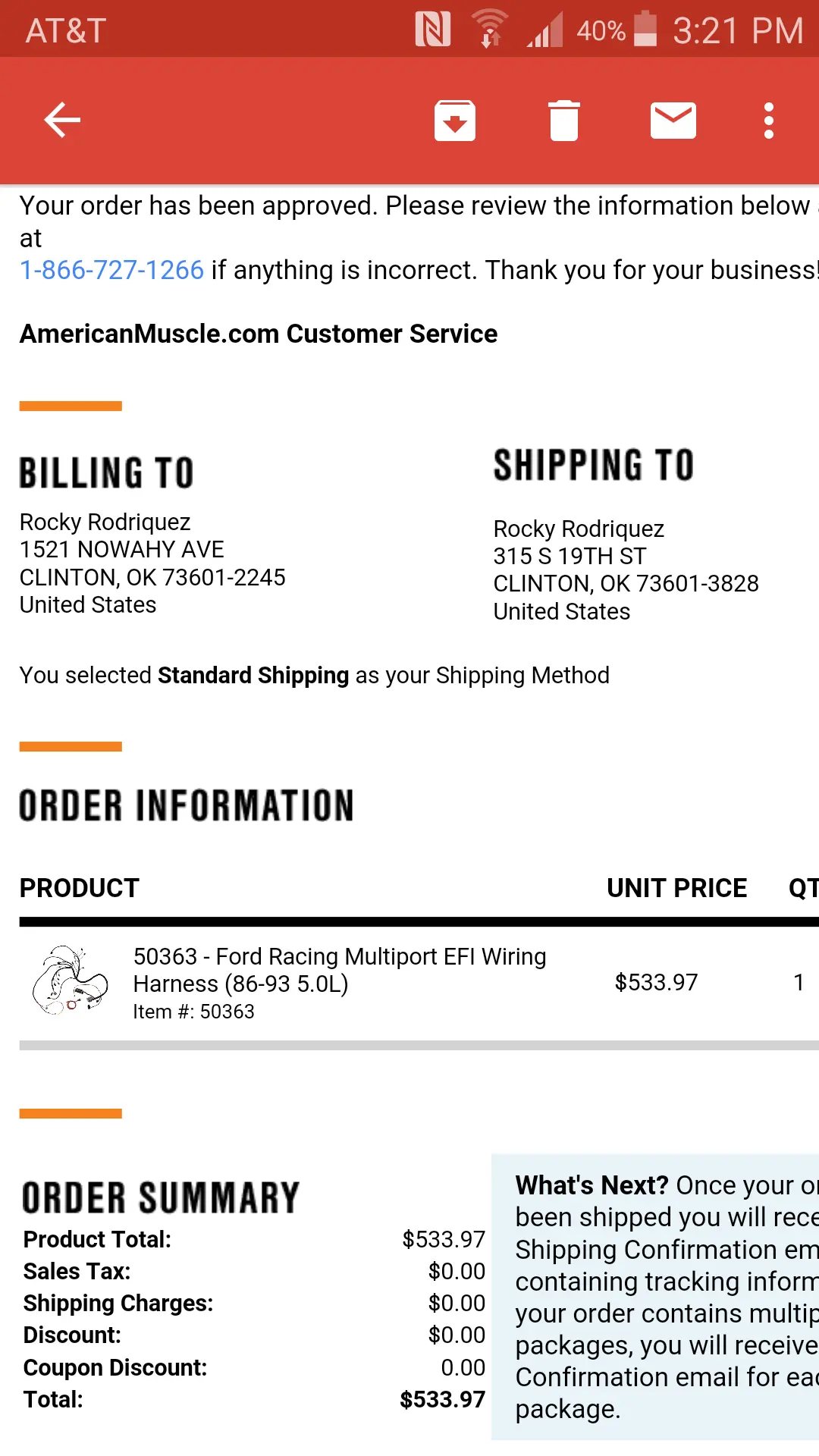

Ford racing harness but the same codes came up with the old harness that's when I replaced the o2 sensors
