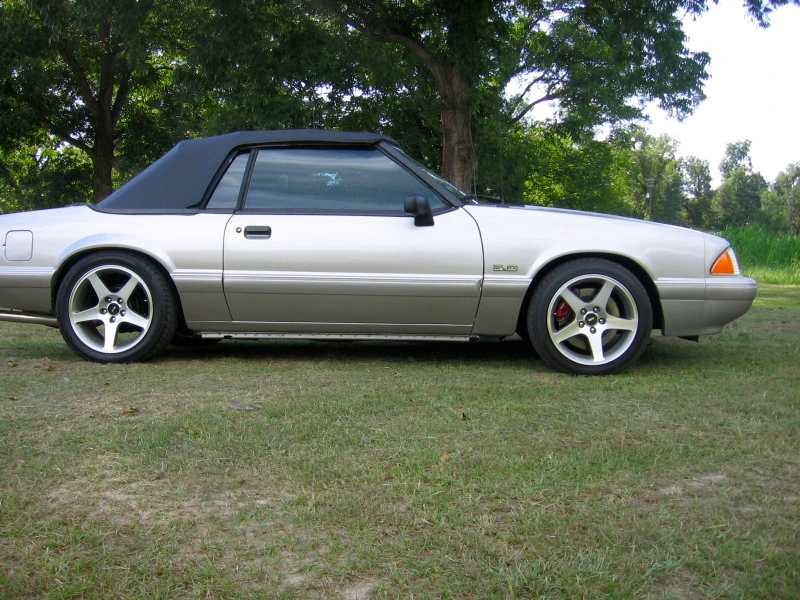

there were plenty of white cars with the red stripe in The moulding , black cars to / I've also seen grey gt with the blue moulding as well

i believe riverArt on here had a grey and titanium gt with the blue stripe and I have seen others the same way
