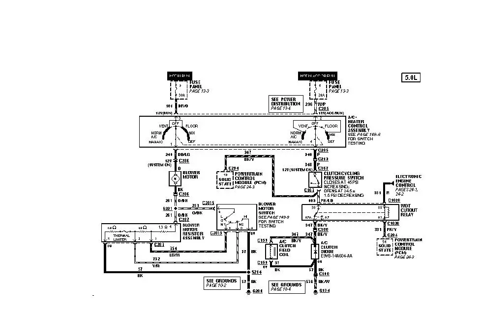

Appears to me you may have two problems. The first thing I would do is fix the fan speed problem, check for power at the blower motor, with the switch on high, then run a jump wire (12 volts) to the blower, it should blow fast, see where your air is coming out at,
Sounds like you need a blower motor resistor... or the plug at the fan is loose or making a bad connection.

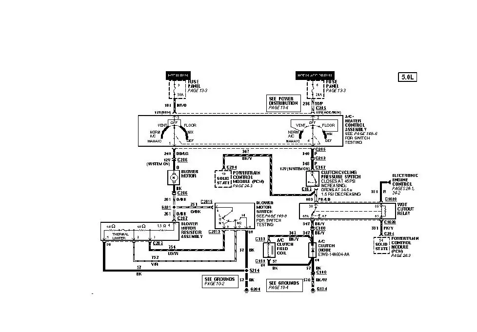

Here's the heater wiring diagram for your 92 Mustang.
Pigtail repair kits are available at most auto parts stores for damaged connectors. The hard part will be getting the parts counter person to look them up correctly.
