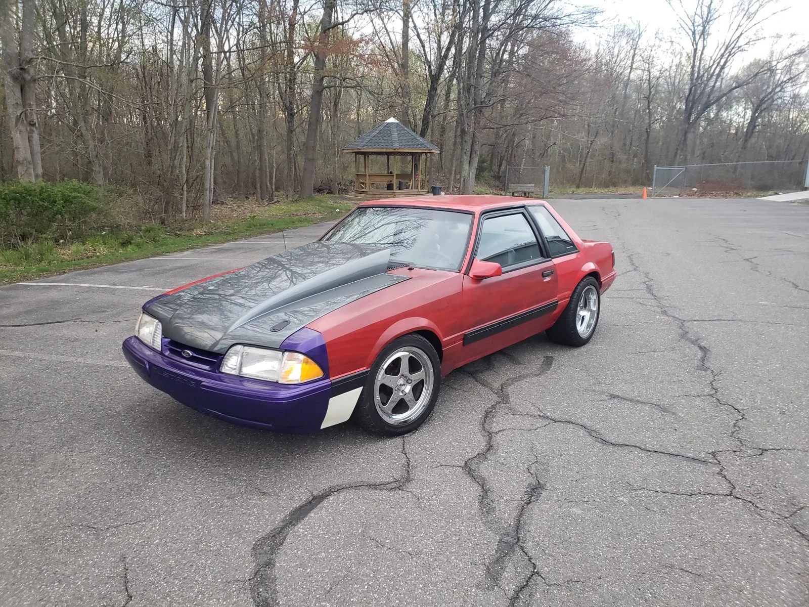

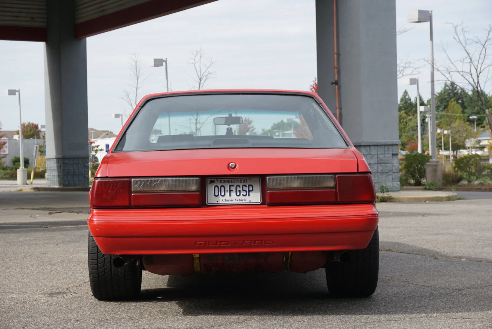

Its red, keep it the same.
Only 50% of it is red at this point lol, but that was my original thinking to keep it red mainly because I think redoing the door jams would be difficult.
You would have to pull all the body panels off. Fenders, doors, hatch bumpers to do the jambs. Then, what about your engine bay? Pulling the engine? Red is a cool color, I would keep it red.

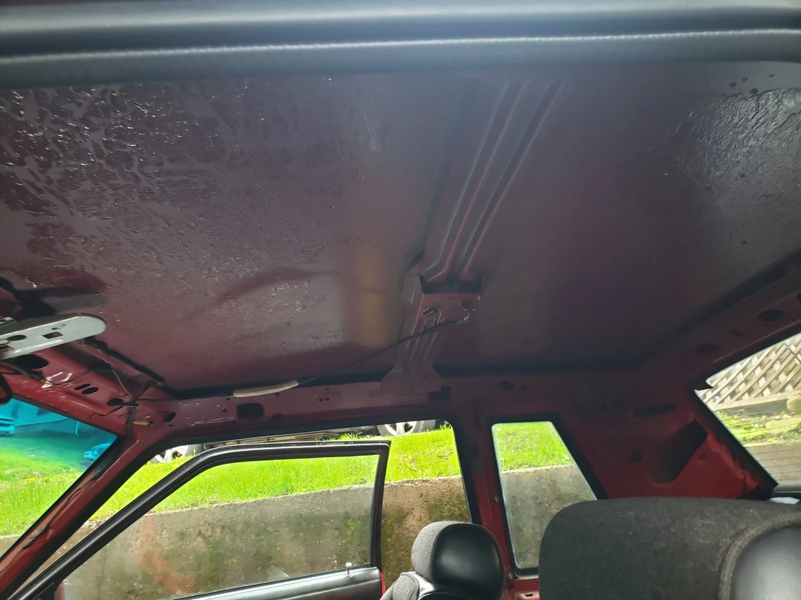

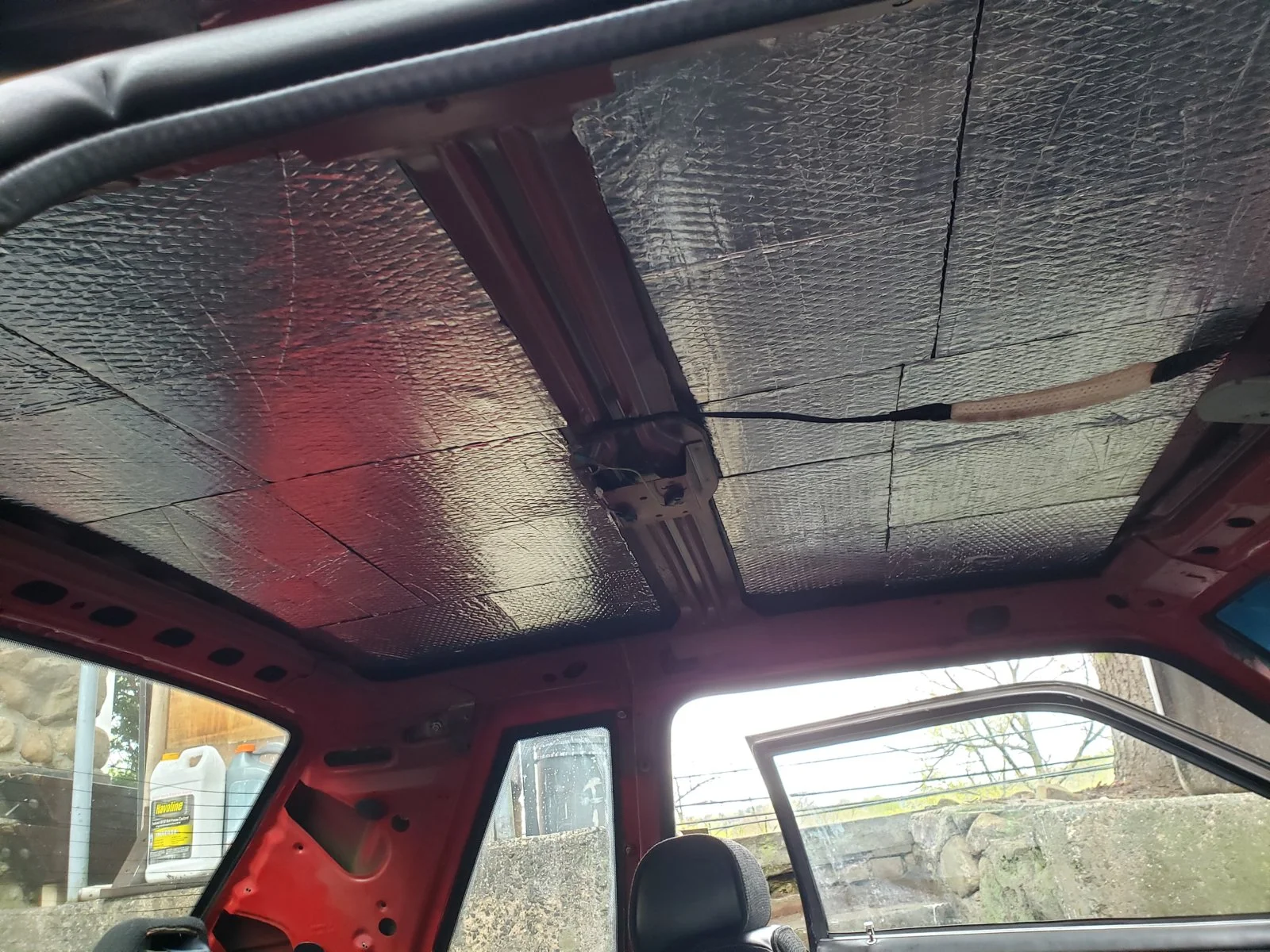

Was tired of my roof sounding like a tin can. Bought some Noico on Amazon and it was worth it.
