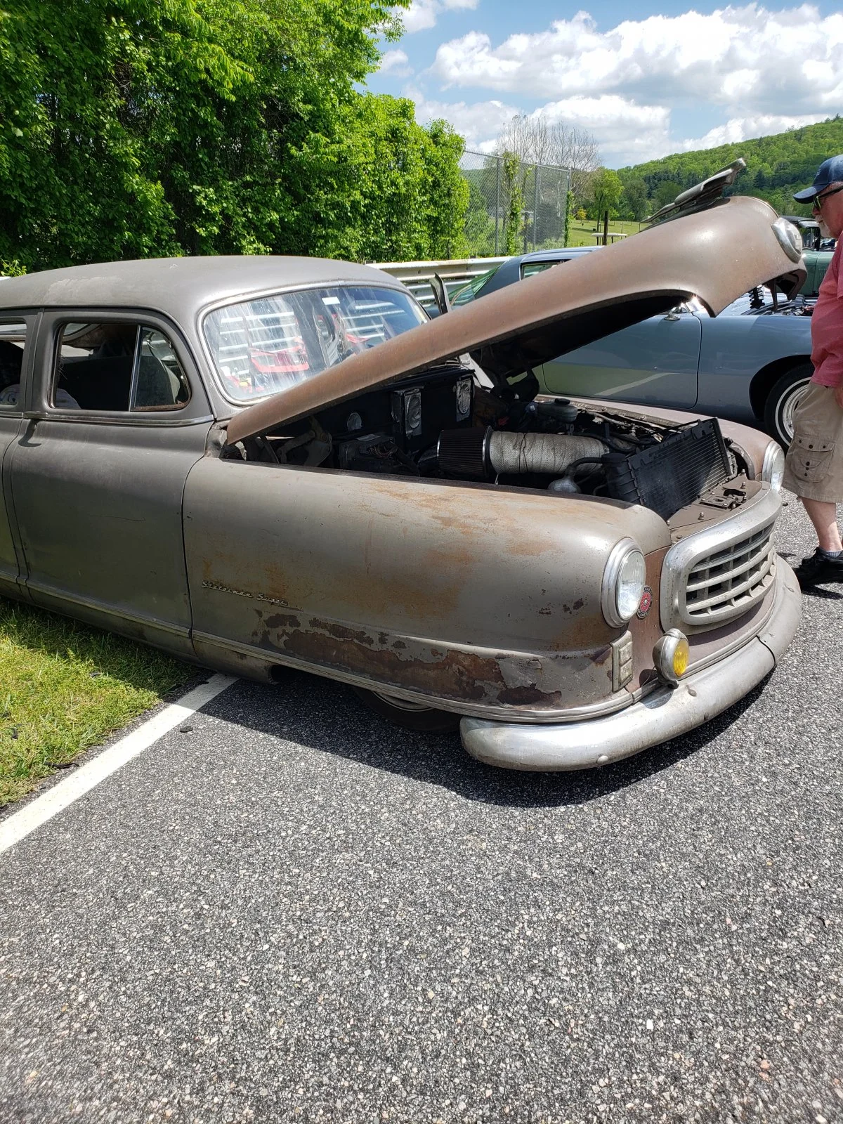

Looks like my bodywork jobsJeez! That thing has bondo falling off all over! I wonder if that thing really ever was used.

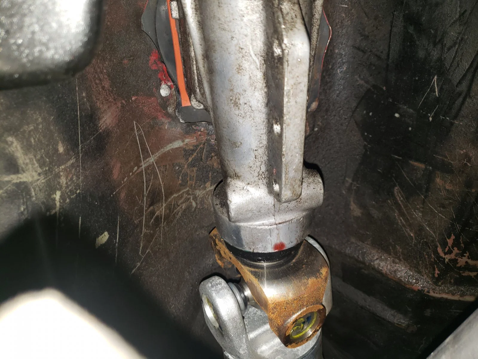

I had the same leak. Dropped the trans, pulled the tail shaft off, had a new bushing pressed in, changed the rubber seal. No more leak.
I did all that in the process of doing flywheel, clutch, pressure plate, u-joints etc.
There’s some good online vids of removing the tail shaft. I bought the bushing and brought the tailshaft and bushing to a tranny shop. $30 bucks and they had the bushings changed out.
I imagine the intense heat is due to low fluid, so I’d get on right away, before it becomes much more expensive.
Was trying to change the fluid today, but the drain plug seems like its welded on. I cant get it off, and I only have pretty basic tools but I may be able to use an impact to get it loose. Thanks for the info, I'll have to change the seals and bushing now too. I thought it was weird how hot it felt.
I would double check your u joints while you’re there. If they are worn, it will probably wear out your seals again. I was also advised to change my yolk when I did the bushing so they wear in together.
