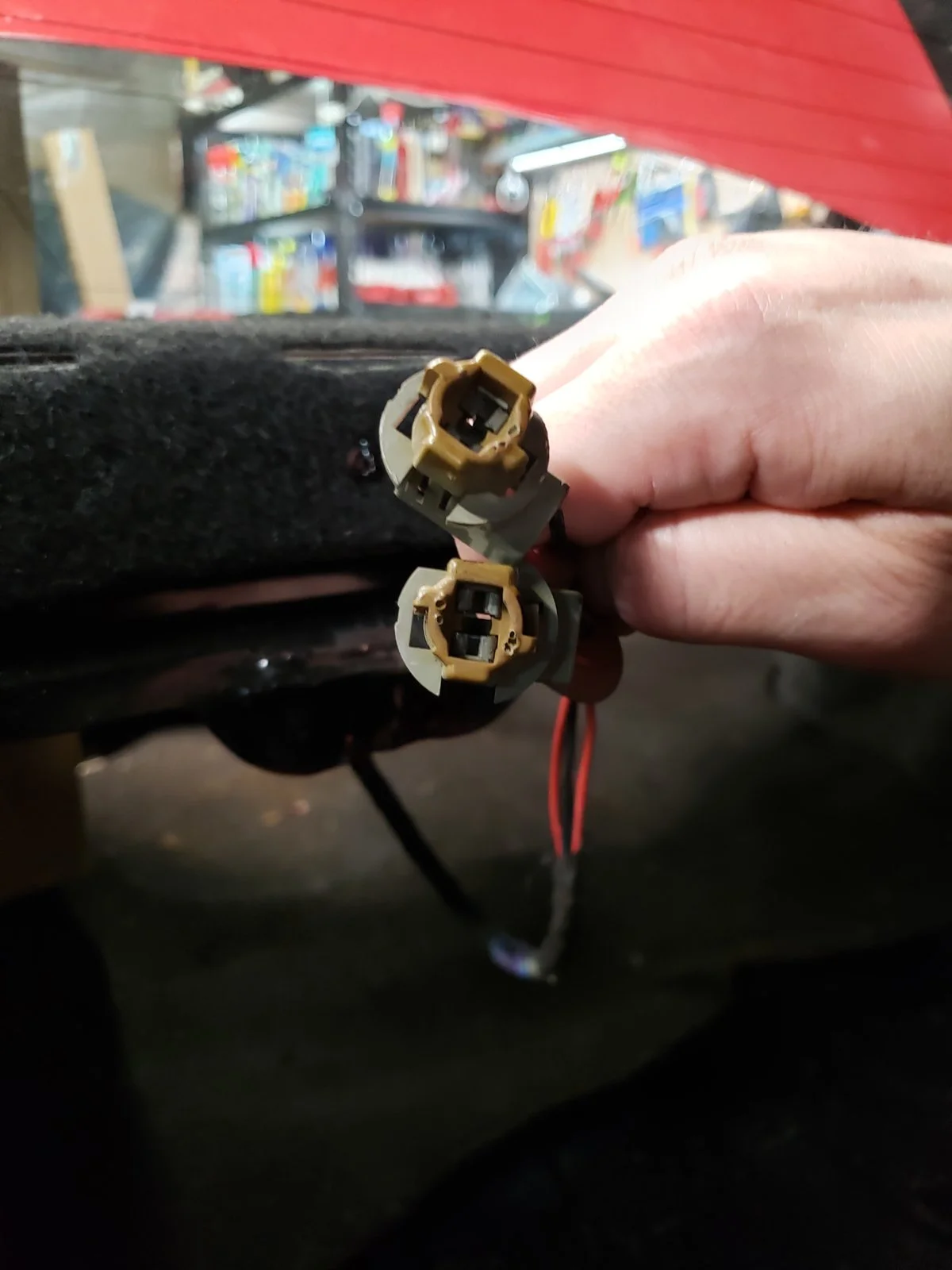

In the process of putting in the back speakers and noticed the 3rd brake light connections were melted. I dont remember seeing this before, what could cause this? I feel like it's a fire hazard now.

Using the wrong bulbs
Ok that's what I thought it might have been. I'll change them out to LED. Thanks.

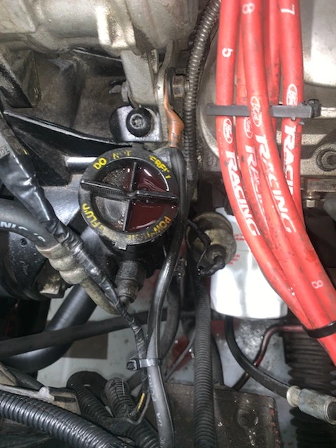

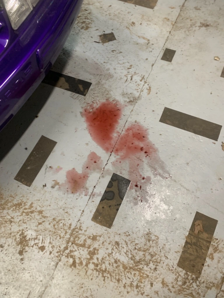

I fix one thing and another thing goes, now I have a random leak which I'm assuming is power steering fluid, coming from the driver side axle. Can someone give me insite on what causes this to leak and how to stop it? I accidentally drove/reversed for a couple mins with the e brake on(busy road, in a hurry, steep hill, 3 point turn).. dont know if this is what caused it.

Check the return lines with the regular hose clamps. They are pretty prone to leaking. I just changed my return lines and clamps, stopped all my leaks. Of course that’s the best case scenario, hopefully it’s not something worse on yours.

Update, it looks like its coming out of the pressurized cap. I have no idea why this is happening. I haven't added any fluid. I had my car serviced for an oil change/inspection a couple days ago but they never said they added PS fluid.

I guess the rack being shot, and having to replace, would be worse case. I’d try to clean it all up first so you can pinpoint where the fluid is coming from.

Looks like someone overfilled the power steering fluid.

I bet the fluid is filled to the rim.

If it is on the drivers side of the car, my guess is that it is overfilled. Drain it down the cold level mark on the dipstick under the cap, and drive to see if it still leaks from there. I just went through this with my car.
Worst case is the rack is shot and is leaking into the tie rod boots and puking out there. Been there with my car too.
