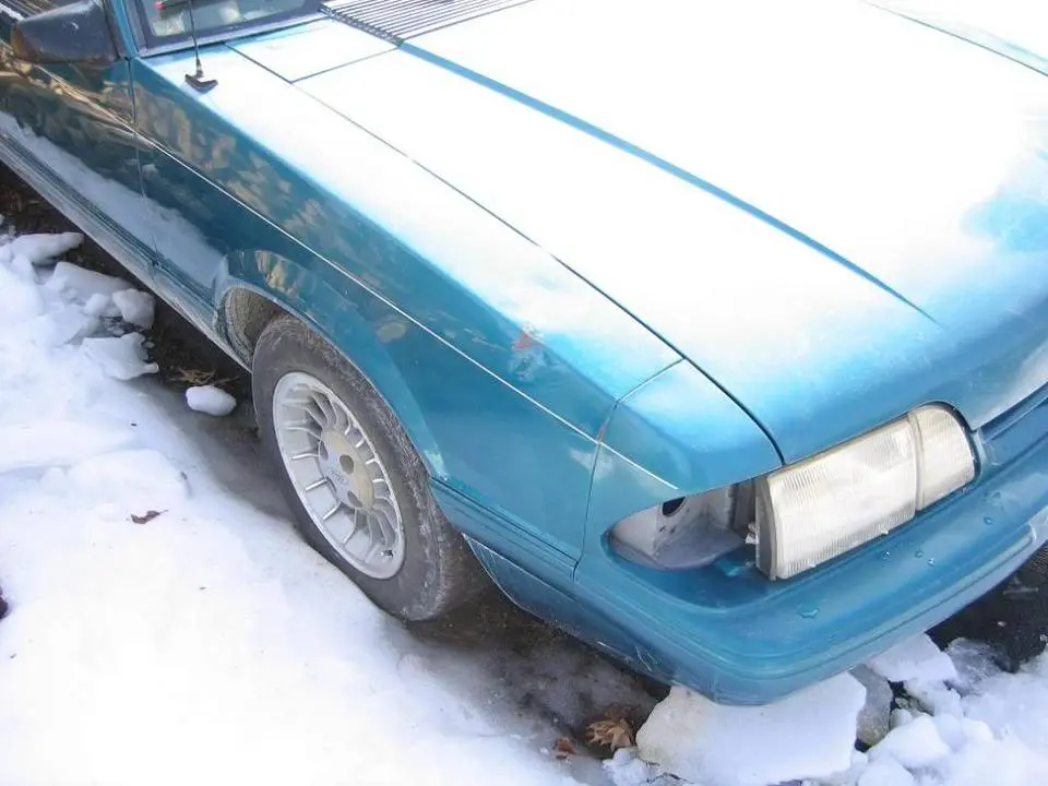

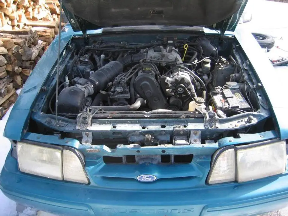

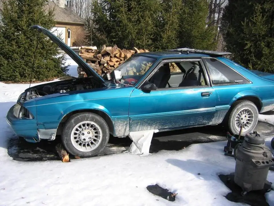

Early February. Giving the new ride a first look. Not too impressive. Needs a windshield, and the driver's window isn't opened, it is missing!
All 105 HP out of the 18 year old 2.3L Four Cylinder.

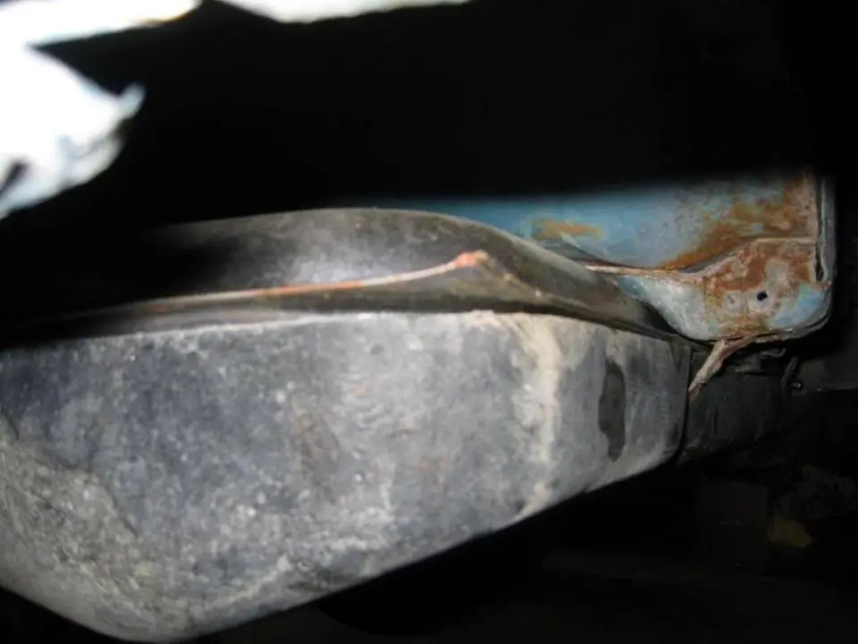

Left front fender apron damage. Looks like a minor frame pull is in this car's future. No biggie.
Left front fender area. Probably going to need both fenders. New lights are ready to installation in the future.

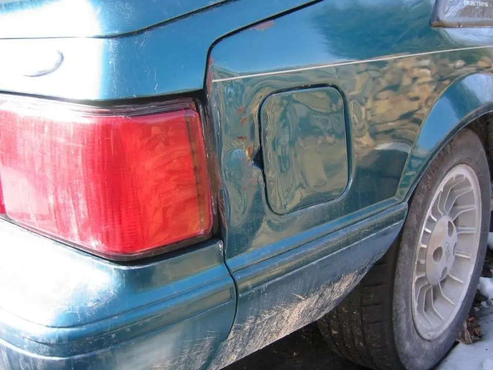

More damage! Going to need a little pull on this quarter panel. New gas door is going to be needed.

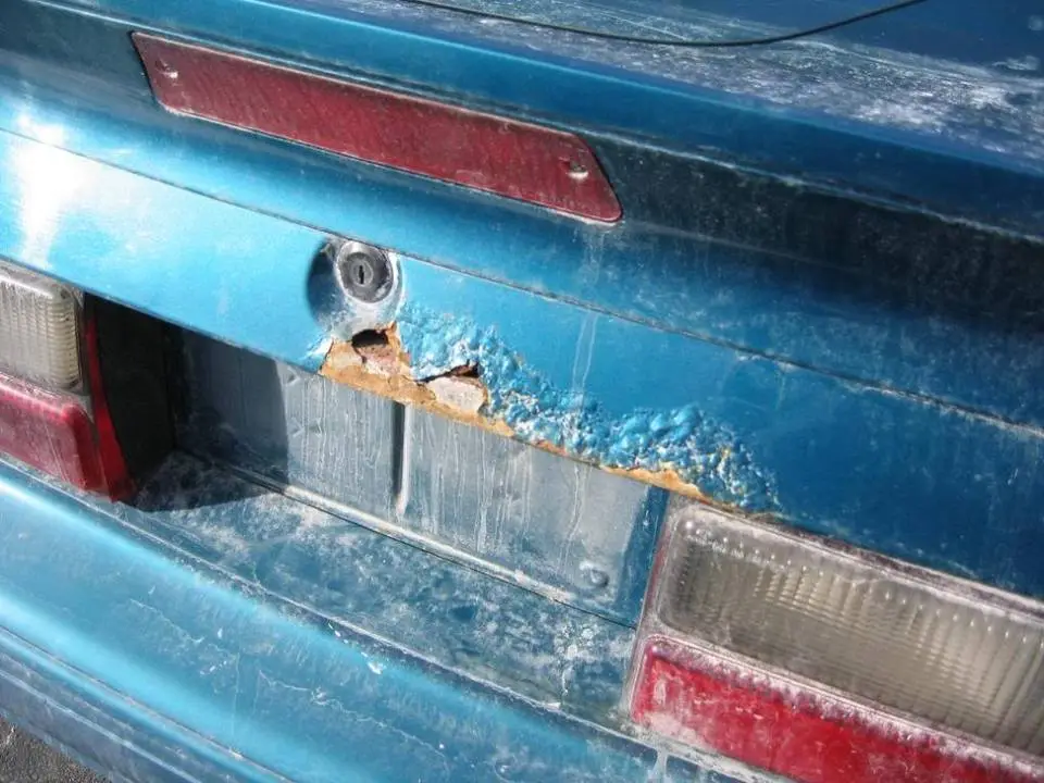

This hatch is wasted. Fiberglass will replace this rust prone hatch.

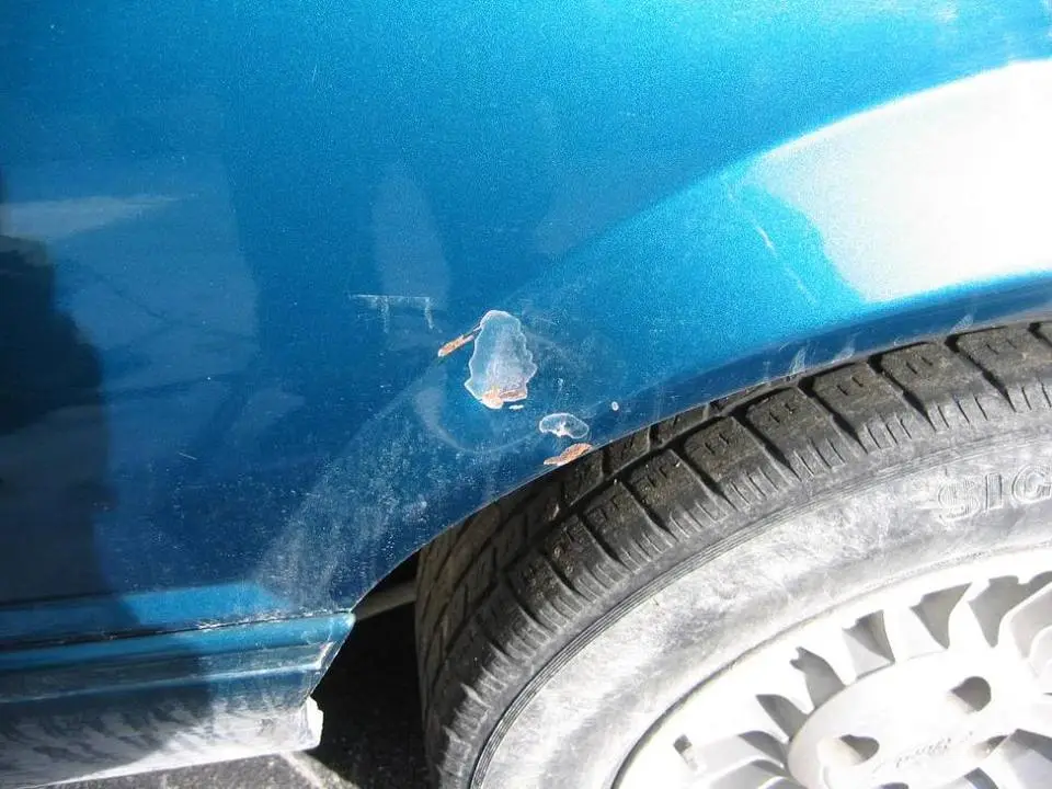

Car has a lot of little spots to repair, like this one.

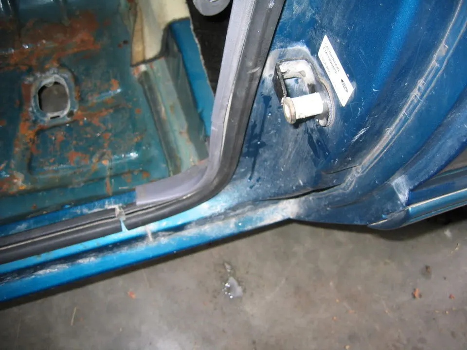

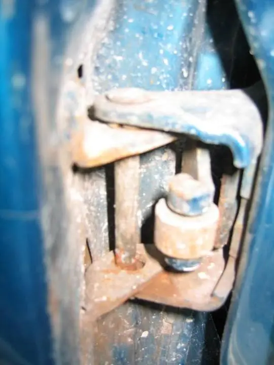

Door hinge kit on the way. Can't close the door without lifting it up, as it hangs down about a full inch when opened.

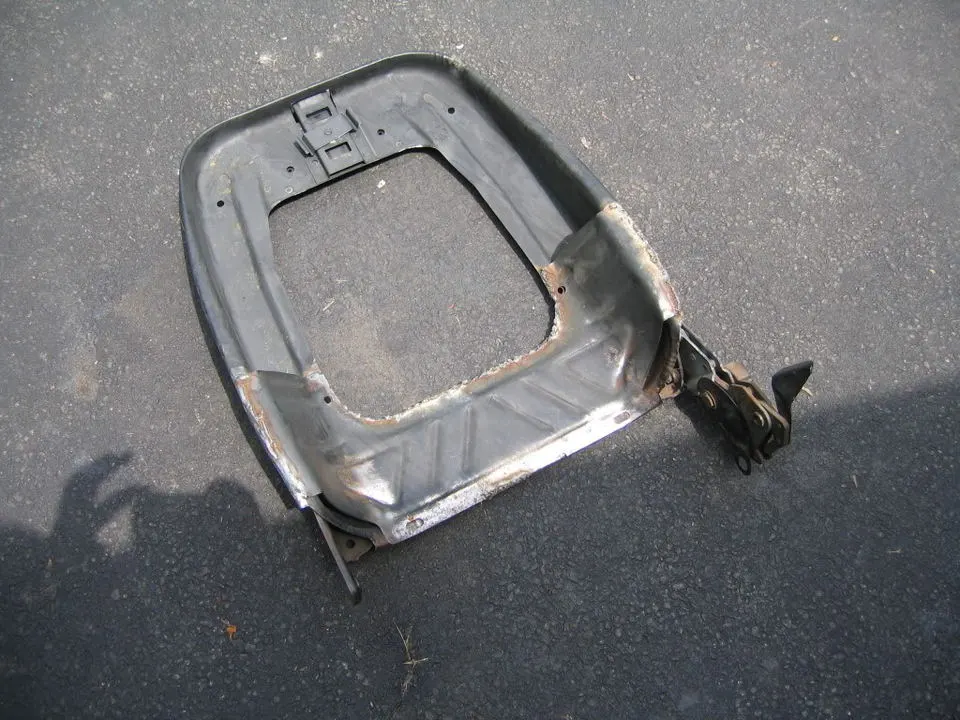

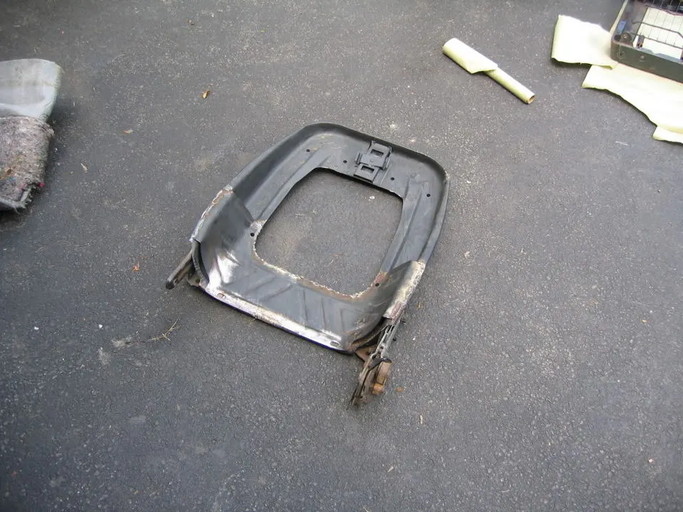

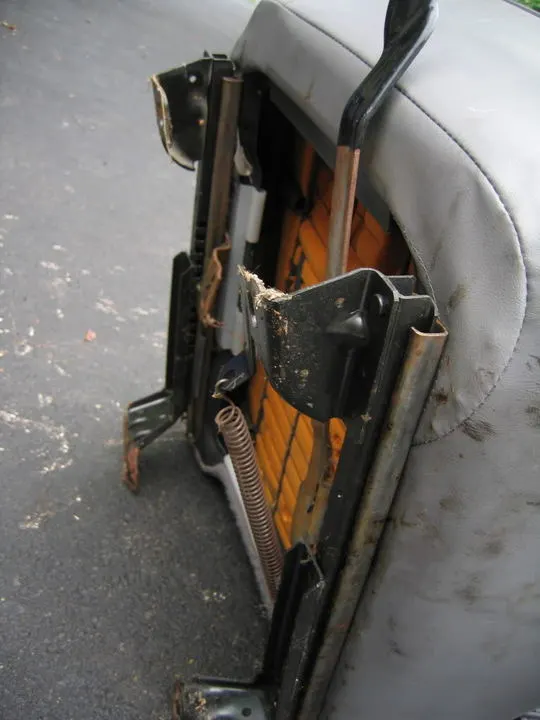

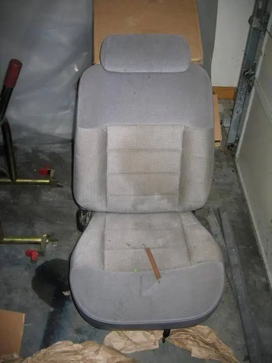

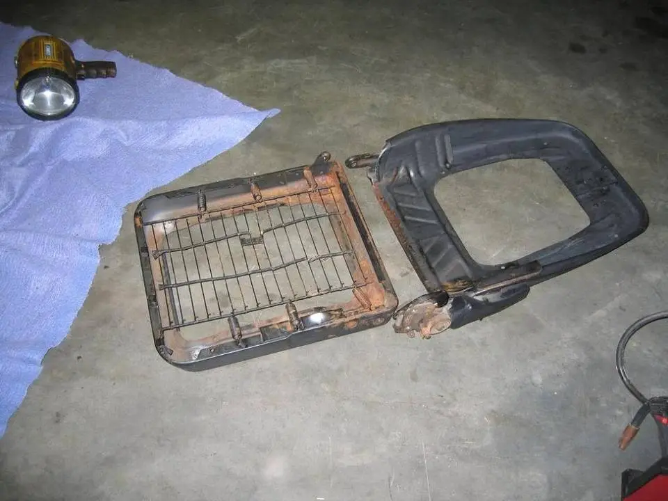

That's the driver's seat! Looks pretty different without the foam cushions and cloth seat covers! This one is getting a couple of new welds to fix the "gangsta lean" these cars are known for.

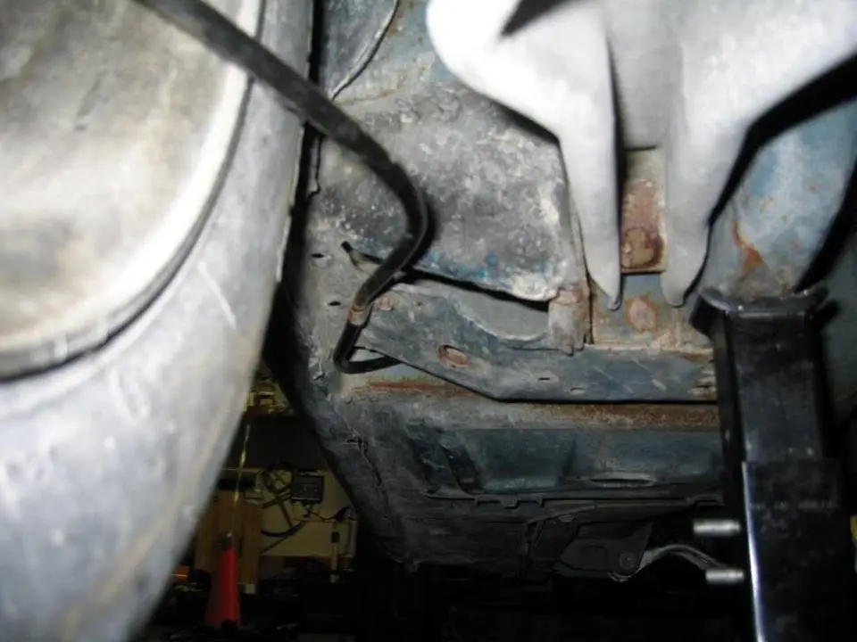

New fuel tank, housing a new fuel pump. Previous owner damaged the last tank so that it was leaking.

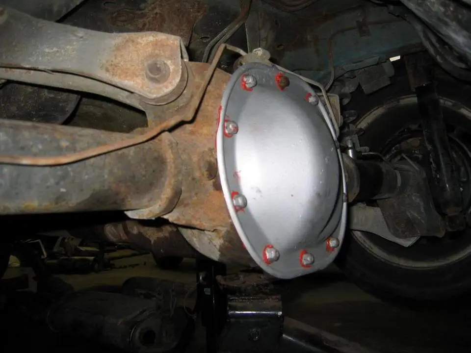

My repainted differential cover. Had to take remove the axles to replace the rear axle bearings.

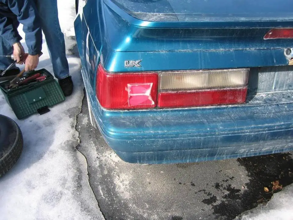

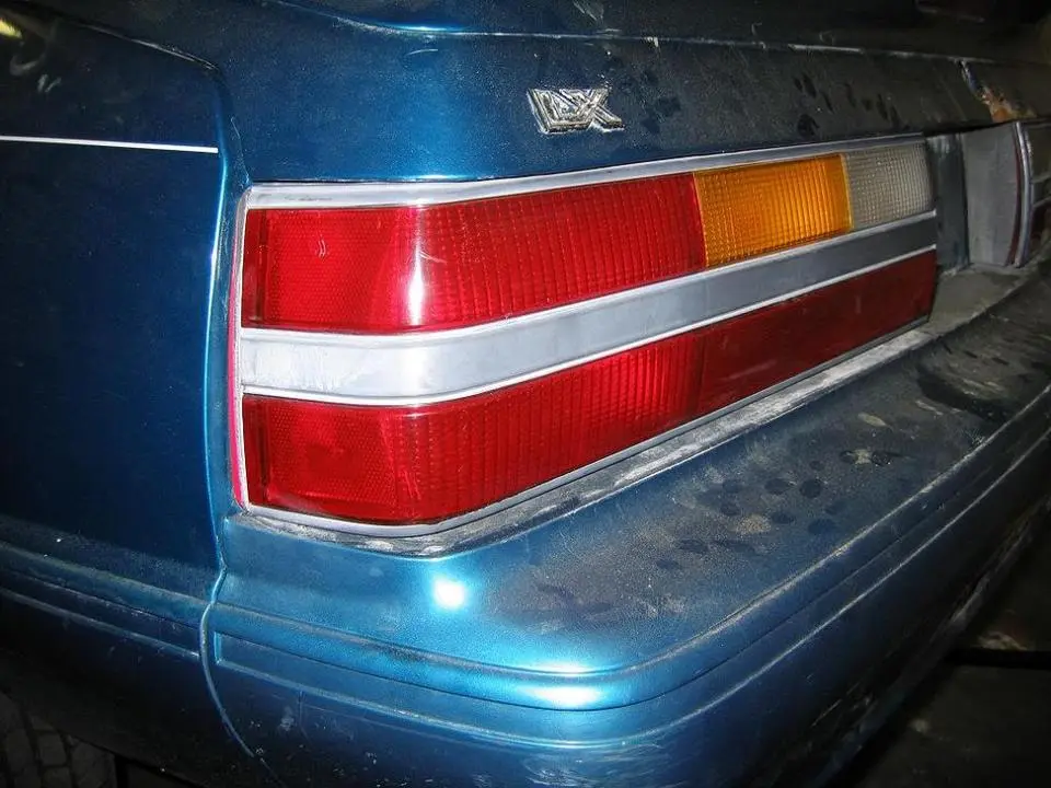

Tail lenses off of an 86 GT. They need a little refinishing, but they are on right now so I can get the inspection all squared away.

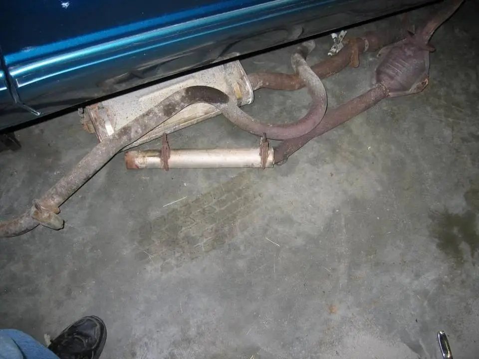

Brand new exhaust on the way. Could probably save some of this, but... nah.

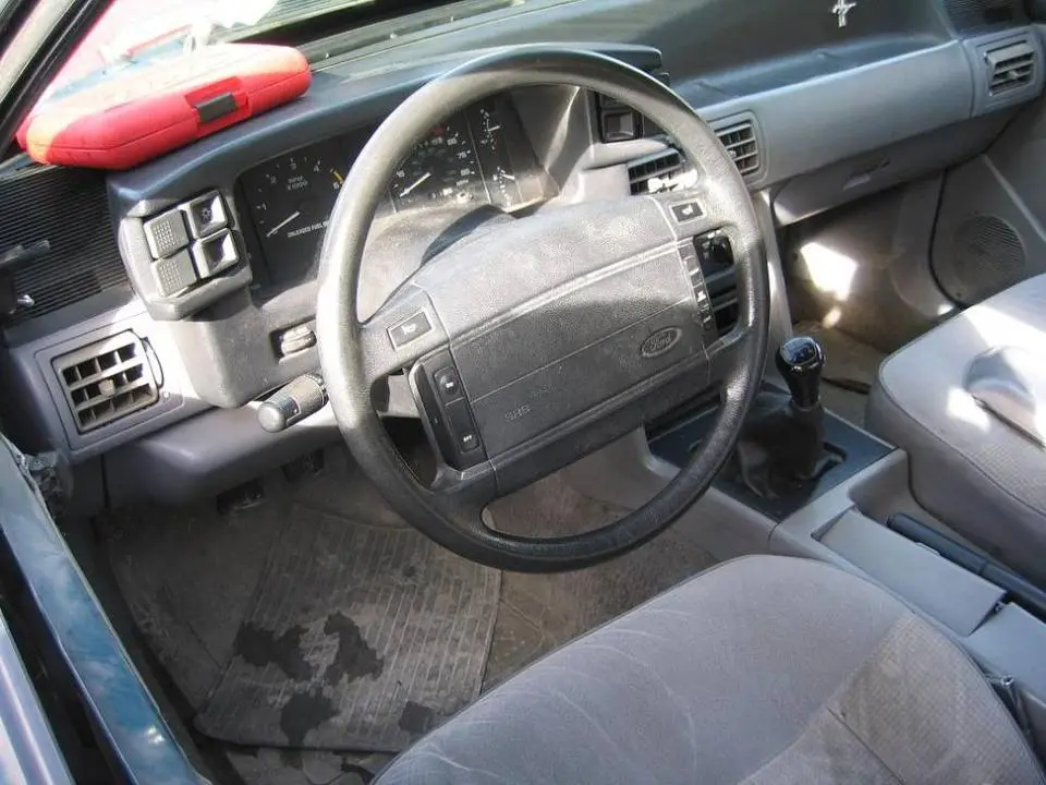

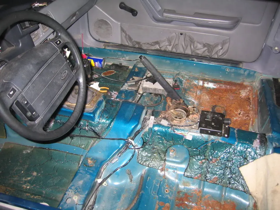

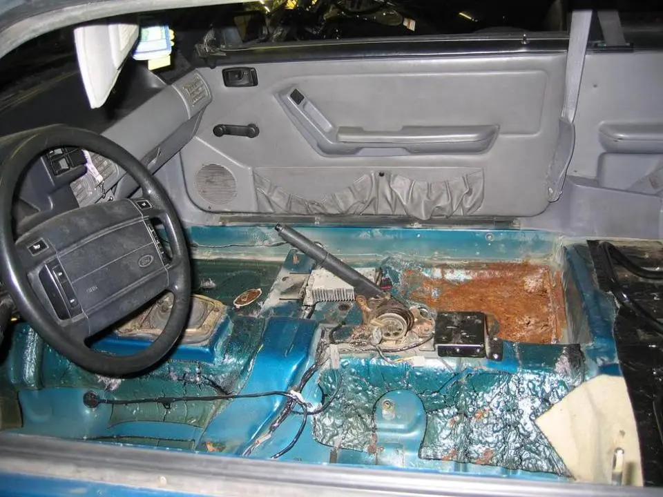

Interior is looking a little different these days!

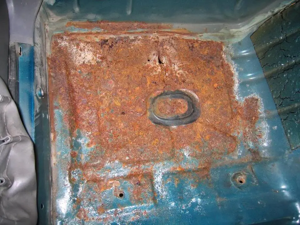

Passenger rear floor pan is... uh... rusty! Cutting and welding on the way!

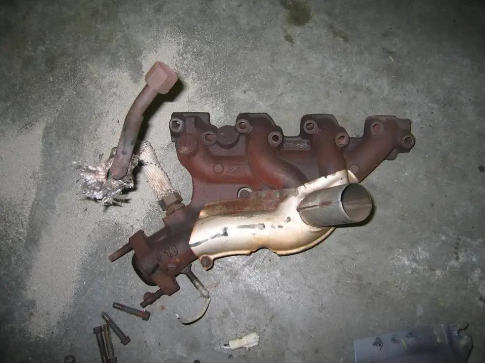

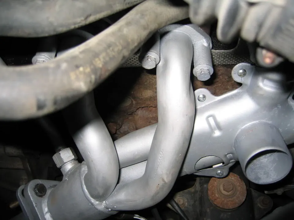

The old exhaust manifold. Ditching the heavy, no flow POS for a Ranger tubular piece.

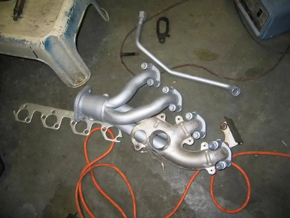

Ranger header looks nice with the new paint. Quite a bit lighter than the stock junk.

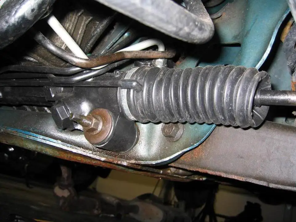

New rack and pinion. The old one was leaking, so it was time to upgrade to a sport rack. 2.5 turns lock to lock, down from 3.

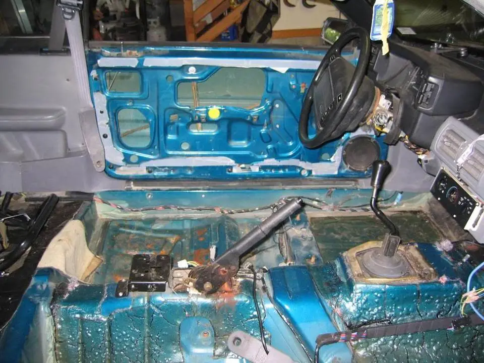

Another shot of the interior. Still a long way to go here!

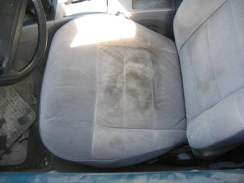

Okay, what the hell did these people do in this car? You know what, I don't want to know. Seats are disgusting.

Driver's seat back welded and ready for paint

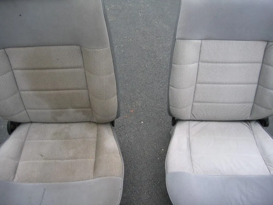

Seat foam ready to be cleaned

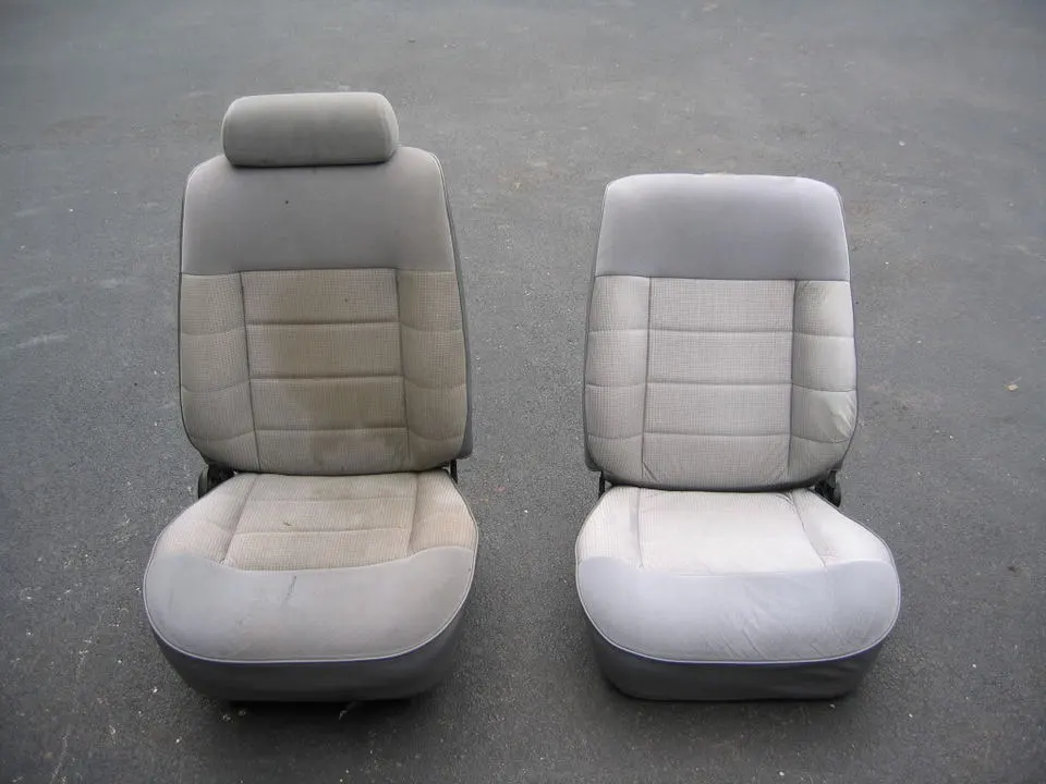

Driver's seat (cleaned) compared to passenger seat

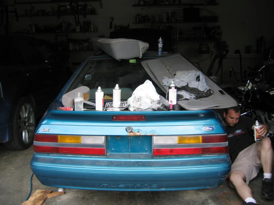

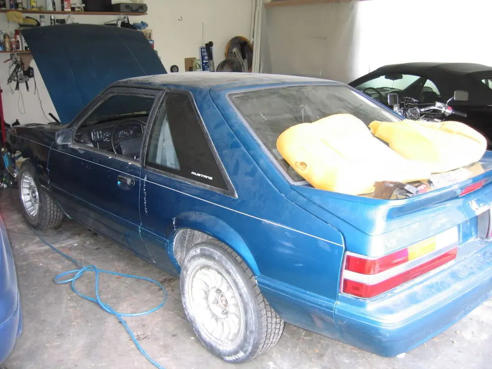

Junk on the trunk
Interior still looking rough

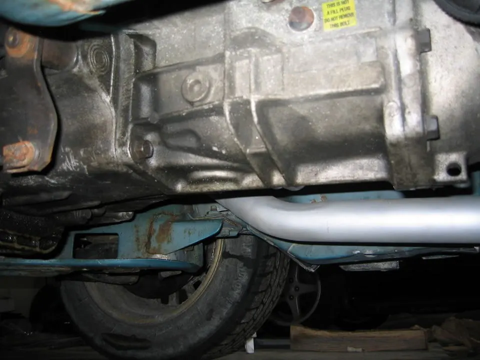

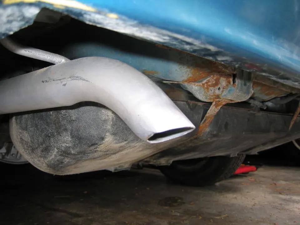

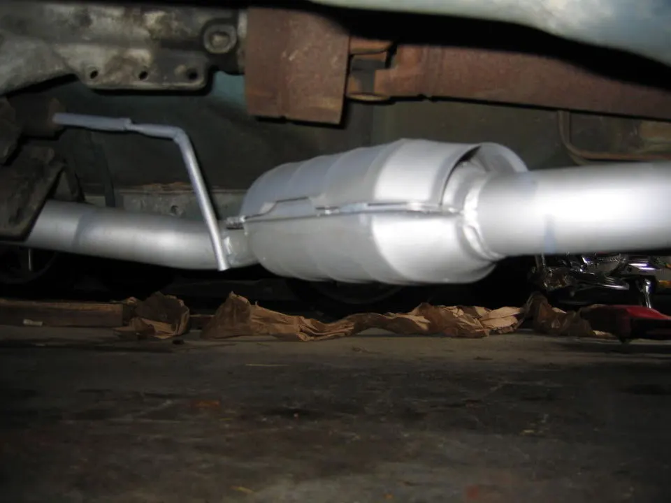

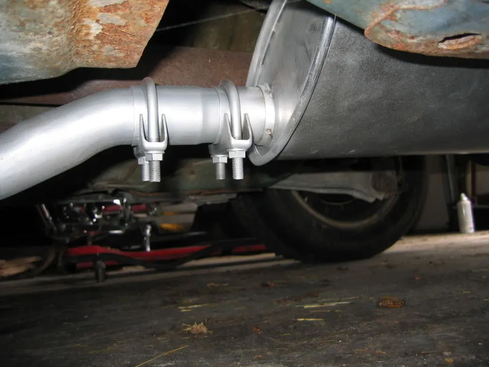

New exhaust finally installed...

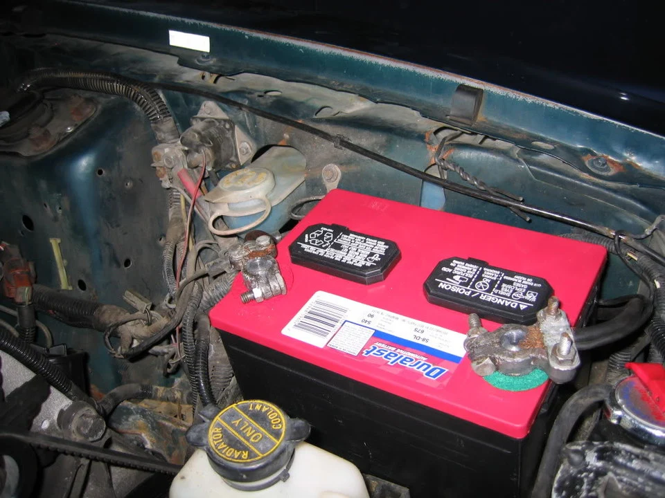

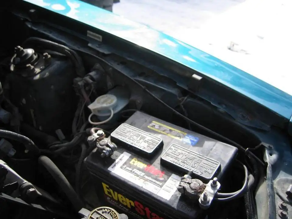

New Battery
Ranger header installed!

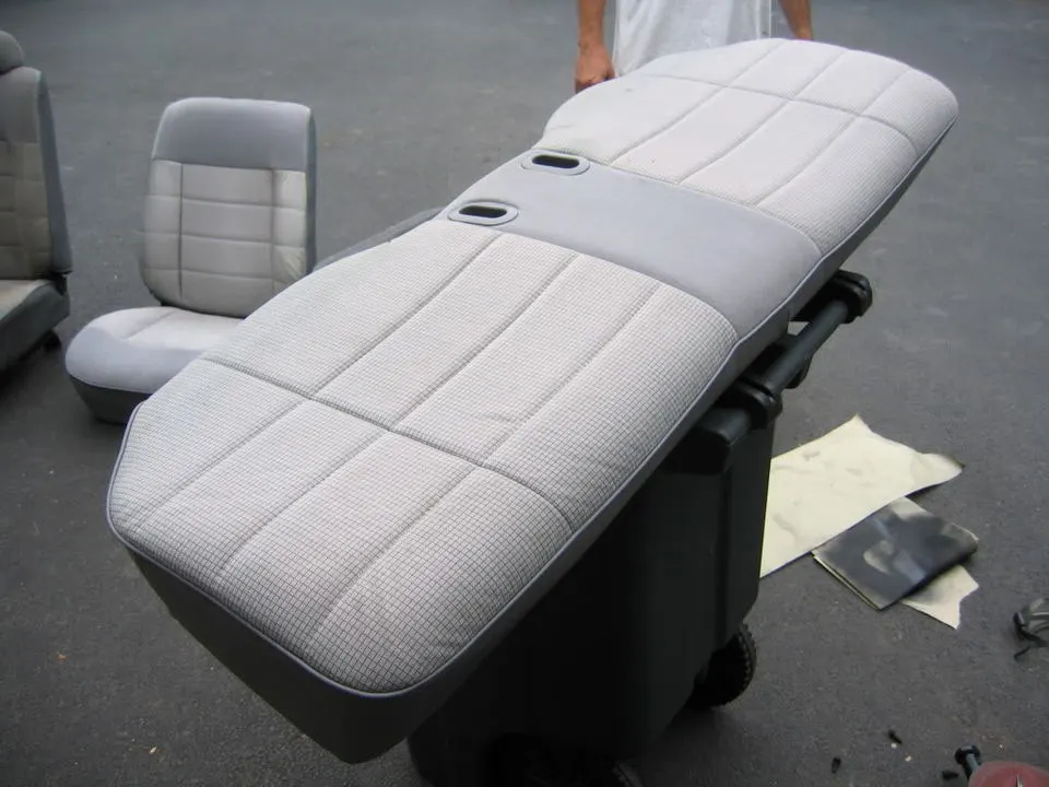

Back seat cleaned and reupholstered

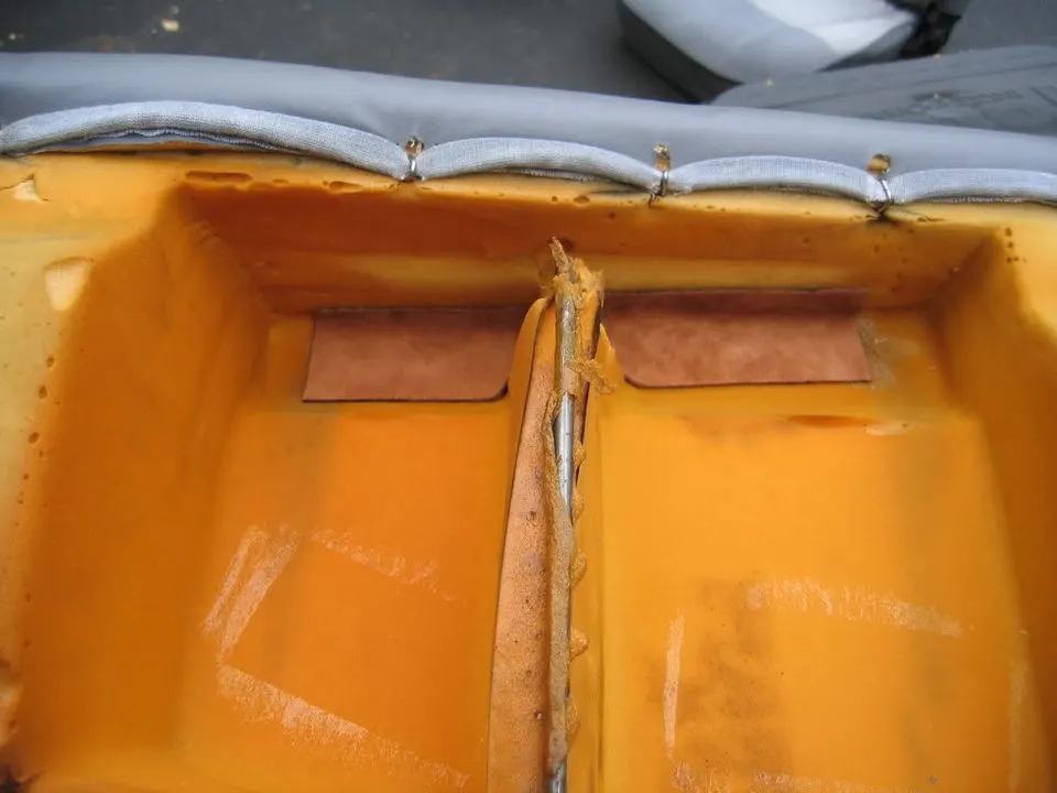

Torn seat foam reinforced with leather backing

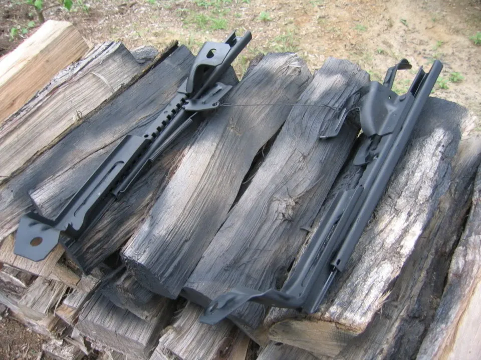

Driver's seat tracks repainted
Passenger seat tracks in original condition

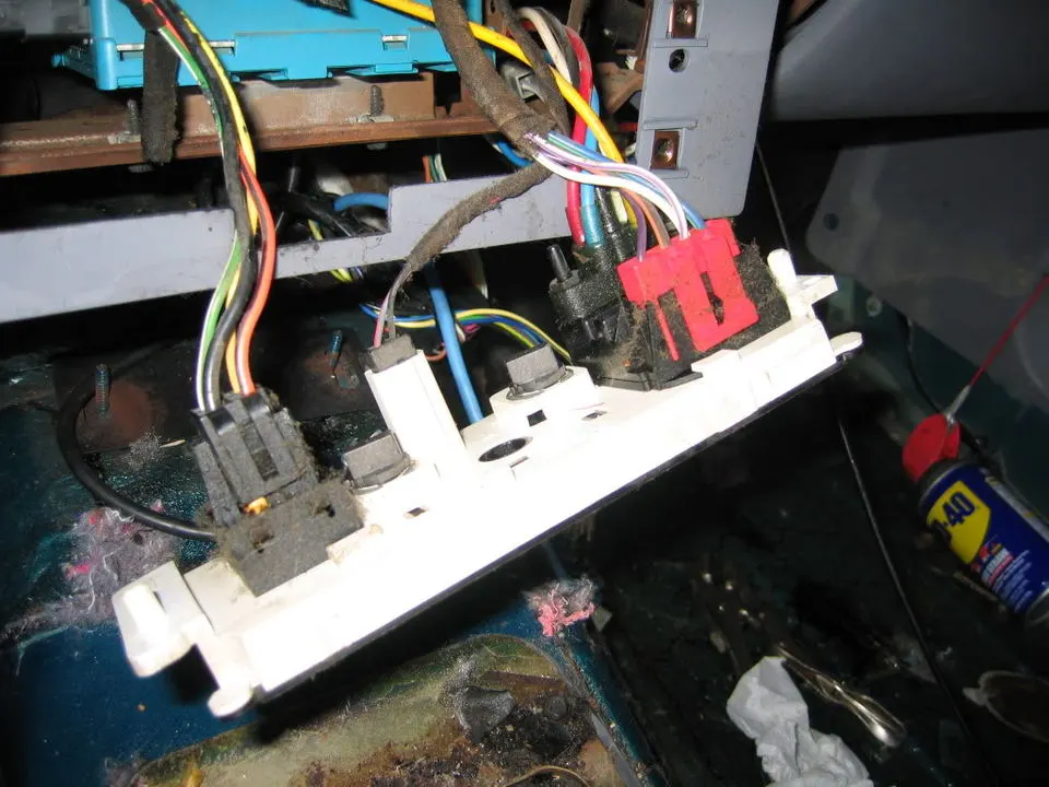

The blend door wouldn't operate properly because the cable was frozen. Working on lubricating and freeing up the cable. Might just have to replace it.

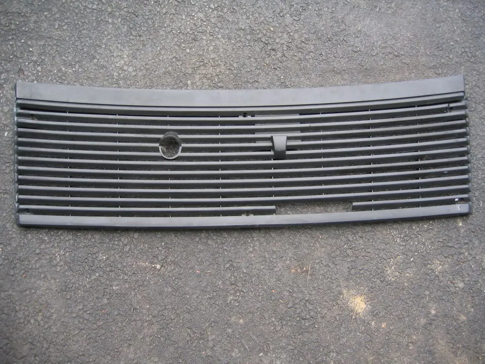

Cowl Vent panel is damaged. Going to have to get a new one it looks like.
Idk why but the seats did that in my car too. I don't think it was some one not making to the bathroom although that would be weird if someone did that in my car too. Must just be the way those seats wear (idk about correct usage of wear) lol. But I want to put racing seats in mine. Think they'd look nice and clean.
