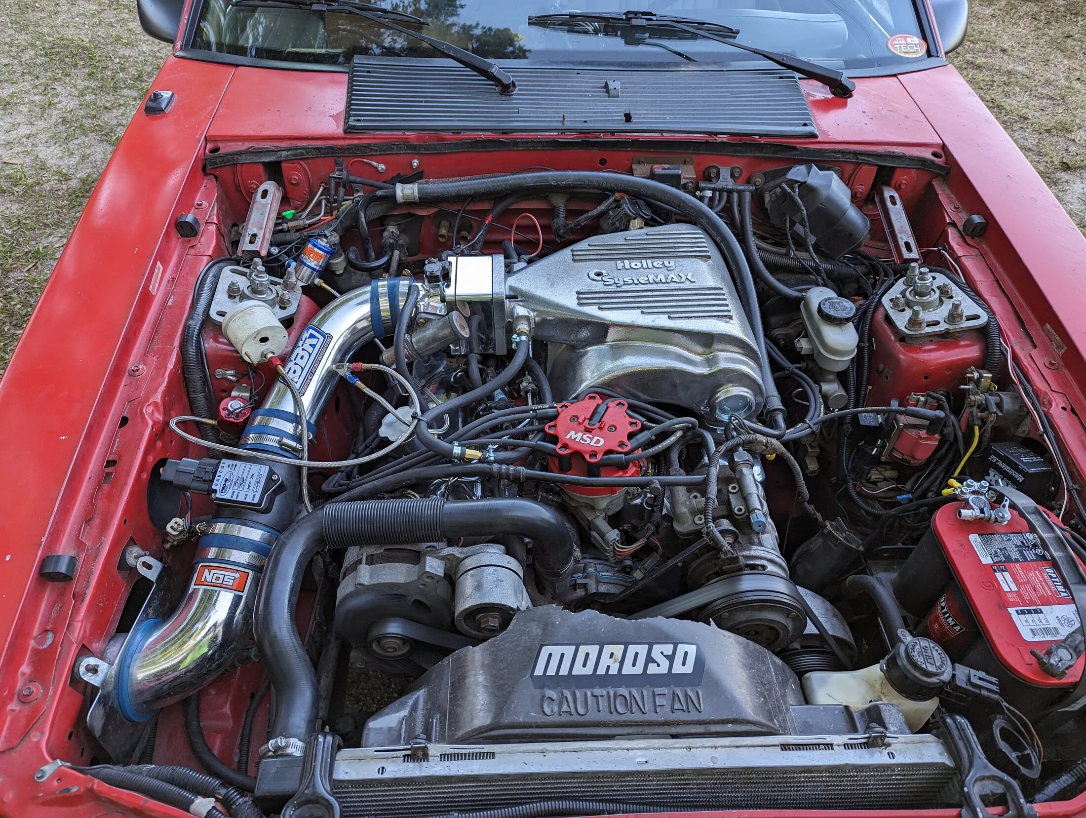

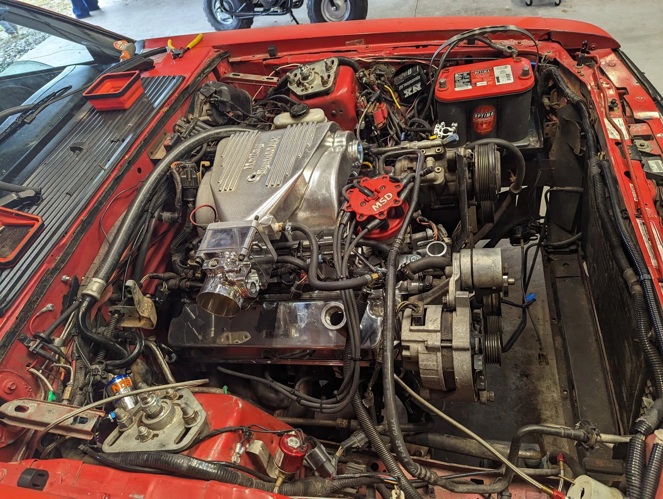

Ya just the green antifreeze and water, I'm sure there's a lot more distilled water than there is antifreeze. I can take some pics when I get home, The pictures I posted now are from when I did the top end kit. Don't mind the fuel pressure gauge just laying there that was just for start up, and all the wiring has since been cleaned up. I do have a question. I got the trick flow gasket set that has like the rubber around the ports built into the gasket, do you still need to use silicone around the water porch with those gaskets?

Looking through your images:
It looks like you have eliminated the water pass-through for the TB. (can't pickup anything there then, can ya? :O_o: )
What do you got going on here?
That's the pcv feed line goes to the T, one end goes to the throttle body other to the charcoal canister. That's how the Holley systemax instructions say to route it. But it was pulling some oil into the throttle body so now it runs thru a small oil separator first then back to the TB
