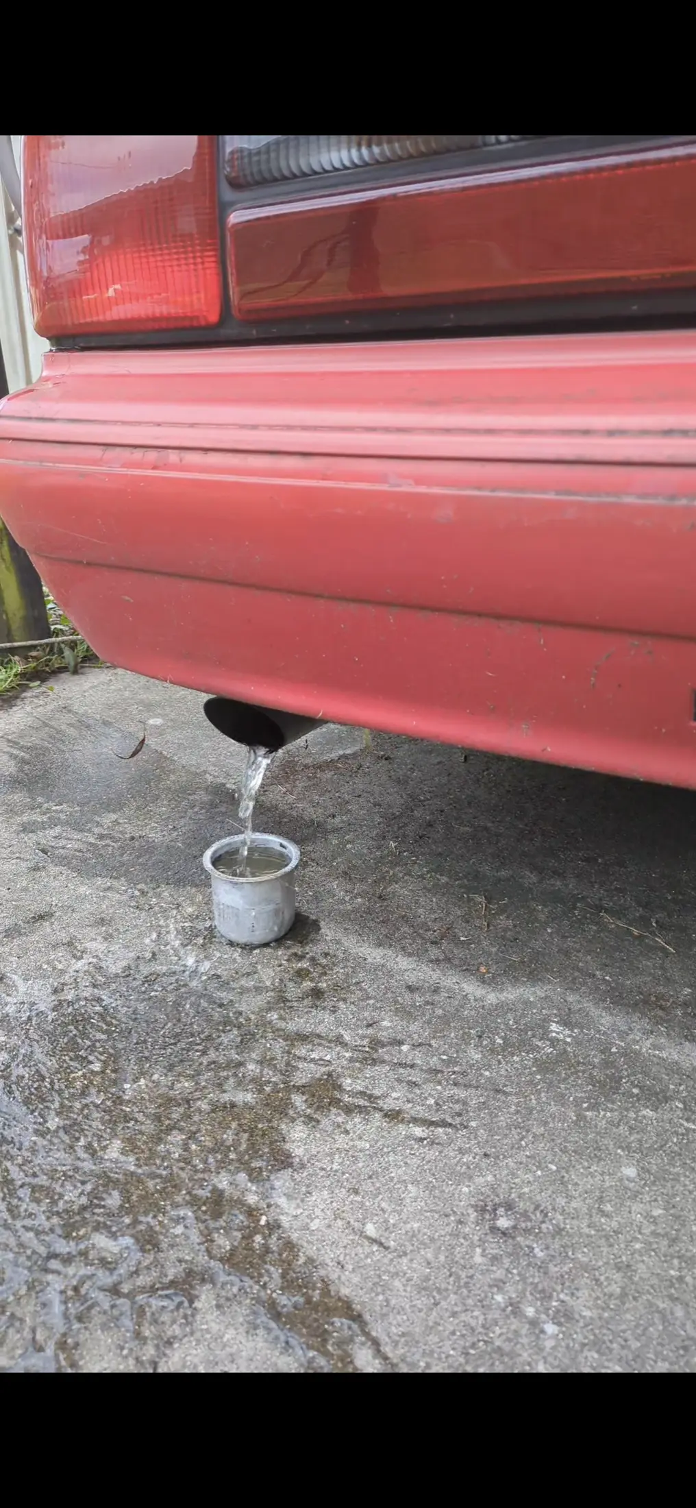

So I was just out blowing the back porch off to start messing with the car and I blew inside of the exhaust pipe a little bit and seen a little bit of water come out the other one so I put the blower up on it and it probably pushed out like a spray paint can cap full of water maybe a little more. I put this spray can lid to catch it so I could see what it was and it definitely just seems like water
This doesn't seem remarkable to me. Most modern cars with a factory emissions cam will produce water.
Exhaust parts will condense water over night in a humid environment... And you're in Florida :oops:

This is all the water that came out, on the ground and in the cap. Just seemed like a lot to me, but maybe I'm wrong. I'm gonna go run the car around town here shortly and check of water is gone from the radiator
