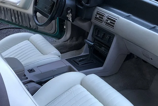

I have a 93 mustang lx 5.0 coupe with 34 k miles on it. The radio in it does not work and it’s not the factory radio although it is a ford radio. According to the VIN number it’s supposed to have part number F3ZF-19B165-AB. Does anybody know where to locate one of these or know what other stock radios are interchangeable?

that radio won’t work. It would in a 87-92, but lacks the unique 93 style premium jbl plugs. You are right that some f150 radios do work

Thanks for all the comments. i Have the premium sound system with the amp underneath passenger side seat. There are six plugs behind the radio. Looks like there are 4 that come from the amp and two that are from a different wiring harness. By the way I have the wrong radio for this setup. Are all six of them supposed to go in the back of the radio? I have Yet to find a Ford radio out there that had six plug ins. Hep please!,,
Two male plugs plug into to female plugs that run down to the amp under the seat. From the amp is the single plug with the blue wire, and a make plug. Those two plugs plug into the radio.
take a look at the thread I linked before and it shows the harness and the plugs
