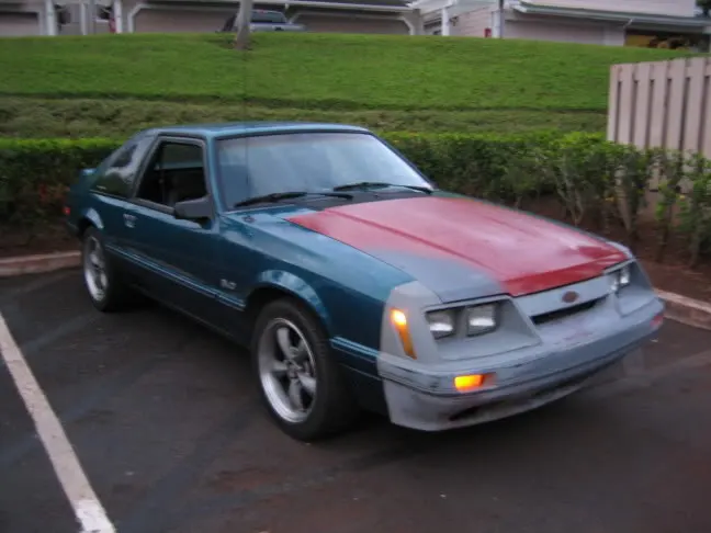

Alright guys I have it finished. Here are some of the differences Ifound.
1 Cant use 90 or newer fron bumper or supports, they stick out too far and are a differnt mount and you will have to get creative on this soulution.
2 If your car is the newer ones with the larger fender openings, the new side skirts will not fit from your donor car. (still finding a solution for this)
3 Airbag cars, thier sensors WILL interfere with the front cover. You can notch the bumper cover if you want( I am going with a tild wheel so guess that I did with them:D )
4 You will have to re wire the headlights only, just match up the wires colors, all the blinkers still use the same twist and lock set up and will twist right in.
I will post some pics now (hopefully I can figure it out)
View attachment 476650 This is the template I am making to get the supports centerd in the frame.
View attachment 476652 This is the supports the 85 is on the top, note the flange on the 93 that locates it in the frame.
Its almost done but still a lotta work to do.
