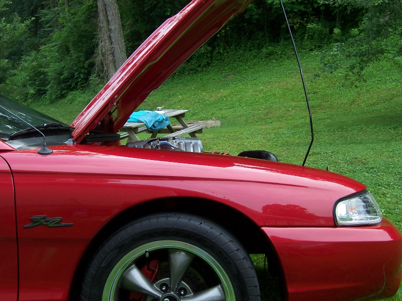

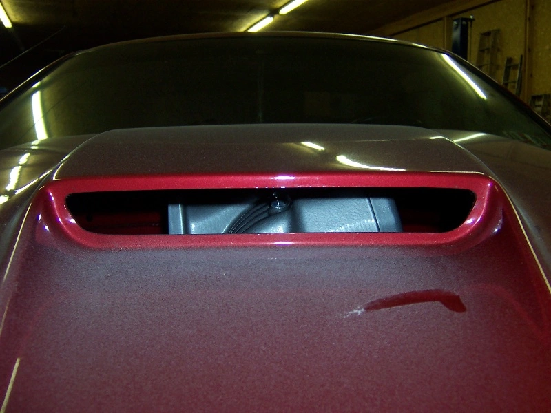

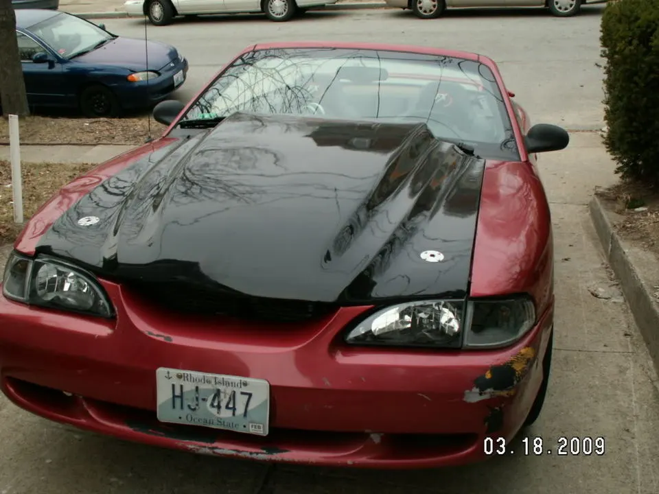

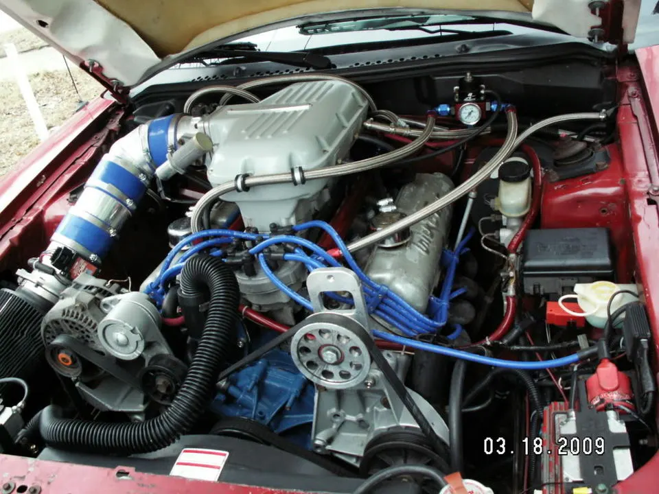

Stock replacement polyurethane mounts, stock k-member (in these pics), 3" cowl hood. The only clearance problem was at the rear of the hood, you can see a small hole I had to cut for it to clear.

Not bad at all. YouTube - 95 Mustang in car running 12.15 @ 121mph
I don't know how close it would be with a normal hood...the SVO scoop gives me an extra inch or two at the front of the intake.

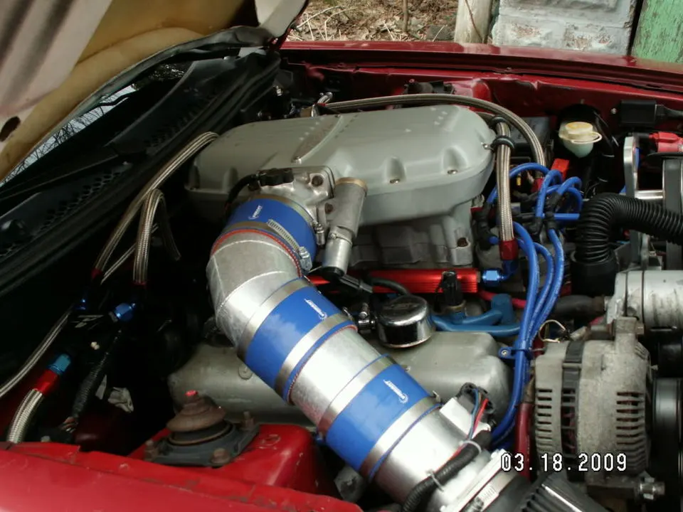

I had the PP typhoon. It killed my rpms at 4600rpm but that was on a 414 c.i.

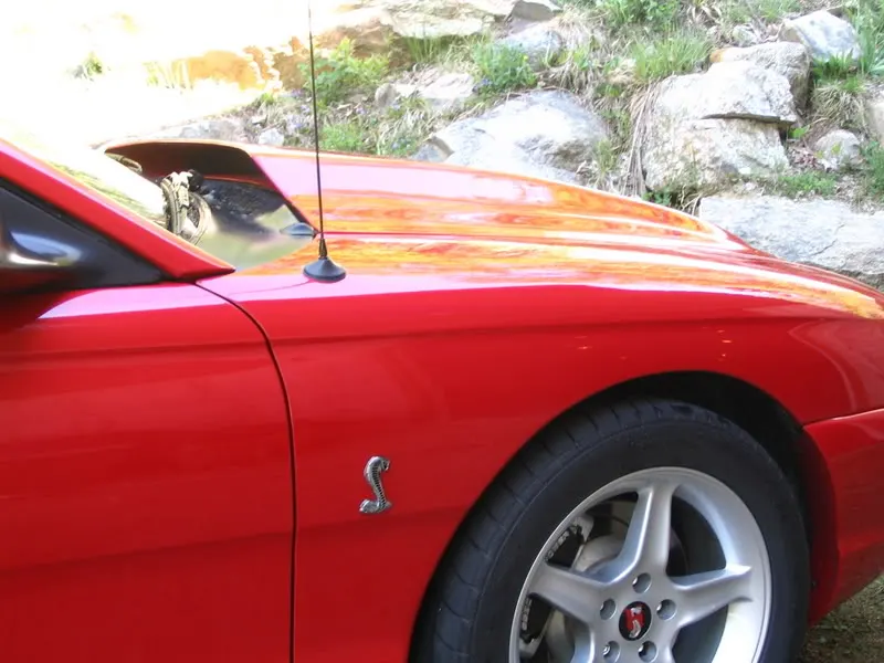

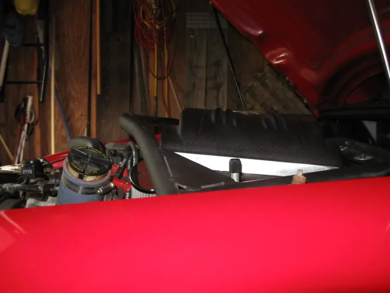

Stock K member not sure about the motor mounts. 3.5" cobra RR hood and Trick Flow R 351 Intake.
jpg[/IMG]

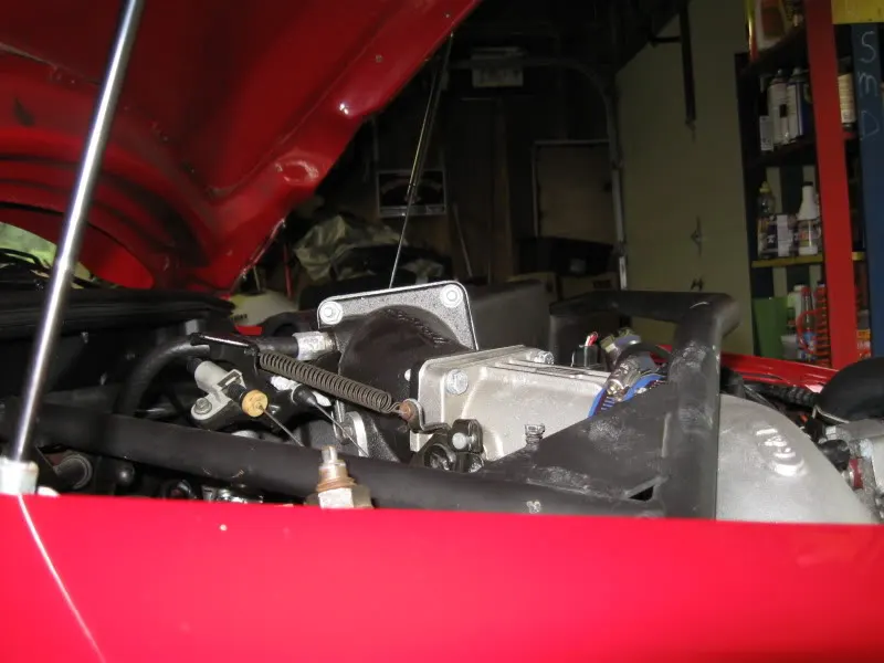

Venom,
Would it be possible for you to take an additional photo for me? One at fender level to tell the height of the intake at it most forward part with the hood open? That is the same external setup I am going to use, but I want to keep as low of a hood as possible (maybe a 1.5" or 2.5" Cobra R)

M1Tanker said:
Venom,
Also, what strut tower brace is that? Mine was missing when I bought it.
I believe it was made by Roush, I dont know if you can get them anymore.
Here are a few additional pics.

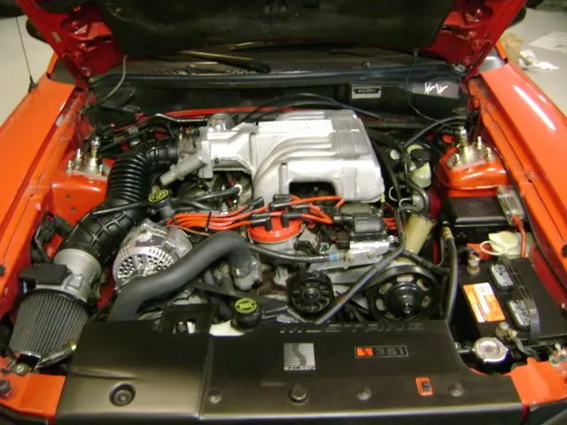

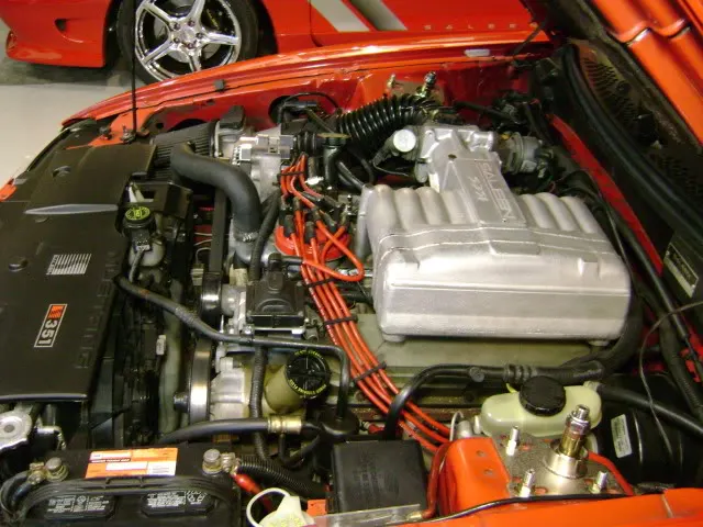

Heres my stock non s/c S351. It fits under a stock hood. Dagz is right that he used Fox vert mounts, I heard 1983 but not really sure what the diff would be? I also heard he modified the mounts....and he slotted the K member, moved the motor back a little.
