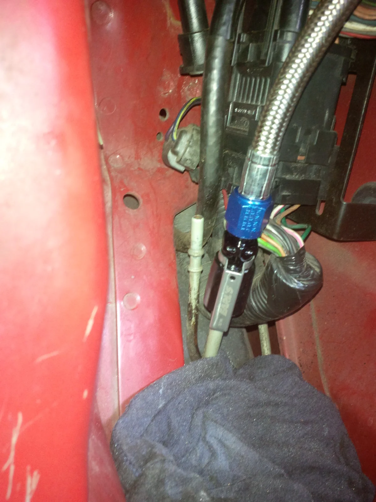

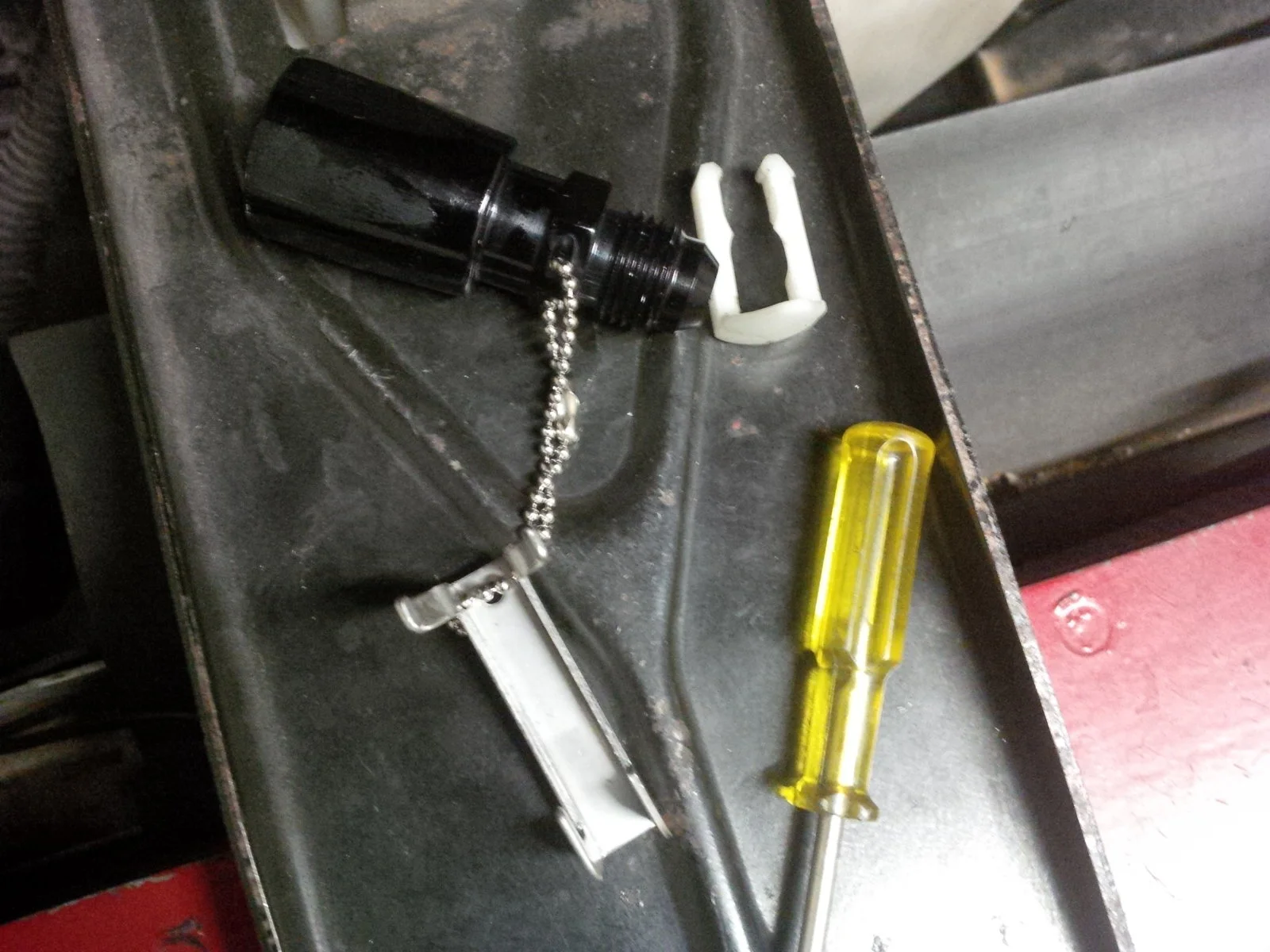

thanks for your answer. well, I've already ordered the part. I'll test it in about two weeks when it arrives by mail. I hope it works otherwise I'll try to sell it. we will see what happens.
hi dudes! finally I've got the part and installed. It fits! The only thing is that the lower ring on the hard fuel line should be grinded off if you'd like to put the security bracket on. beside that, you will later not be able to push through a removing tool to remove the part because of the lower ring standing right in its way.
keeping that in mind be sure to grind the lower ring off before putting the connector on the hard line. otherwise you'll not be able to remove the connector from the hard line FOREVER.
I'm driving my car for a week with the new connector and didn't encounter any issues until now.
I hope this was helpful.

Thanks brother, great information. Unfortunately still looks like there's no way to do this without getting out the fabrication tools. Seems like this would be a solid solution once you're done. That lower ring - can that be ground off or is it a flared out part of the line?
good question! I'have it ground off only on two opposite sides, not the whole ring. I looks solid and not flared out of the line.
If so it would fall apart if you grind it completely off? the consequences would be very ugly.
I have to carefully check that out. I suppose it may be the same like on the stock fuel filter.
yeah the lower ring looks like a flared part of the line. that's bad. but I was lucky and didnt ground it totally down. it didnt fall apart
lesson learned: DON'T GRIND THE LOWER RING DOWN!
you know the connector is perfect - and I like it - the only thing is that the security bracket doesn't fit without fab tools. good for you if you can live without it. however the connector has metal pieces holding the line, much better than the other plastic stuff which can easily pop off.
