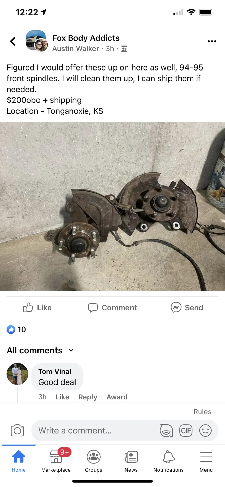

Perusing eBay,and the price for these are insane. Why are these not made in the aftermarket? I've seen anywhere from $3-600 just for spindles,crazy. Did see a set with PBR calipers,turned rotors and spindles for $430. The yards are clearly drying up with the 94-95 variety as well. I found a company that sells a big brake upgrade for the 4 lug setup kinda spendy,but after you'd buy new wheels it'd be a wash.
Price is insane because demand is starting to exceed supply. How many totaled 94-95s these days end up in junkyards? They typically now get parted out, and the folks doing that know the value. So the supply of cheap spindkes is pretty much gone.
I’ve had good luck with searching auto recyclers. Copart for instance. This is how I got my pair years ago, and how I got a pair of 96-04 spindles recently for under $100. They still charge “normal” rates for spindles, if they have them. You might have to wait a while but once in a while a 94-95 v6 does end up in a yard.
Not sure we will ever see them reproduced. The available drop spindles for our cars are in the $600-700 range, and right now still cheaper to buy the 94-95 spindles.
car-parts.com, year, model, part, sort by distance.
They appear to be between $50-$100 for most in my area. (i only searched left)
I too doubt they will be reproduced.
If you really need or want them, with a little work they can be found reasonably priced, i seriously doubt it would be profitable to repro them, especially when most guys would prefer originals anyway.
I agree with the others. Salvage yards are the way to go online. I have purchased my spindles. replacement ac compressor, and rims all from car-parts.com.
I don't have time to actually wrench so I spend my time buying parts with the hope of eventually putting them on the car. I suggest focusing on finding the parts that are not available in the aftermarket world first. Spindles, Cobra branded/Cadillac Brembo calipers, 93 Brake booster and so on. No sense paying a premium paying for something someone else bought from a salvage yard and slapped some paint on it.

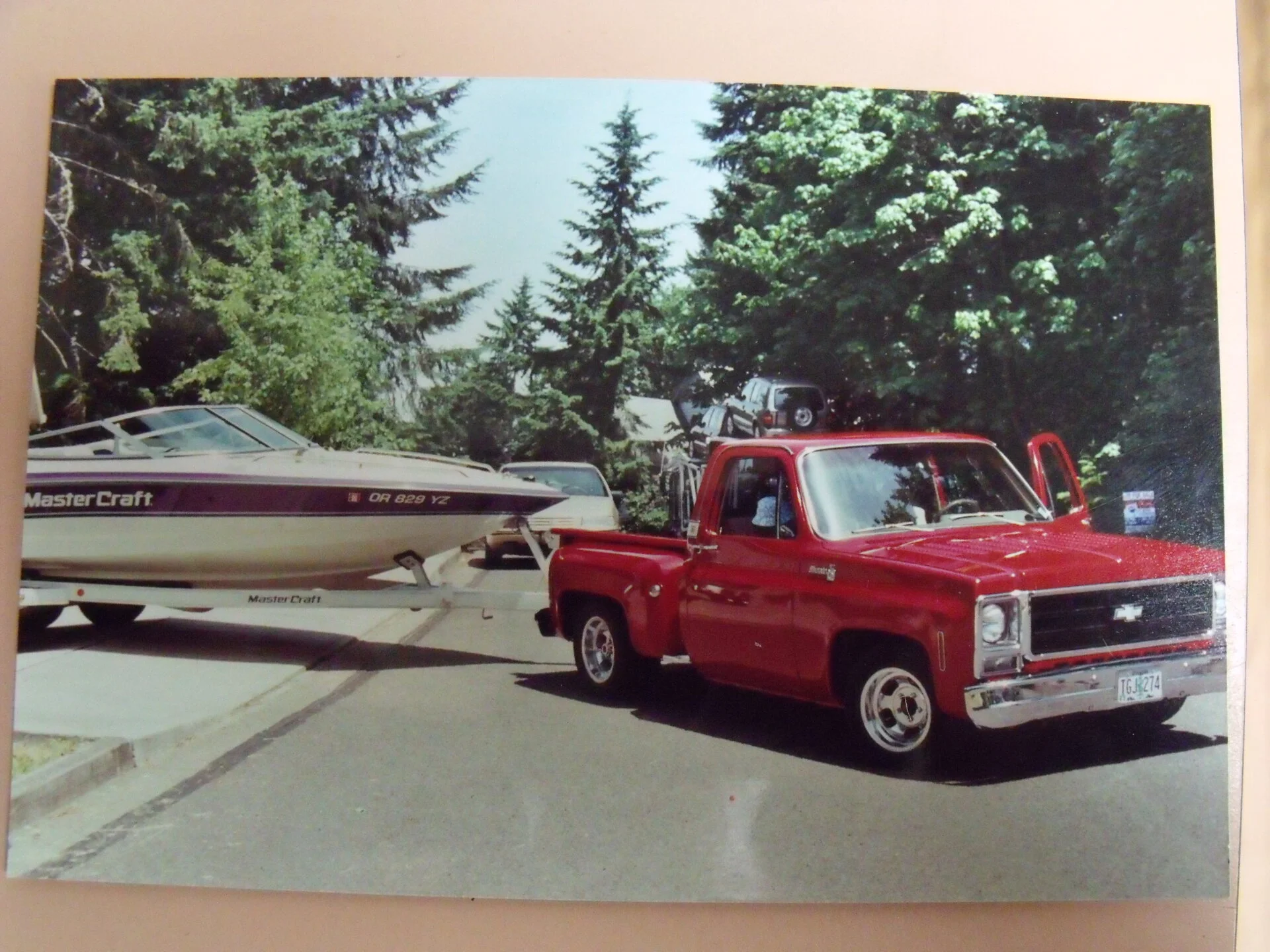

One would think a 2" drop would be a bit much on a fox body.....
Totally different animal, but I used 3" drop spindles and a 4" rear drop kit ( it relocated the leaf spring mounts) on my 77 Chev stepside many moons ago..... The 454/turbo 400 combination made a great boat puller....
You're dropping the height without changing the suspension geometry. I think these applications are more drag orientated anyway. I never really looked into it though.
You still will have some effects.. The lower a arm on the above truck would push gravel if I got into a crowned area/side of the road parking ......
