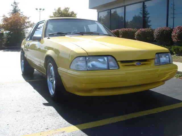

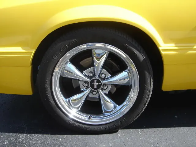

Here are 17X8 +3mm Bullit wheels (well, all 17X8's are +30mm) up front with 96-98 spindles. Everything else is stock fox.
The 8mm track width increase was not even noticable. I had this car at the same time I had my 91 notch with 94-95 stuff. The 96-01 spindles seemed to make the yellow coupe handle better. That car rode so nice.
