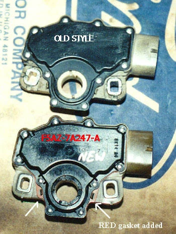

Early versions of the MLPS were not properly weather sealed and would go bad over time. If yours is one of the earlier ones it may be bad. Newer versions of the MLPS have a visible orange gasket, like in the image below:

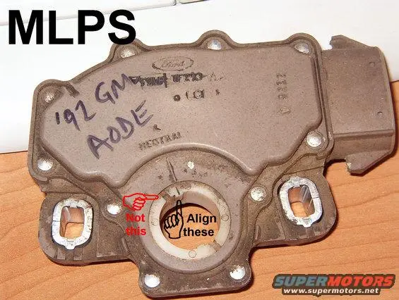

While you're there, double check that the MLPS is aligned correctly. Put the car in neutral, and check if the two lines are aligned, as shown below:
If they're not aligned, loosen the bolts and rotate the MLPS until the lines are aligned as close as you can.

THANK YOU Chythar i appreciate the pics. I am thinking the MLPS may not be aligned correctly because once again today I was unable to start my car in park for the first time, but after driving for 5 minutes then starting it up again it worked. I will have to wait till tomorrow when I am back at work to have it up in the air to see.
If I had the MLPS aligned wrong how sensitive is the alignment? This really started to happen after a day of racing around town and on the highway. Could driving my vehicle how it should be driven (Hard) cause the MLPS to move out of alignment? When I replaced the sensor it seemed to be aligned? Like I said this does not happen when I manually start in first gear, and after 20-30 minutes of driving it will up shift and down shift after letting off of the throttle...

I missed the part where you had replace the MLPS already. If the bolts on the MLPS weren't very tight or came loose, it could definitely cause issues. Especially if the sensor kept moving around. The shifter cable is obviously how you manually select gears with the shifter, and the MLPS is the only way the computer knows what gear you want. The only electronics in the auto shifter is for lighting.
I don't know how precise the MLPS alignment needs to be, but since you're having troubles it can't hurt to align it as perfect as you can. As to play in the shifter cable bolts, I don't remember how much play is allowed, if any - it's been a while since I've owned a Mustang with an AODE.
