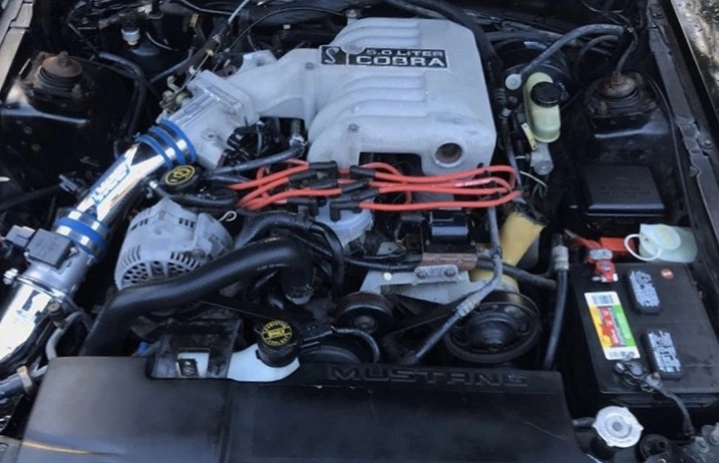

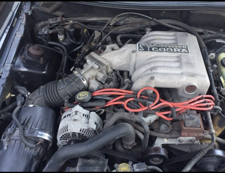

Below are pics of my engine bay when we bought the cobra and then to now after a minor clean up and detailing.

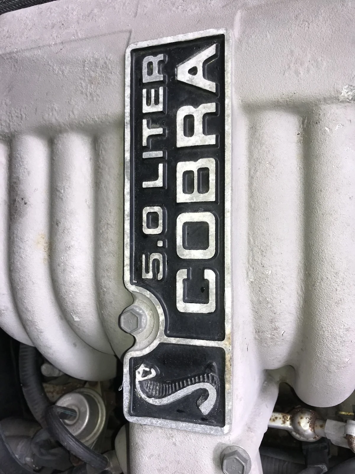

Also for removing the manifold just have some questions. I know I’ll have to remove the CAI and throttle body, two vacuum lines from the tree and then the 4 or so bolts on top. Will I have to replace the throttle body gasket after removing and replacing. And for painting the manifold itself? What would be the best way to paint the black insert for the Cobra plaque? Thanks in advance

Do yourself a favor and have it power coated, the intake not the cobra insert. I don't about the cobra plate, I got a nice one in the stash box.
Isn’t powder coating quite pricey? The rust oleum yields great results I’ve seen and can have it done in a weekend. My mistake, it seems on the 94-95 cobra it isn’t a plaque like the later cobras and it doesn’t have it for sale like the 93s

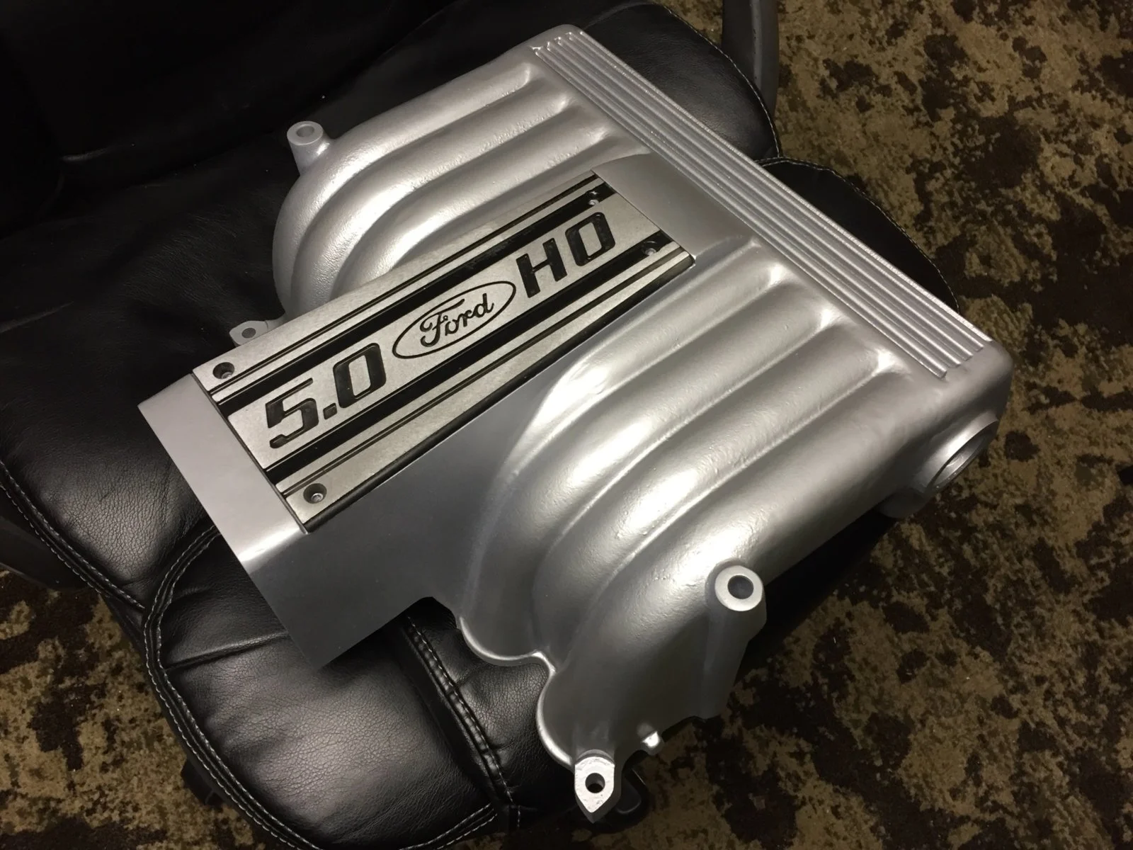

Paint the intake, tape off the plaque area ad paint that black, and then hit the raised lips with a sanding disc for that fresh machined look.
What do you recommend as far as paint prep? And paint the entire intake including the plaque area, and then going over with black. I also plan to do the valve covers gloss black while they’re available
I stripped my intake, but ifyour finish isn’t too bad, you can scuff it up and paint over it. I stripped mine using Citristrip.
After that, mask off everything except the black area and spray that. Give it time to cure, then take a 5-6” sander with a light grip and clean up the lifted boss areas to make it look freshly machined.
Similar to how I did mine

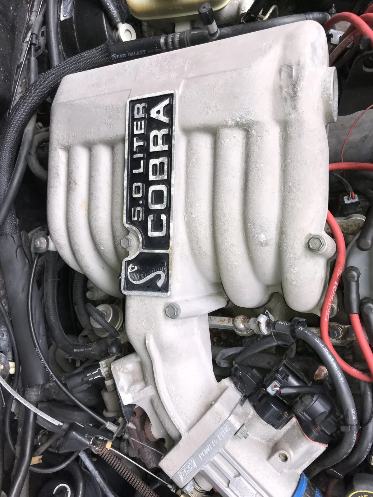

Thank you very much! I most likely will strip mine as it’s peeling and I want a uniform finish. Just bought the rustoleoum cast coat aluminum paint for only $5 on sale! Attached below are pics of my intake now.

As far as paint prep, I’ve always liked to clean the outer surfaces with carb cleaner, then wipe down with wax and grease remover. The carb cleaner will actually loosen up existing paint for easy removal with a wire brush if you choose to do so. Then I always use some self etching primer followed by the topcoat of choice. Done quite a few this way and it tends to last for a good while.
