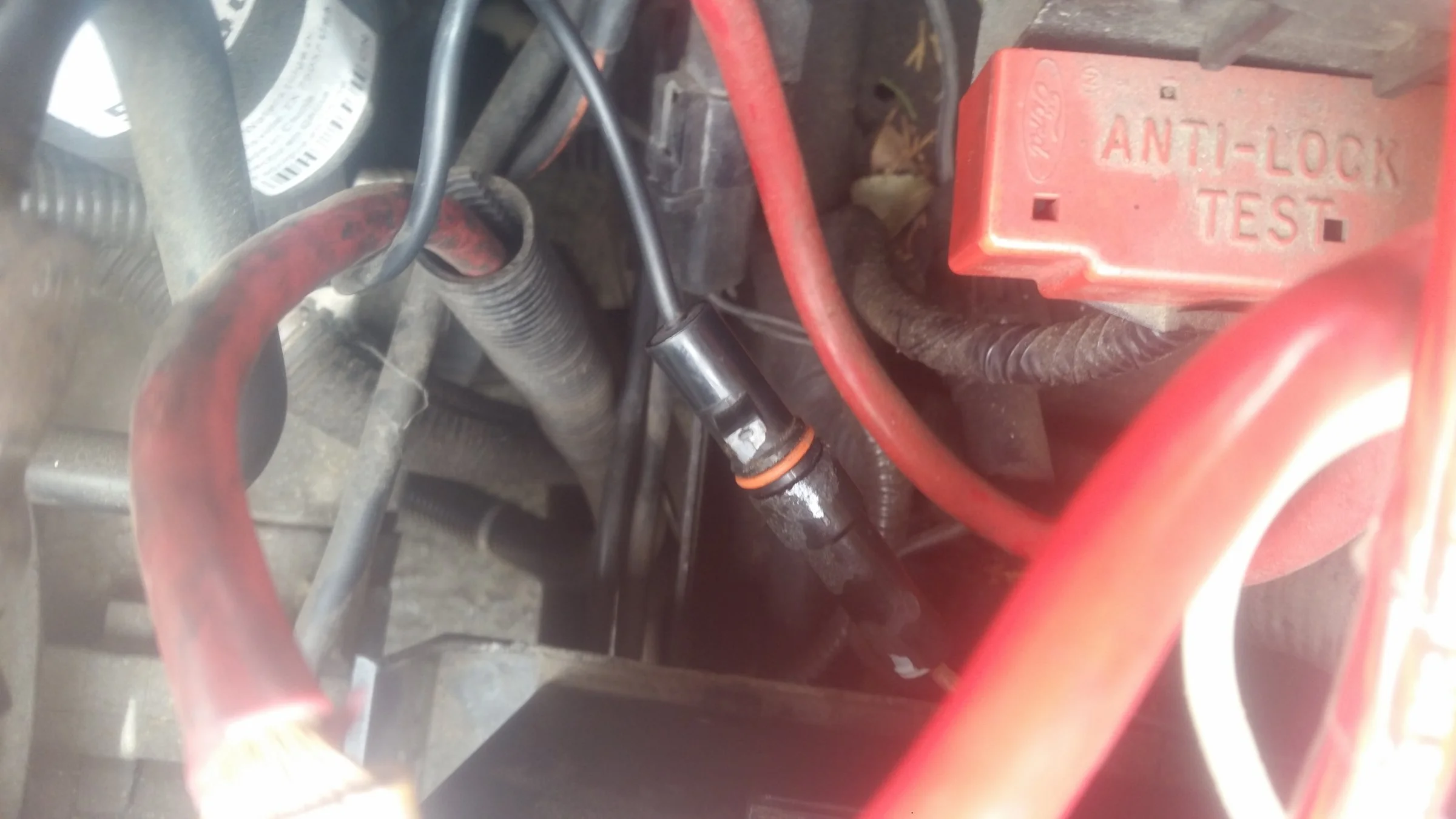

After checking for spark (first step of no crank checklist) I noticed a small circular connector about the size of my pinky in between the battery and starter it appears the clips on it had broken and it was basically just floating so I connected them firmly and car cranked right up
One end follows starter cable down and couldn't see where the other end goes anybody know what this connector is? I taped it to hold it temporarily but would like to replace it
This is it it's right between the battery and fuse box/starter plug

No the black end visible in the picture runs down with the power to the starter and the other end is a pink and white wire that goes into a wire cluster coming out of the fenderwell
Alright so I traced the black wire it's a ground to the starter (atleast appears to be) the other end who knows but I decided I'd just superglue it n it's starting n running fine for now but if I do ever find out what it is ill let ya know

I think that's actually the starter solenoid energizing wire, I don't think there's a ground that runs to the starter. A tip for you if you need to rig a fix to a connector where the clips have broken off over the years, use a drop of RTV silicone instead of super-glue. It's really easy to pull apart if you need to, but it'll stay together through all the vibrations.
10-4 atleast I know what it is now thank you downside is after superglueing it together it ran good yesterday (to gas station and store) then this morning wouldn't start for work so I'm going to check under the fuse box maybe it's got a bad connection to the relay
That wire, as it attaches to the starter, is often corroded and ready to snap off. It's a skinny blade connector exposed to the elements. I'd start there - clean it and make sure it's nice and tight. Be careful not to snap off the blade on the solenoid or you might need to replace the starter.
