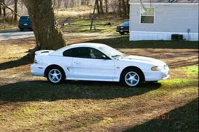

Hey guys aint no newb but i got my old mans 95 gt off him hes had it for 8 years and has 92,000 on it all stock and looks like new evan has the waffles on it. I plan on leaving it mostly stock whut gears you guys running and heard these are hard to modify with the computer they got

EDIT: Just saw the pic, looks good! White has a lot of possibilities.
