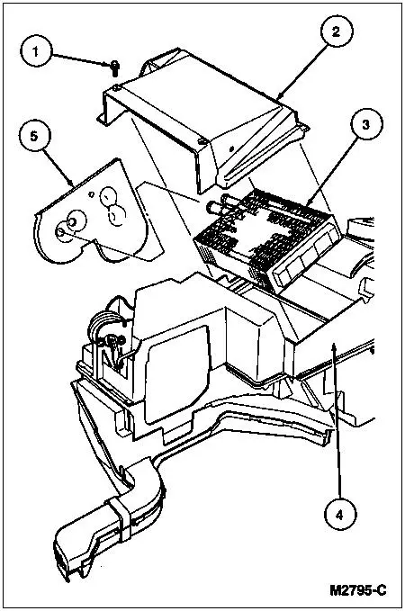

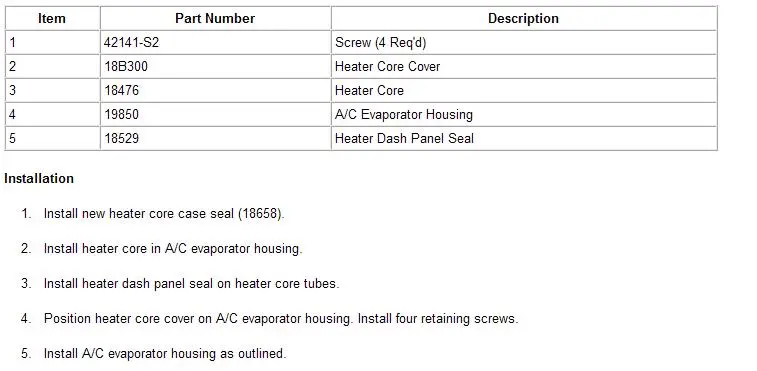

NMStang218 New Member Aug 15, 2003 19 0 1 Mar 29, 2008 #2 Mar 29, 2008 #2 Its a little hard to get to but once you do, its pretty straight forward. Hope this pics help. Attachments heater1.webp 11.5 KB · Views: 142 heater2.webp 38.3 KB · Views: 152
NMStang218 New Member Aug 15, 2003 19 0 1 Mar 29, 2008 #3 Mar 29, 2008 #3 2 Attachments heater3.webp 17.1 KB · Views: 168
