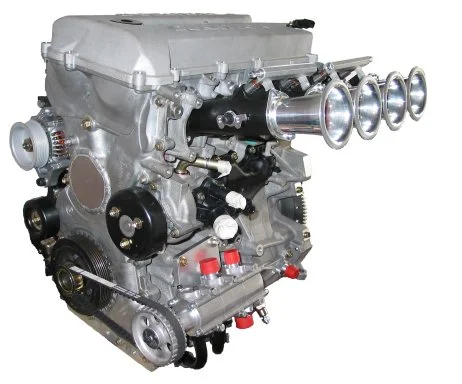

The Duratec 2.3L is used in the Ranger, is DOHC, and has a ton of go-fast parts for it from Cosworth. Its pretty pricey compared to a 5.0L build, but apparently 250 HP is fairly easy to get. Then there's always the MazdaSpeed 2.3 Turbo engine...
