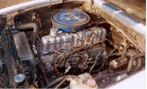

Lately, I've been thinking about dropping a warmed up 250hp 300 inline 6 in a Mustang. Not sure if it'll fit in a II without moving the firewall some, so I might have to use a brick 'Stang for the project. I'm thinking 30 mpg with a T5, and more low end torque than the Mustang could hook.
I found this pic on the web a long time ago. Unfortunately there was no detail.
I'm betting its a 170 ci or 200 tops...it just fits too well. :)
There should be a bunch of 200's floating around in mid-'80's Fairmonts and Zephyrs...
