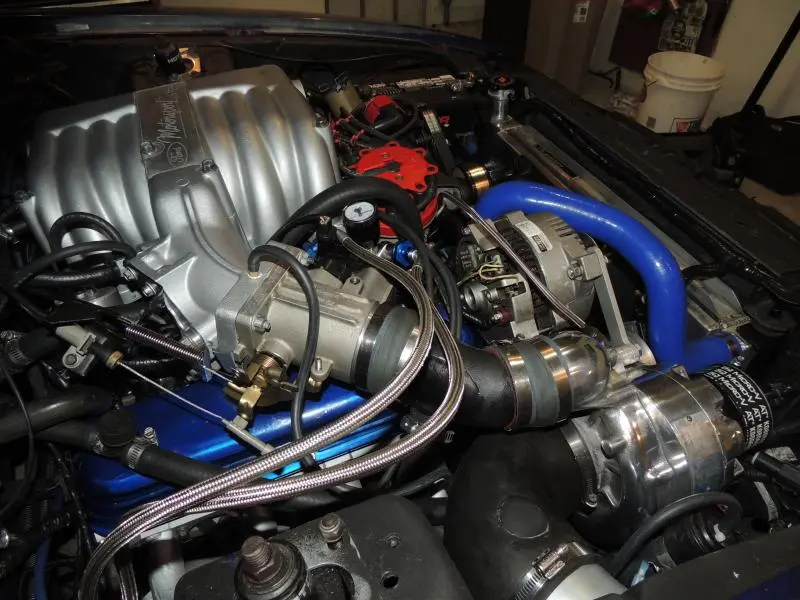

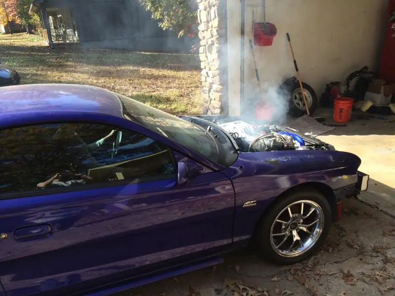

First start up.

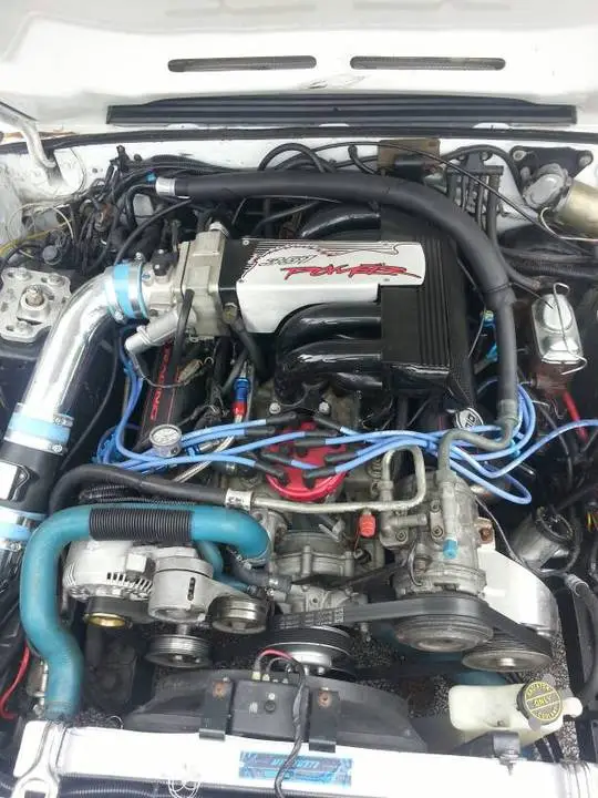

I had some time this week to work on the mustang. I have been experiencing a bad miss at all rpms, the engine would cutout within a few minutes and wouldn't start back up until cold. It didn't take to long to figure out that a relocated SPOUT connector was the source of the miss and dying issues. I returned the SPOUT connector wiring back to stock and no more miss or dying. It was deffinately getting a trash signal with no shielding.
Finished the rest of the engine bay up. Hope to drive it next monday.

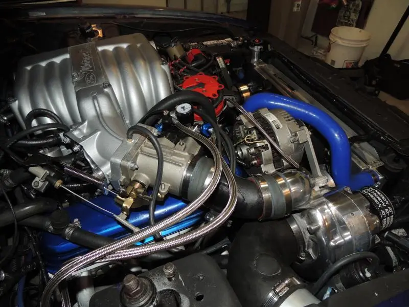

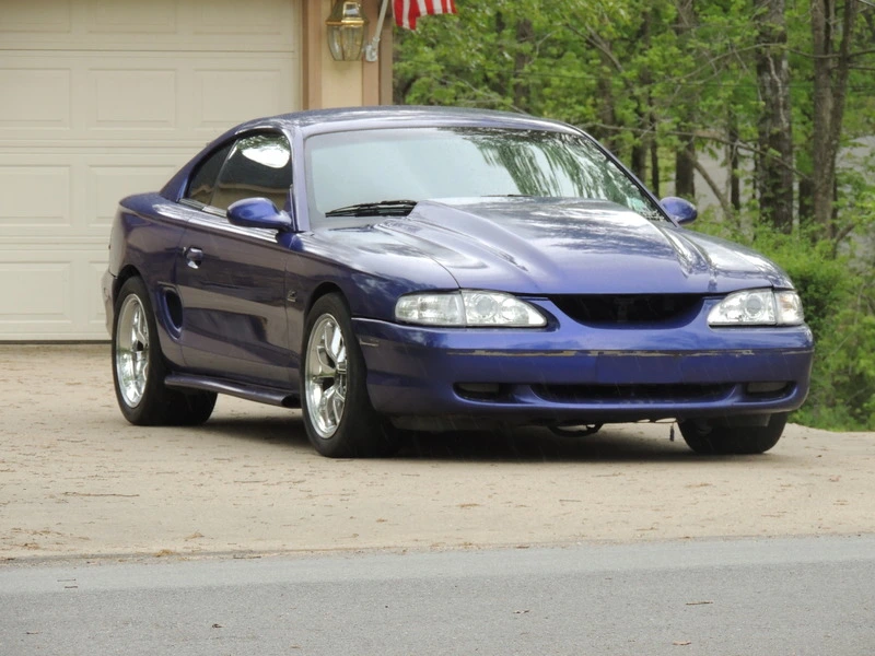

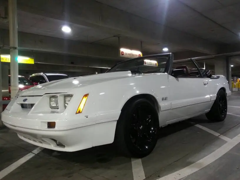

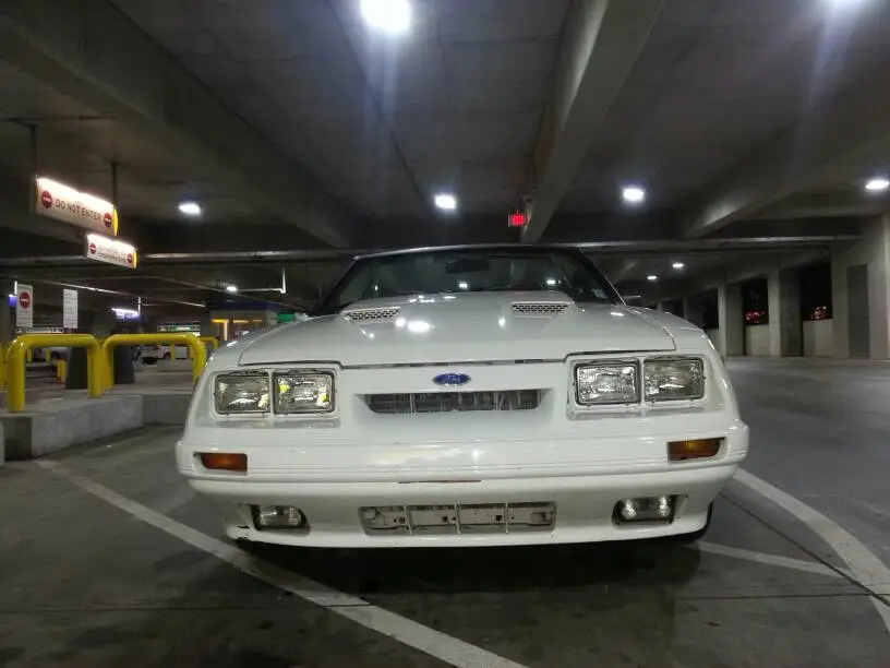

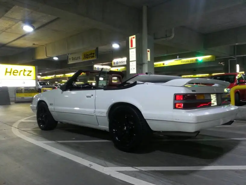

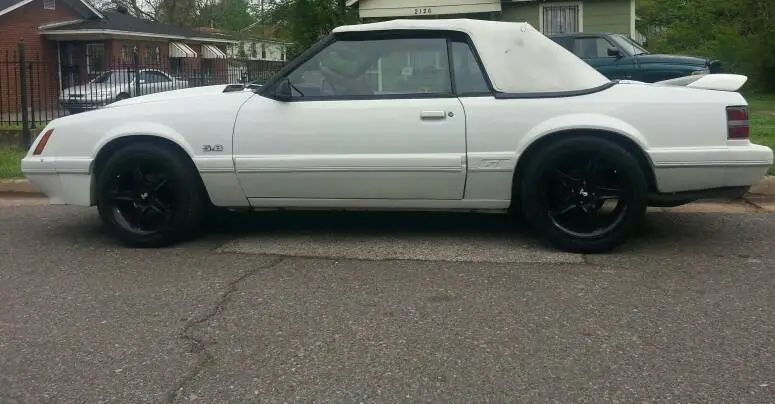

This is a late update, i apologe. The car is complete and almost all of the bugs are worked out. here are a few pictures of her.
If you ever thought about a 351 swap with a blower or turbo. Do It and you will not be disappointed. This car drives, in everyway, differently that a modded 302. It drives anyway you could imagine a good built street engine should. there is no lag, no bogging, i can drive the car at 1200rpm in 5th gear and still pick up speed easily.
Looking bad ass, especially considering what you started with. However, we need a video or two of her running and driving if it can be managed. There isnt a single one of us in here (except the crazy Alabaman) that wouldnt want to flog that thing around town.

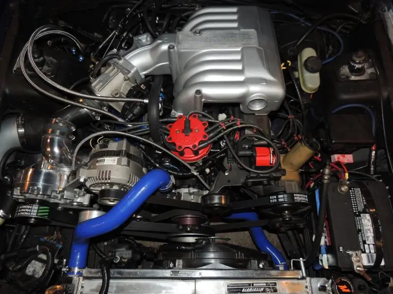

Will do. I have pull the engine back down. There are bad vibrations in the rotating assembly. The project is getting better by the day. Will post more pictures of the tear down
Good looking convertible. I like the torque and overall power of the vortech vs a turbo. however I have only owned 4cyl turbod cars and one v6 twinturbo. This combo of big displacement and forced induction is rare and it drives very well.

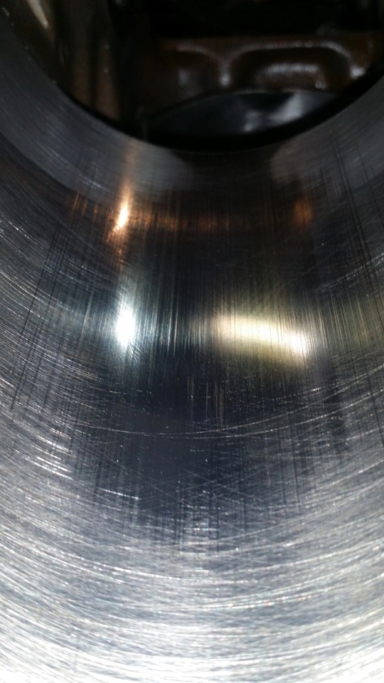

I last posted the vibration issue i was having with the 351 immediatly at first start up so I want to give some history and progression of events. 1 to inform and 2 just for fun reading. i replaced the flywheel and harmonic balancer with no fix. I drove the car with the vibration for 600 miles or so. After a few metallic oil changes, I decided to pull the motor and check it out.
This is what I found.
Bad scuffing right? but only on cylinders 5-8, the other side looked normal. As I dug deeper, I found the rod bearings, only 5-8, had heavy wear on the radius side of the crank, everything else was normal and clean. With this info, I called the machinest and he was equally confused until he asked me which way I installed the pistons on that side. Of course I had installed them correctly but quickly realized that he had installed the rods backwards with the rod chanfer inboard and I did not catch it when I put it all together.
This led to the rod binding and piston scuffing. One Catastrofic problem waiting to happen and vibration source found. On to the second cause. The pistons were much lighter than the stock ones, which could have caused a very small issue but really shouldn't have been felt.
