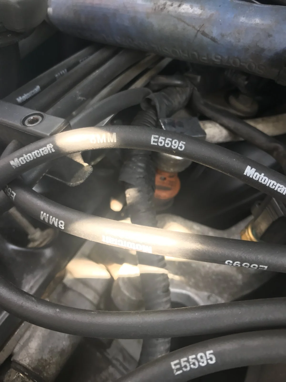

Like burns said, non-pi manifolds may not be the same size on the primaries.
What color are the injectors.
Think they are orange, always get them confused with the spark plugs
