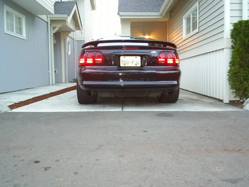

The car looks extremely sweet! That is what I am going to put on mine is 18x9 & 18x10.5's sometime next year. Can you do me a favor though and take a picture of the back of the car so that I can see if they sit flush with the rear fender or how far off they still are?
