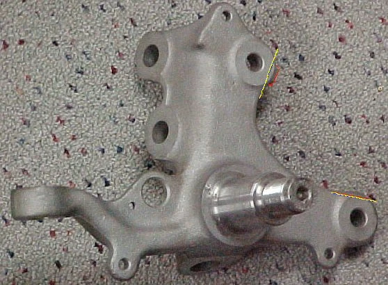

I've been running stock '99-04 PBR calipers for over 5 years and have never had any problems. I got them cheap, like $50 with pads, rotors, soft lines and banjo bolts. The rotors are the same as stock ones on my '95 GT and the grinding is just a little bit on the back of the spindle so that one of the bracket bolt holes lines up correctly. Takes about a minute with an angle grinder to do each one. They do have more stopping power than the stock '94+ GT brakes and are a lot lighter.

Also a pic of where the spindle needs to be ground...

Remove the calipers with the brackets from the spindles. You should be able to get the '99-04 calipers with brackets from the parts store along with the lines and they are a direct bolt-on with the exception of the bit of grinding on the spindle bosses. Make sure you get the lines for '99-04 because the '94-98 lines won't fit the calipers.
When I did my swap, the parts I had were from a buddy that upgraded his '99-04 with bigger cobra brakes and sold me the calipers/brackets with lines attached all one piece. After grinding the spindles I just bolted them on and connected the line to the hard line in the wheel well then bled them.
