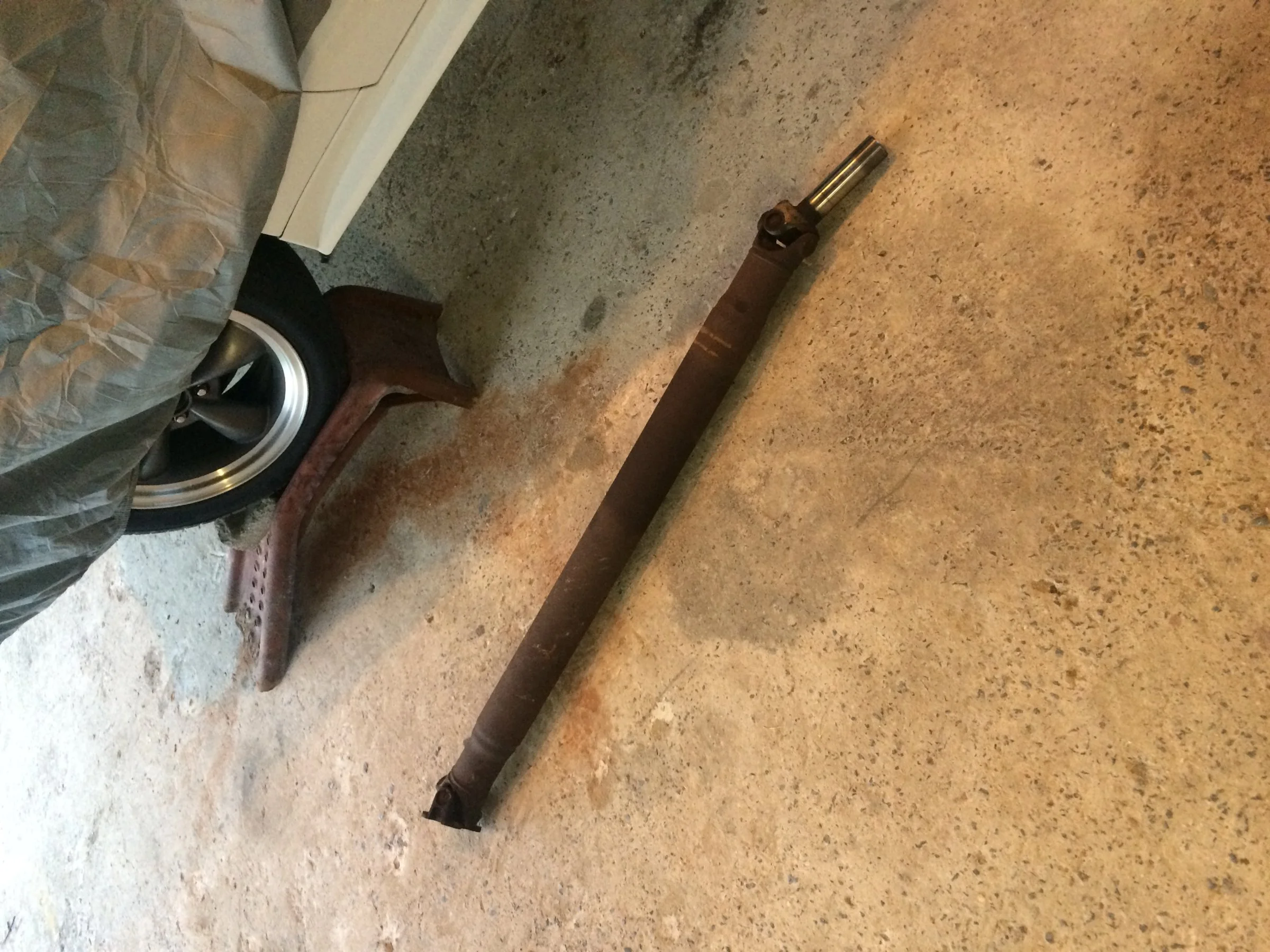

If I can't find a good deal on one by the weekend I'll probably spend extra money and just have it rebuilt because I really want this thing back on its wheels, I kinda enjoy it,But anyway got the drive shaft out last night, definitely had never been removed before,
