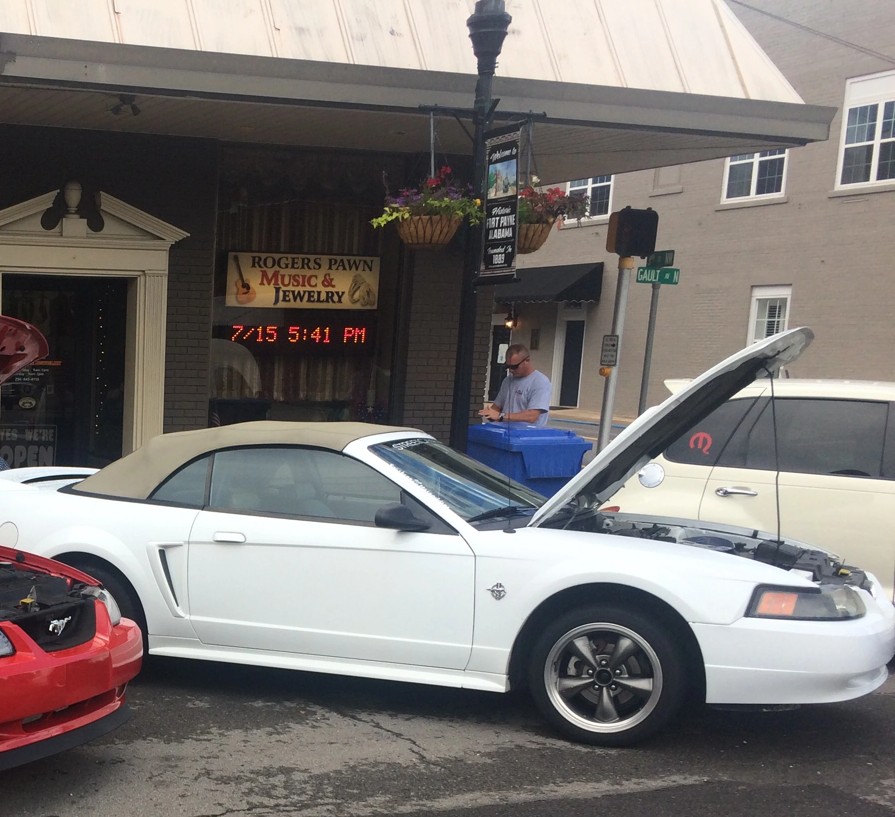

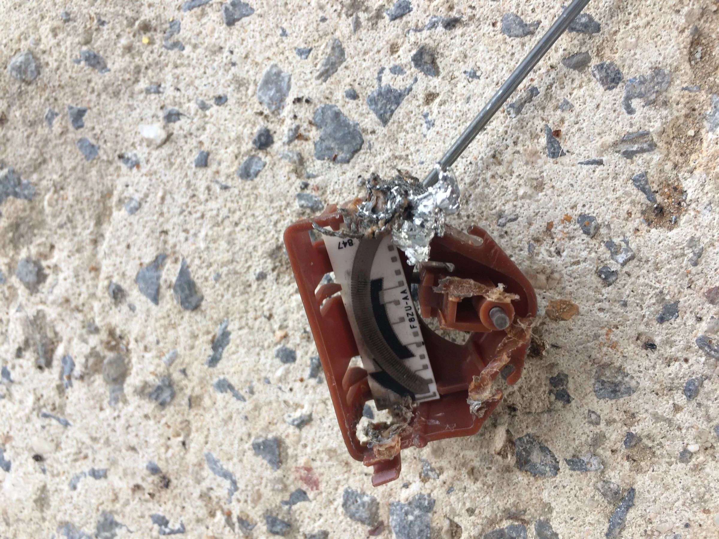

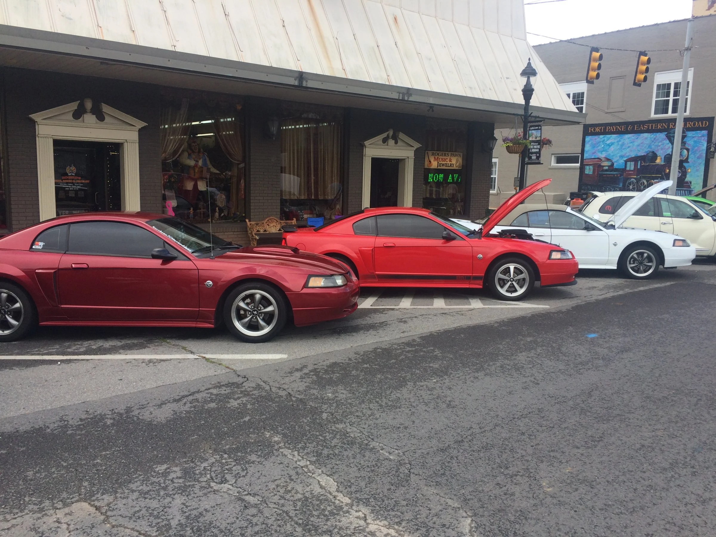

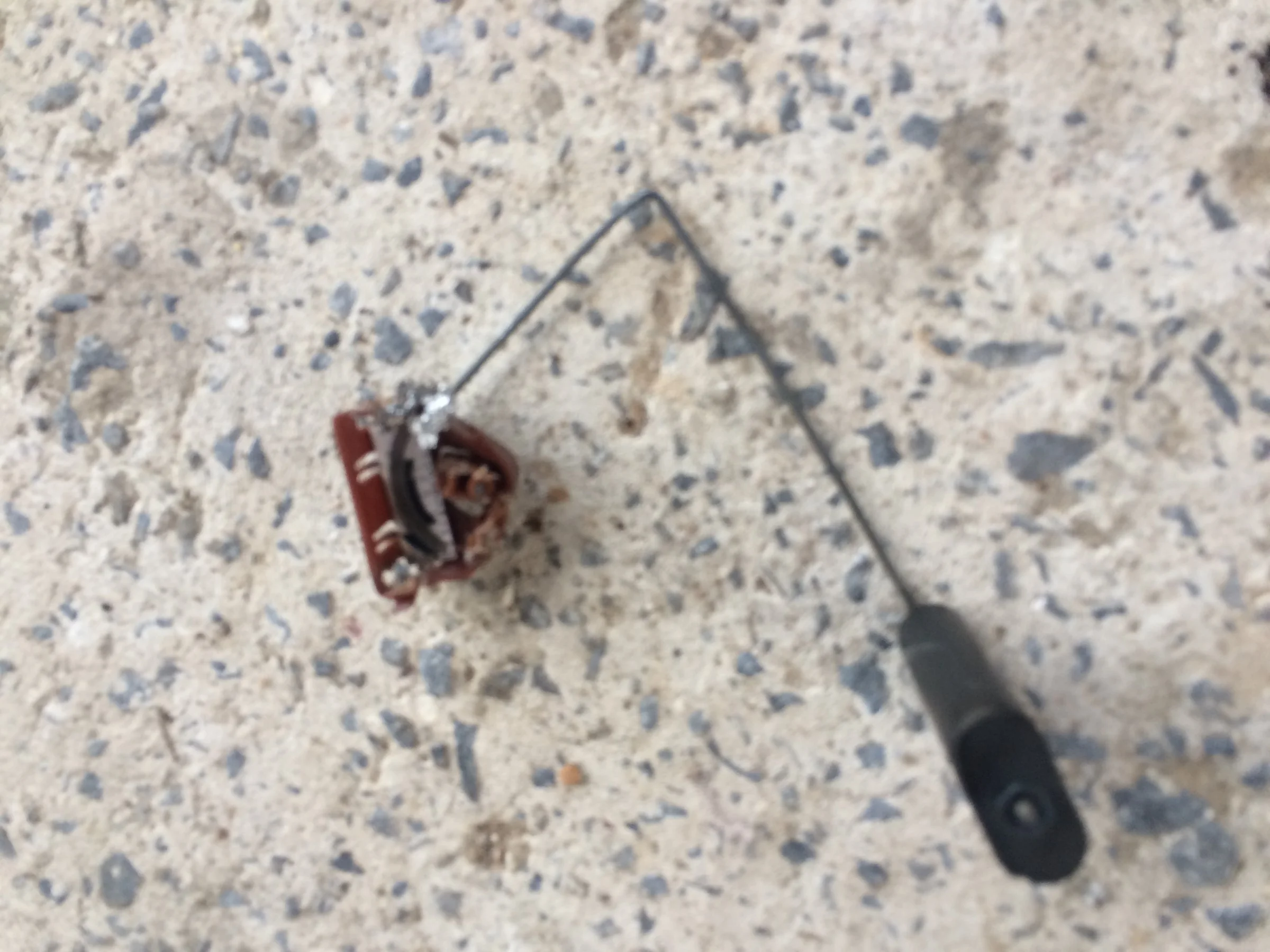

Got my fuel pump and swapped it out. The car runs amazing now, and it fixed my fuel gauge as well. I found out it seems like some hillbilly thought he was gonna fix it by soldering the float back together and it was just hanging on the sending unit by one wire. As you can see it was really rigged together. Anyway I was able to make it out to my local cruise in and was able to hang with some other cool mustang people

Looks like a good time.
Off topic, it's the wrong color, but I love those Mach 1s in Azure blue. Not enough to pay for the premium over a 2v but cool cars. I'd rather have one of those than a 99-04 Cobra.

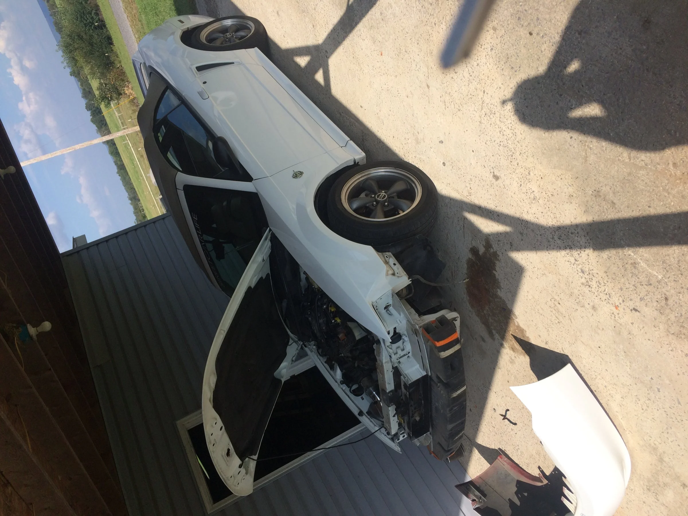

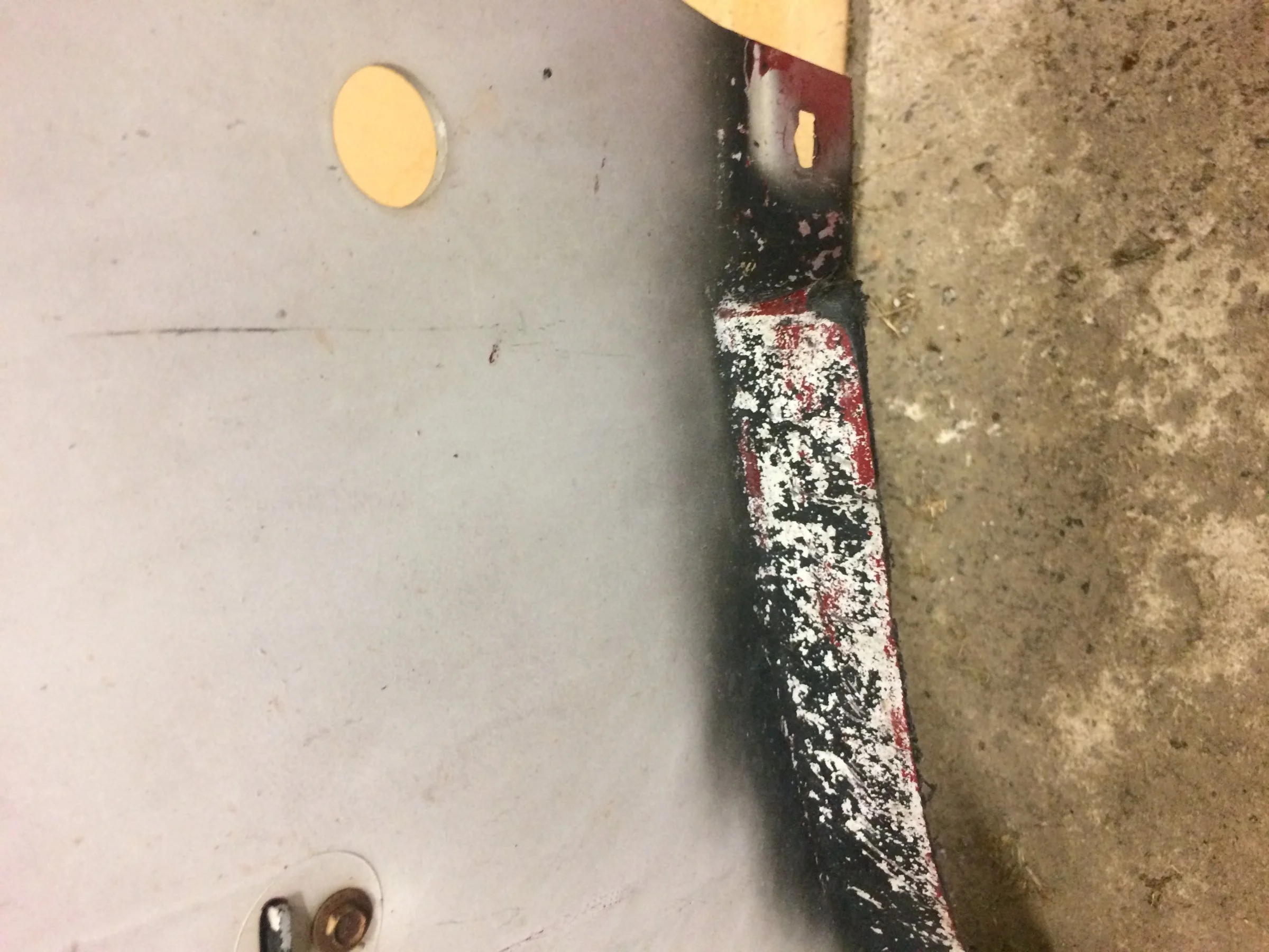

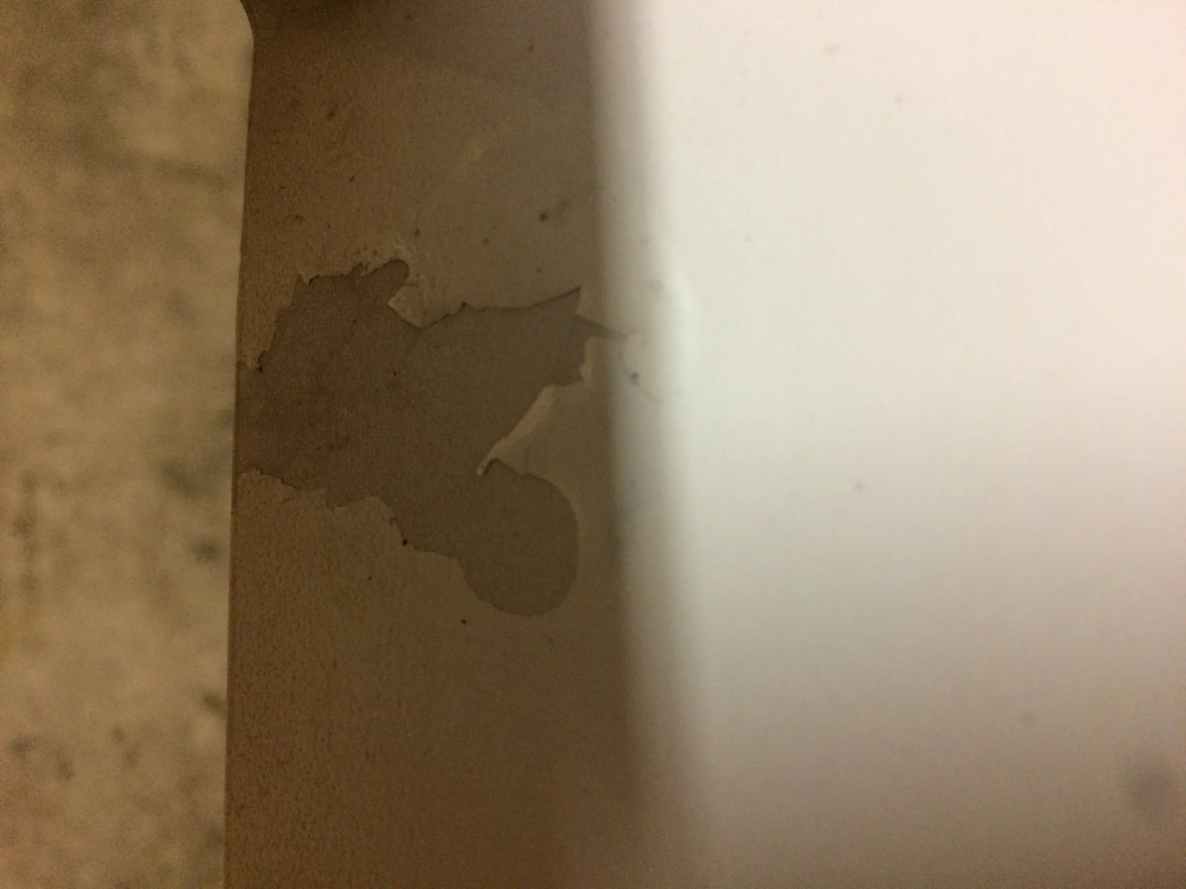

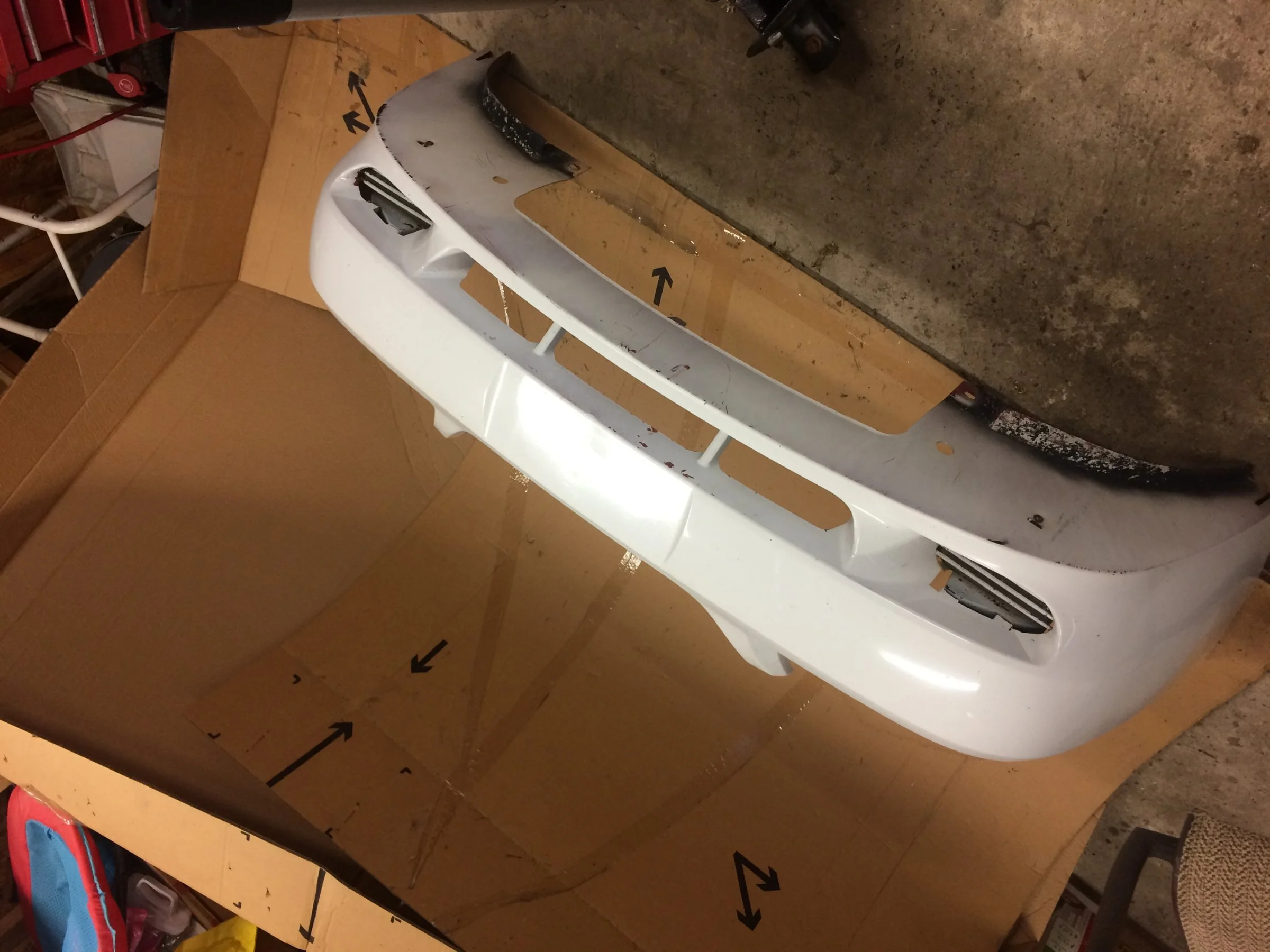

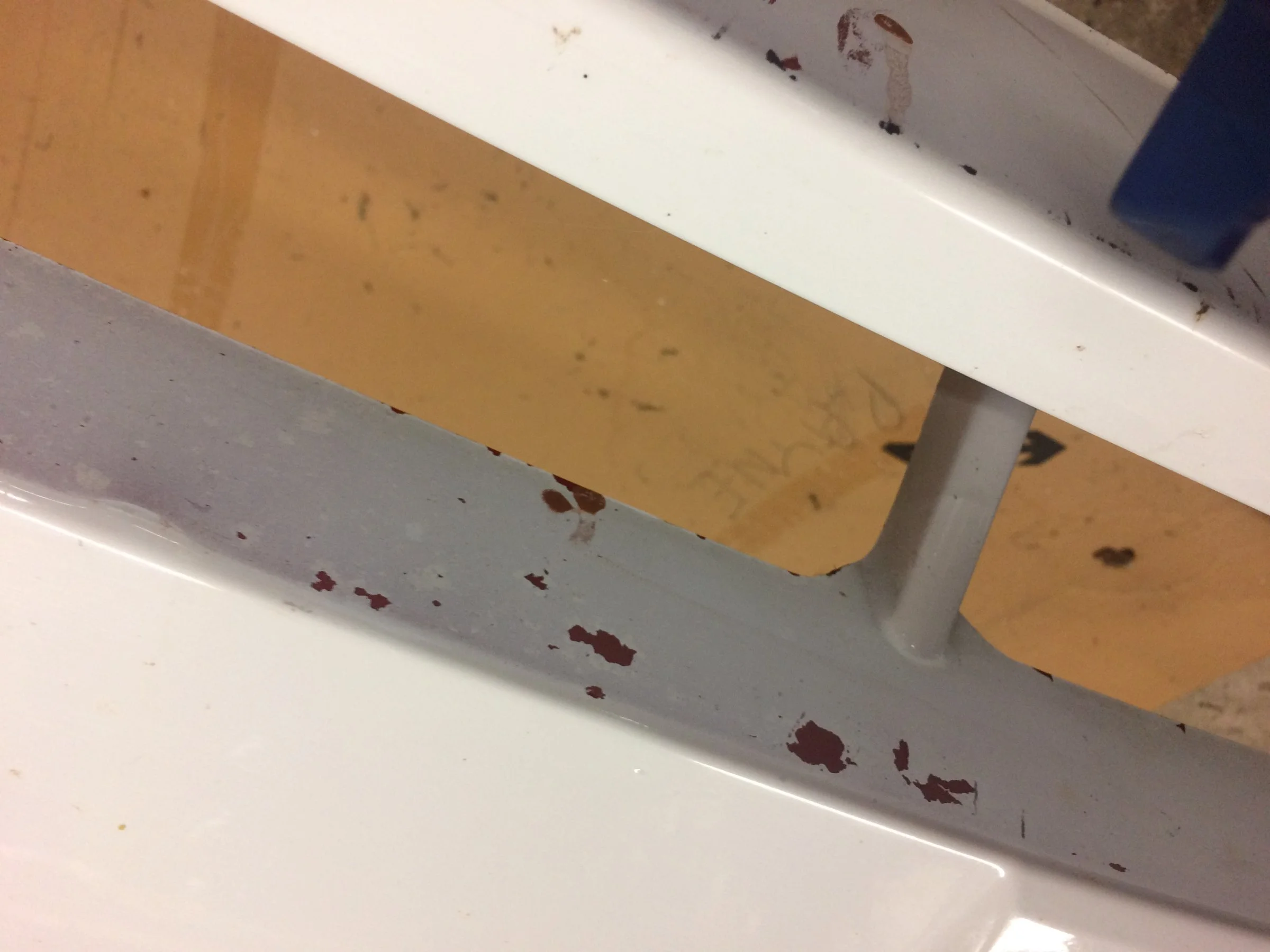

Okay so I started tearing down the car this weekend didn’t get very far. Removed the radiator and hoses pretty much all the coolant stuff and pulled the bumper noticed that whoever put this bumper on didn’t prep it correctly at all and the paint had been peeling for awhile anyway I noticed a big spot of clear that had bubbled up and was gone so I pulled the bumper and hopefully I’ll get it painted in a few weeks, my wedding is coming up so I’m real busy there but once that’s done and I’m back from the honeymoon I’ll be working on the car a lot more so keep on the look out for new updates and sorry for the pictures being sideways still haven’t figured it out
