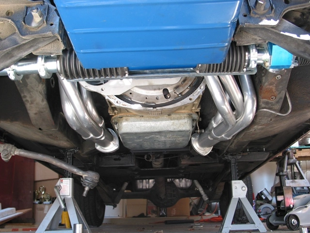

4.) No measurements handy but here's a picture of mine with headers on a vert. I'd say the X-pipe might be a problem, but I've decided I'm going to need some custom exhaust plumbing anyway since the vert is so confined underneath. The collectors on mine are behind the fat part so it might not be an issue at all.

you will not be able to use your headers due to the width of the AOD. i'm using summit racing headers for the 351W which work fine but hang a little a low to the ground. the 302 with the shorter deck hieght and not being as wide as the 351w any headers for the 302 will not fit. i also had to make a 1" engine block (motor mount) spacer so it would raise the engine to compensate for the wider headers otherwise they do rub on steering box.
