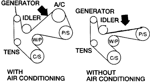

S SN95V600 New Member Feb 1, 2013 3 0 1 Apr 3, 2013 #1 Apr 3, 2013 #1 whats up guys i havent had a/c in a while but my compressor is the only thing left there i wana ditch it but dont know how to go about routing the belt and what size i dont have UDP and i wana keep pwr steering thanks for your time guys
Noobz347 Stangnet Facilities Maint Tech... Er... Janitor Admin Dude Jan 4, 1985 43,264 21,445 234 Box behind Walmart Apr 4, 2013 #2 Apr 4, 2013 #2 4.0L Vin X OHV on the left and 4.0L Vin E SOHC on the right
