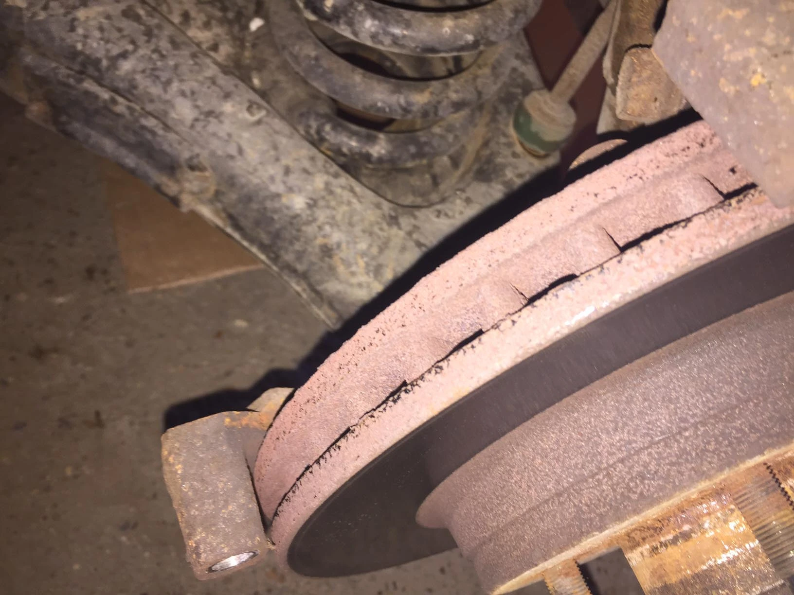

I am the new owner of a 90GT and It makes quite the earth-shattering rattle sound over bumps and I believe it's coming from the front brakes. The sound disappears entirely when I depress the brake pedal.
When I let off the brake pedal and go over a bump the clanking sound returns.

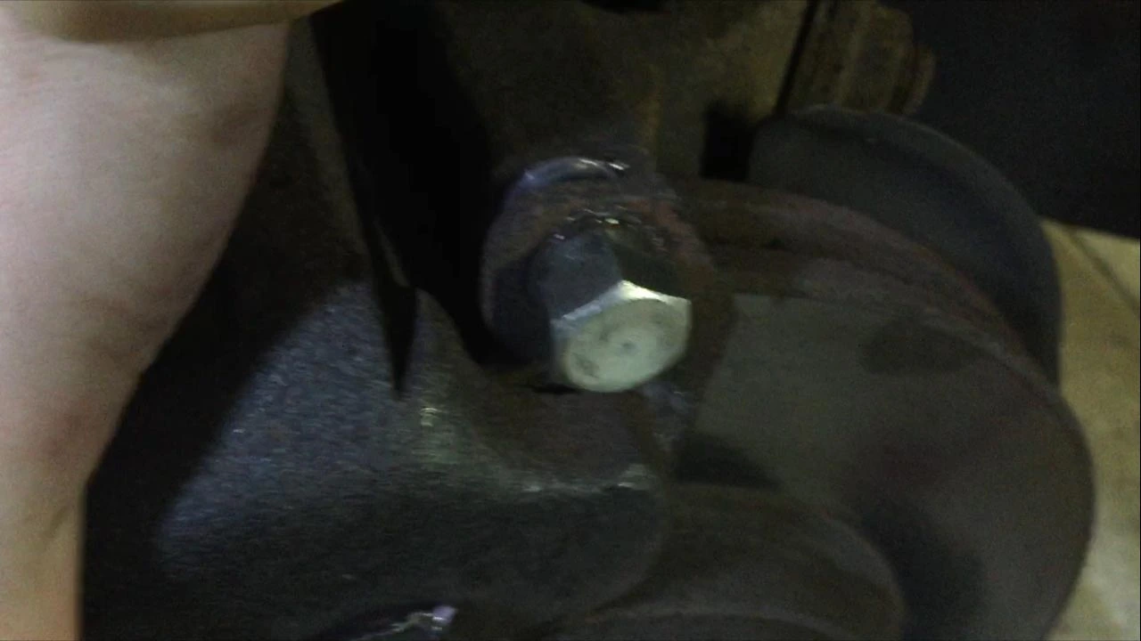

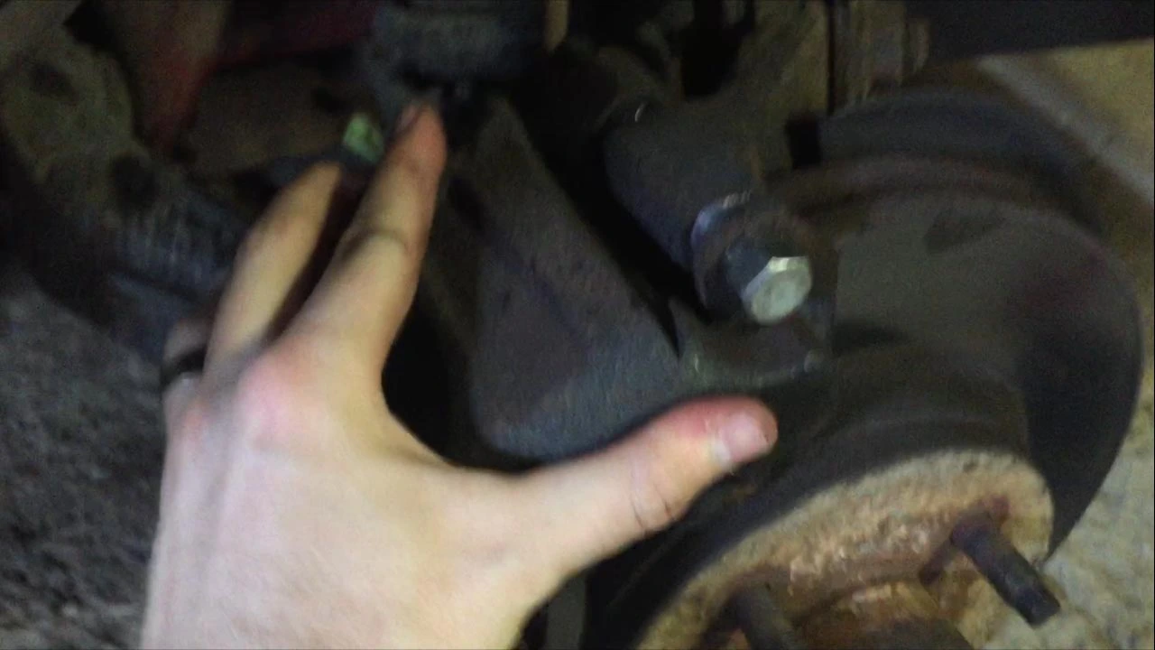

I had the car up in the air today. I didn't feel an extensive play in the wheel bearings. No obvious damage to the sway bar links or ball joints, So I took the brakes apart. (see pics)

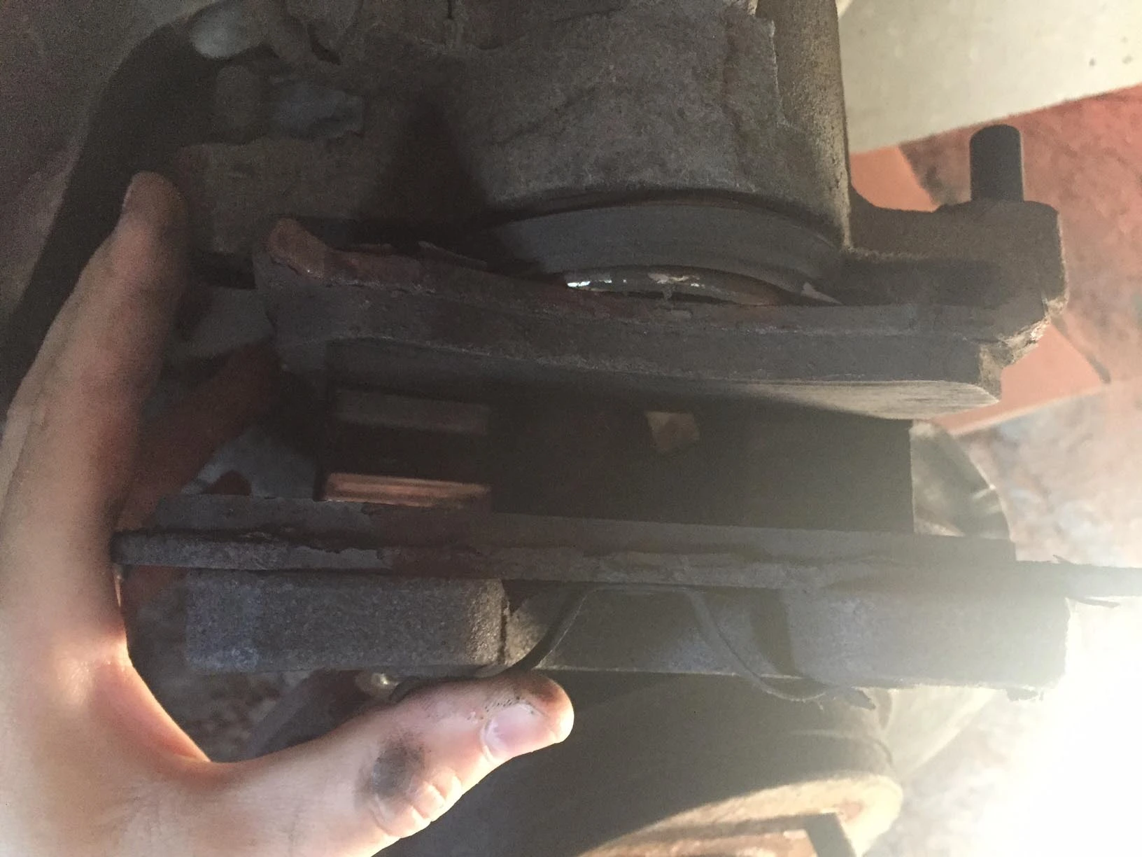

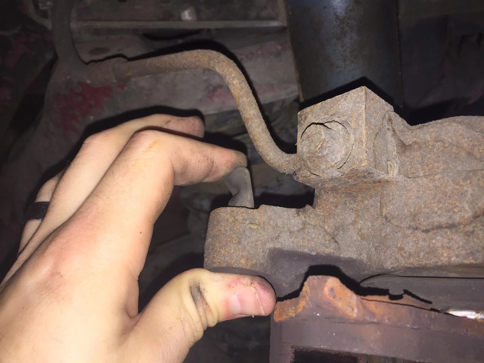

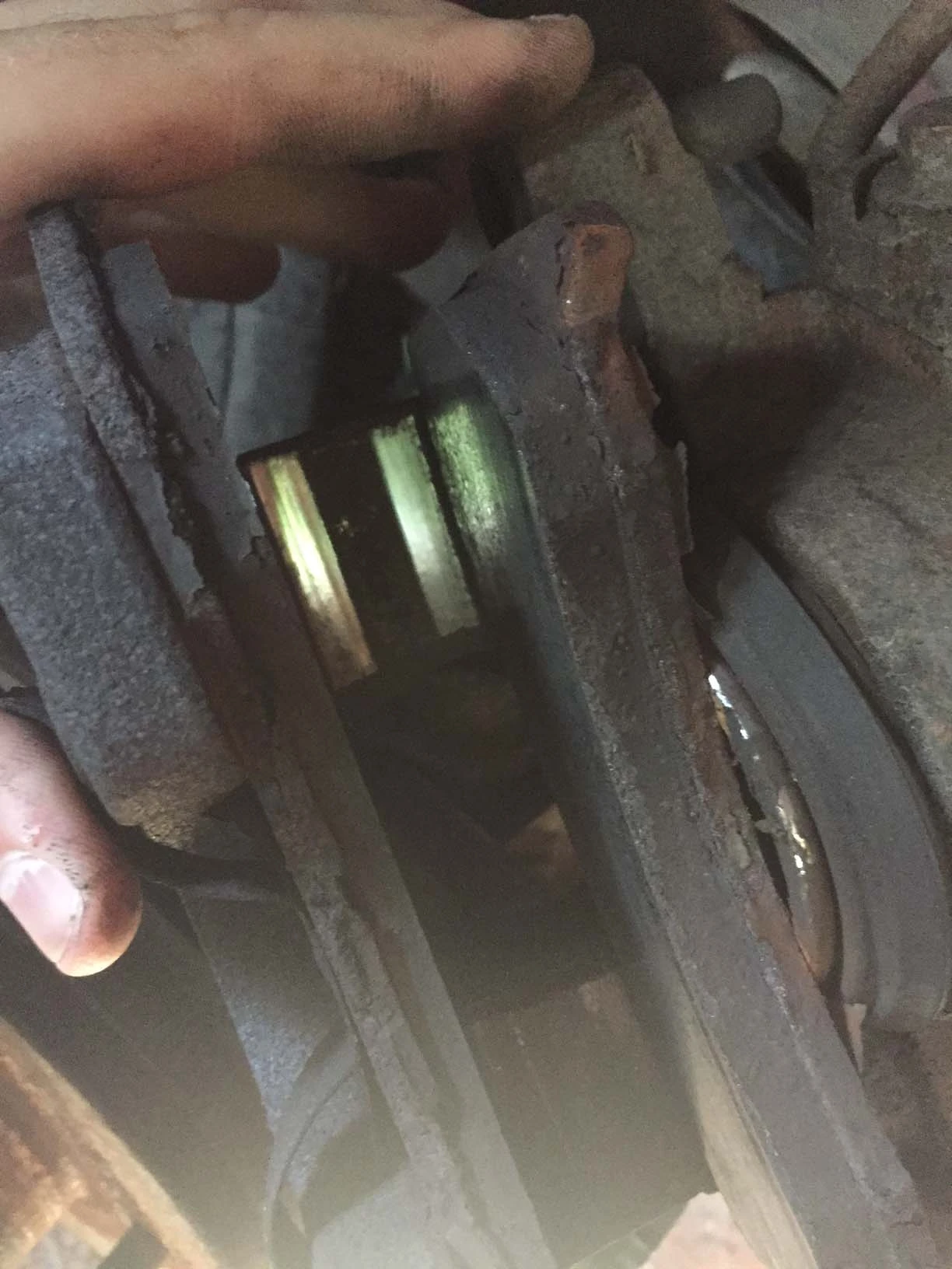

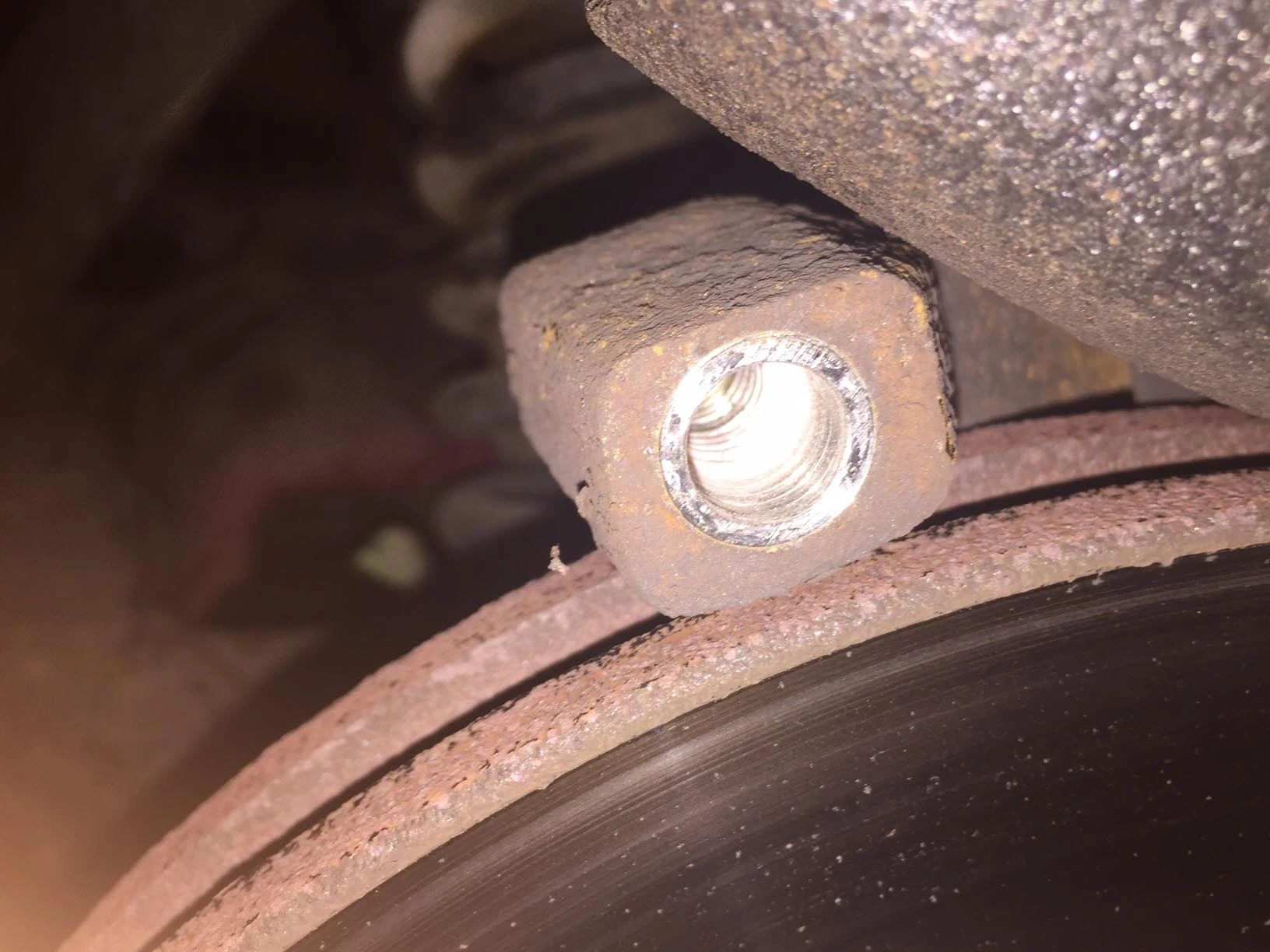

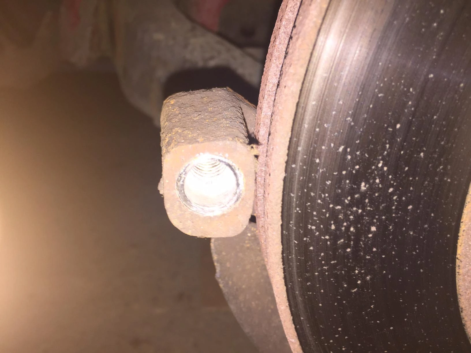

The pads and rotors themselves look decent, I've seen a lot worse. The caliper looks like it's rattling enough that its making contact with the rotor while it spins causing the shinny area on the inside.(see pics) I took everything apart, cleaned and lubricated and still have the same problem.
Now I purchased the car a couple weeks ago and the guy I bought it from said he replaced the caliper pins in an attempt to fix the problem, which has me wondering, Is it possible I have the wrong ones? They aren't from LMR but they do look like this:

The brake pads are specific to the side of the car. If you put them on the wrong side, they'll install just fine, but now the oval holes are oriented wrong, and they allow the caliper assembly to rattle up and down against the pins. Installed properly, the flats on the ovals prevent this. The pads will be stamped "LH" (driver side) and "RH" (passenger side).
Hmmm... I didn't install these pads originally, but I suppose that could be the problem.
I definitely think the caliper is rattling up and down because of how it's gotten shinny on the inside of it next to the piston.
I'll check the pads and see if they are on the wrong sides. There is definitely up and down play in the caliper.
I've seen this issue before, and it usually is a cause of the pads having wide slots that the pins fit into creating a lot of slop. The size of these holes varies between the different brands of pads. It's also possible the slip has worn out the opposite side in the caliper that receives the pin, causing even more movement there.
Reman calipers and pads are cheap, I'd probably just go through the effort of replacing it all at this point.

The pads were definitely the wrong side. However the noise is continuing. I think the holes in the pads that the slides run through are part of the problem. They are huge!
I figured new parts were in my future, but was hoping for a quick fix. Would rather spend the money on go-fast parts. Oh well.
