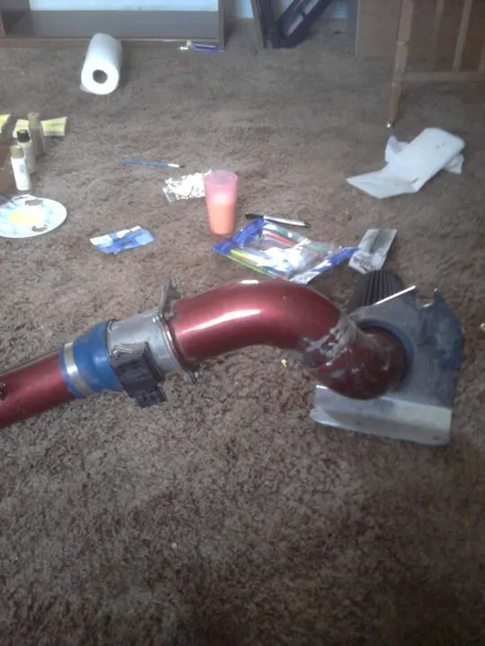

Post a picture of the this intake with cold air kit installed. If you don't use the elbow you can change the SN95 (94-95) throttle cable to a FOX style (86-93). I think that's what you'll need to do. There are sticky's on how to do this on Stangnet. It will tell you the things required to purchase in order to complete the swap. I'd like to see this intake.
Well it is what he said it was but the intake and cold aire werent connected. I have a picture of the BBK cold air oddly with a new KN filter on it. Mighta been a little bit smartass with the 20 minute thing by the way. It took a hour or so and not totaly finished but close.

Well finished it isnt. I had all the parts except the throttble body which for some reason wasnt on the intake. he went to his friends to figure out where it got off to. i had a few hours so i painted the upper and lower intake valve covers stuff like that. Well the throttlebody is missing so he refunded $50 of the $150. But Im in a pickle now. Is there a strait adapter that will make my throttlbody fit? Or will have to get the elbow adapter? Also where can I find the elbow adapter? I looked on ford racing performance parts page and couldnt find it. Also since the Cold Air kit wont fit with a elbow ive looked at ways to shorten the cold air tube. will that hurt anything?
Well I found this if it is what i need? http://www.ebay.com/itm/94-95-MUSTA...Parts_Accessories&vxp=mtr&hash=item3a6ef144f8
